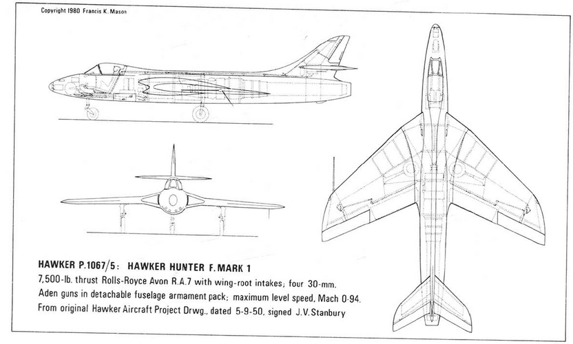

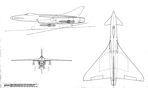

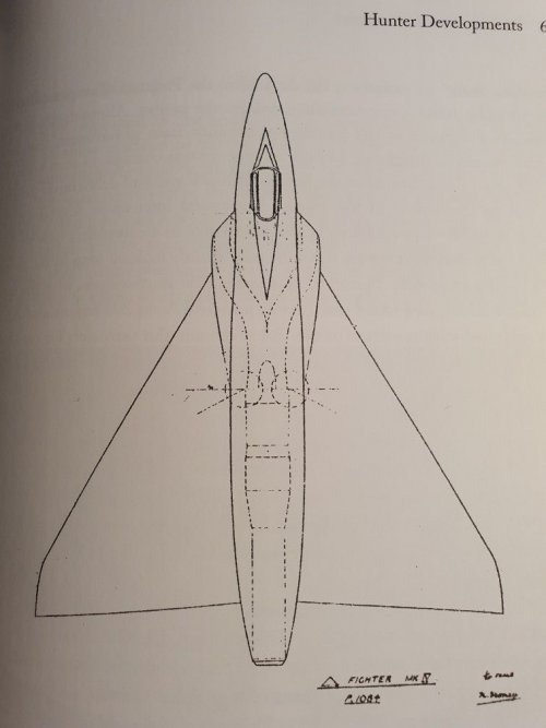

Are there any published dimensions for the P.1091 Delta Hunter?
I've got a 3 view drawing of the delta P.1092 which has a scale bar and gives an overall length of 55ft 0inches but can't find anything on a P.1091. Were they related enough to compare the drawings and figure out the P.1091?
P.1191
F.3/48 Hunter with 60° delta wing, one reheated 8,000lb (35.6kN) Sapphire 4, four 30mm Aden cannon, 15.10.51. Max. speed Mach 0.98, span 33ft (10.Im), length 41.92ft (12.8m), wing area 510ft (47.4m). Study undertaken with Avro (presumably to use the sister company's delta experience).
Source: Tony Buttler, British Jet Fighters Since 1950
now that is very different, the canard is a new one to me :) is there a P. number or date for the drawing, or any noted dimensions
cheers, Joe
It was on P.10 of my P.1121 book :) Its a Ralph Hooper sketch from 1953 according to some text on the original drawing I just noticed. It went no further than that, no P. number I know of. Ralph couldn't remember it, so it didn't make much impression even on the person who drew it :)
It was in the Hendon collection, and appears to have been marked up use for a brochure by whiting out all the details.

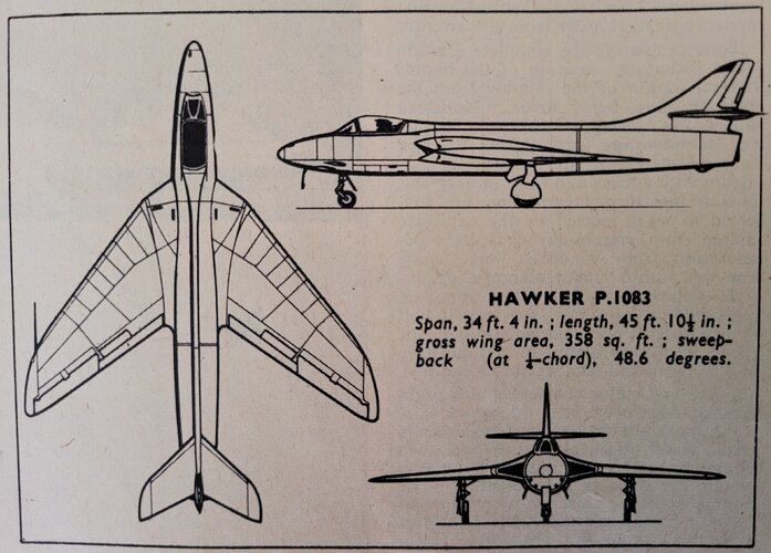

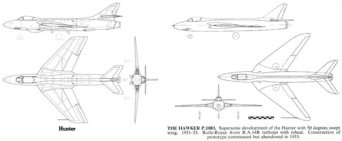

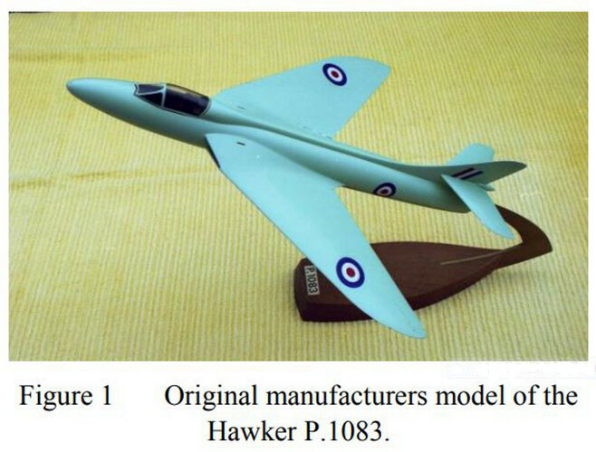

Interesting, I never knew that the P.1083 had been in the beginning processes of construction. Are there any photos of it? What was constructed, and what percentage of it was completed?

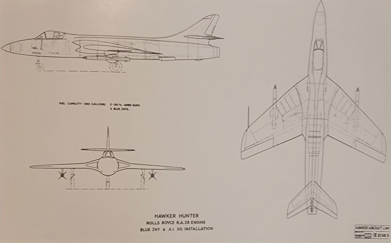

Does the Hunters have already been tested with Red Top or Firestreak ?
Yes. Work on Hunters armed with Blue Jay (later Firestreak) missiles began in 1953. Originally, four missiles per aircraft were planned. That was later reduced to twin, underwing Blue Jays and a nose-mounted AI.20 radar. The aerodynamic testbed for the radar nose was Hunter WW594 (aka P.1109A).
Hunter XF378 (P.1109B) had a functioning AI.20 set as well as other changes. To accommodate the weight and forward fuselage reshaping dictated by the search radar, two of the ADEN guns were deleted (along with the 'Sabrinas'). The wing leading-edge 'saw tooths' were also removed. Successful live-firing trials were conducted in 1957 but no orders for Firestreak-armed Hunters followed.
Hunter F.4 XF310 was also converted to P.1109B standards. It was declare surplus to requirements in 1958 and Hawkers converted it to 2-seat T.7 standard for re-delivery the following year. Red Top didn't enter service until 1964.

Does anyone have the performance for the P.1083 as built with the Avon RA.7R? All the sources I have found show the performance for the production version with the RA.29, which was never built.
