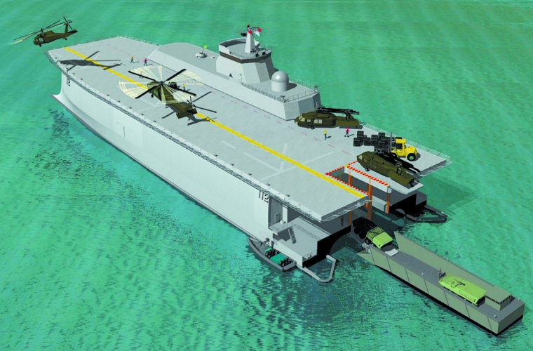

It would seem small carriers like this would be ideal platforms for UAV's & drones. They could have the additional equipment for control of various unmanned platforms. (Something like Turkey is doing with one of its amphibious ships)

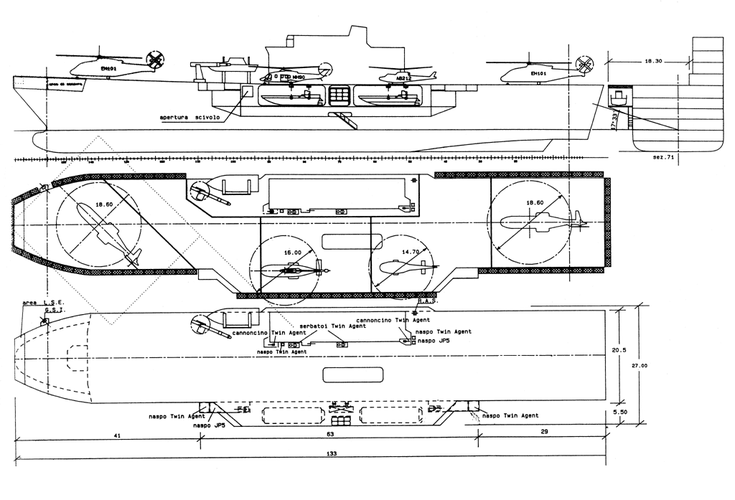

That doesn't seem to have an elevator big enough to get an F35 belowdecks (and maybe not enough vertical clearance in the hangar even if the elevator was 16.5x12m), but you could probably stow 6 on the deck and still have space at the bow and stern to operate helicopters.

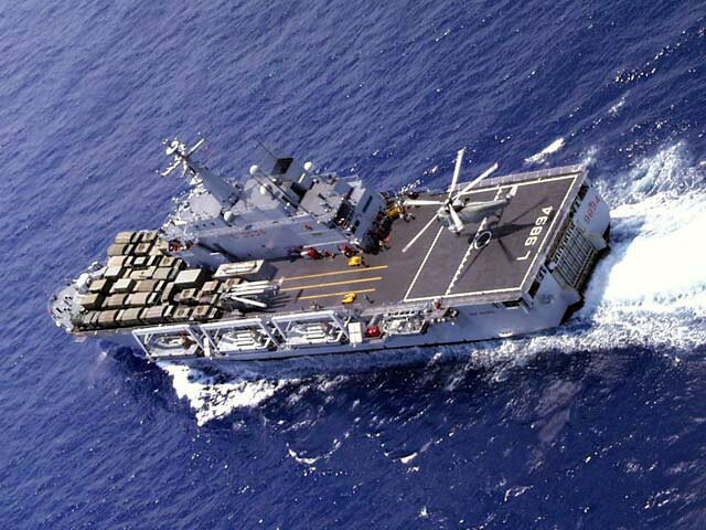

Thera are no elevators for Helicopters in Santi Ships. The deck is only for the landing forces, and the helicopters could not be recovered, but stay always on the bridge.
I assumed that the narrow rectangle with rounded corners amidships on the flight deck and other deck image was some kind of elevator.
Yes, is an elevator, but only for terrain vehicles, that will be carried on the bridge.

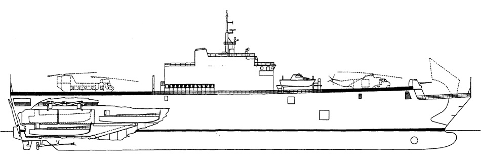

When appeared for the first time in 1988 everyone in Italy was thinking about such ships as "small carriers" a smart way for Italian Navy to increase the number of harrier carriers after the Garibaldi (considering that Garibaldi was left alone without a sister ship).
The flat deck and the island look misleaded all about such point.
In reality, giving a close look to the project, the Santi Class were intended by since as pure helicopter assault ships.

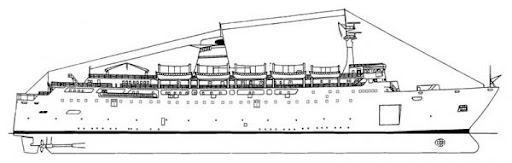

The Santi Class hull was derived by the civilian Poeta Class shuttles (Boccaccio, Carducci, Pascoli, Leopardi, Petrarca, Manzoni, Deledda and Verga) launched in 1969-78 timeframe.
The Santi Class were Poeta modified with flight deck, island, and armament but they essentially remained modified shuttles so unsuitable to be real aircraft carriers, like the Garibaldi and the later Cavour, designed by since to be real aircraft carriers.
The Santi Class represented an high value asset for the Italian Navy giving, for the first time, an entire fleet of LHD with rapid deployment force of San Marco batallion and the possibility to operate as helicopter carriers.
Last but not least the look of small carriers like American counterpart helped to solve some thorny situations over the years.
But all the initial limitation given by their civilian ascendence remained in place.
That's why the new Trieste is so important: like the Garibaldi such ship represent the very first one conceived to operate as LHD (with large floodable basin inside) AND to operate as a real aircraft carrier with its complement of F-35B.

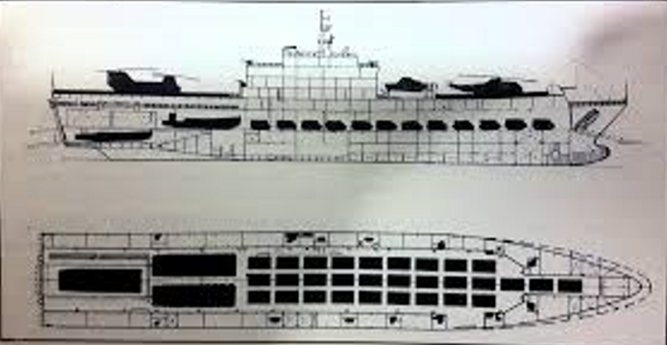

The Poeta Claass was conceived to connect both Sicily and Sardinia with mainland, all the ships had a back ramp and tiltable nose to imbark/disemark cars and trucks. Such feature appealed Navy officers and designers since was perfect to host all the military vehicles.
The main modifications were the rear basin for the 3 landing ships, and the flight deck with island instead of the shuttle's upper bridges.
