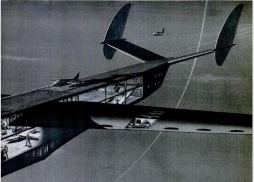

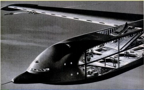

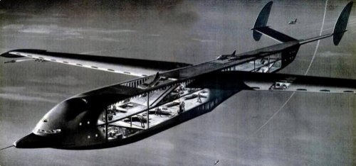

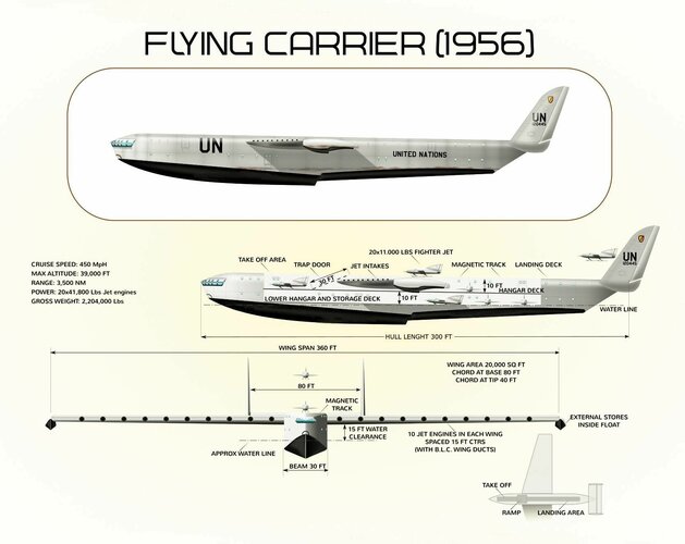

Here's the Loening flying aircraft carrier, found in aero, 1954 :
Some of the given data : MTOW around 1000 ts, length about 100 m,
speed 650 to 850 km/h, chord at the wingroot 24m, at the tip 12m,
wing area 1800 sqm, 20 engines. Estimated costs in 1954: 110 million $
(against 160 million for the Forrestal)

whaadya know! its got those mean little seaplane jetfighters/ jet submersibles that the combat reform folks are obsessed with ....
".. jet submersibles"
But they were intended to be launched at a height of 12.000 m ...
there are some who could care less as long as the designs look straight out of an old Johhny Quest show
That monster would have operated the same airwing as a Forrestal?: Phantom II, Skyhawk, Tracker!!!?. I have seen SES carriers which were found difficult to operate aircraft from its decks when the ship operating at high speed in the sea. What about an aircraft flying at 12000 m high and 600 Km/h? :-[
seriously those renditions remind me of the convair sea dart ... hey Jem anything about tendering to sea plane jetfighters?
"What about an aircraft flying at 12000 m high and 600 Km/h?"
Opening the hangar and bringing the aircraft up to the take-off are points, that
are remarked as "still problematic" ;D Maybe the "magnetic track" should do
the trick ?
Type of aircraft isn't mentioned, just a complement of "20fighters of 5400 kg each"
which perhaps would allow something like a Sea Dart.

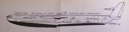

I’ve tried to complete the sideview to a 3-view, not too difficult, nevertheless not
to be taken too seriously, as probably the whole project wasn’t too seriously, too.
Span, wingchord at the root and tips and span of the tailplane was given in the article.
Although all those data were given with an accuracy of two decimals, I’m pretty sure
that this has is origin just in transforming all dimensions from feet into metres, not in
a very detailed design. Fuselage width is uncertain, as is the position and form of the
engine exhausts, but it is stated in the article, that for enhancing lift, blown flaps would
have been used, as well as blowing the exhaust gas over the wing surface. So a position
quite forward on the wing seemed logical to me.
Source grading 2 at best.

A great drawing by zeroc:

Maybe the whole point was never to launch aircraft while flying.. but only when a float and operating like any other seaborne carrier. But ( suspend reality here ) once all craft are below deck, the whole carrier could take off and fly! It could relocate quicker than any other type of Navy carrier? So ground effect may be all it did, but even that would have been something to see. Apologies, but just speculating.
I am not so sure, Zeppelin. I think the key to understanding the intended use was the mention of the "magnetic track." Was this some sort of magnetic conveyor built that would have held a landing aircraft firmly to the "deck" until switched off for takeoff, moved it around the "ramp," and also pulled and held it down on landing? If so, I can definitely see this working even in the air. There are even some advantages--high altitude air can be bumpy but it's easier and quicker to fly somewhere else than to escape a rough sea. Relative speed between the carrier and the fighters could have been almost nil since the carrier's operational speed would presumably be above the stall speed of the plane. The real question is endurance--how long could something like this actually stay on station?
Not sure I'd fancy piloting the aircraft 'landing on' if the carrier was airborne at the time. Think about the flow field around the tailplane...
Oh- I was about to post my drawing here but I see Grey has done the job for me! Thank you, hope you like it! ;)
Your work is fascinating. I love your art and the way you bring it to life.
Bravo!
Antonio
