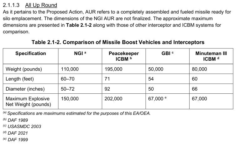

Unless they've gone mobile, which I certainly wouldn't object to.Since this will be a replacement for the GBI missile I assume the NGI missile Will have the same exterior dimensions so that it can fit into the GBI launch silos?
I expect it to use the same silos, though isn't GBI hot launched so the silo is a lot bigger than the missile itself?Since this will be a replacement for the GBI missile I assume the NGI missile Will have the same exterior dimensions so that it can fit into the GBI launch silos?

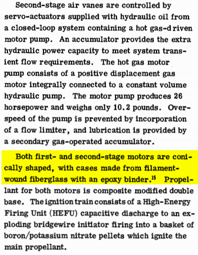

They've been using them in missiles since the 60s.Still getting used to composite SRM stages becoming mainstream.

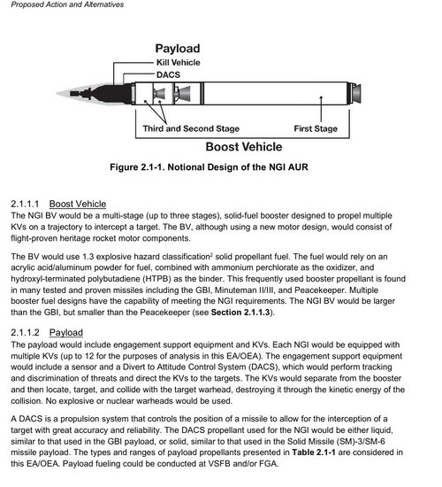

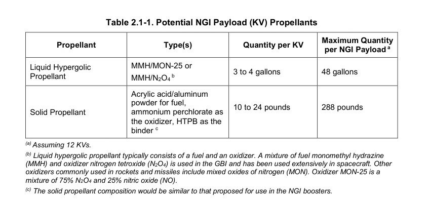

@thustwr.bsky.social said:Seems like MDA environmental assessment report on NGI deployment/testing at Vandenberg and Fort Greely is out: www.mda.mil/system/NGI/ deeper look at current maximum assessments for the system include 12 KVs per missile (vs 1 on GBI), and a much taller/heavier design (at minimum).

..designed to propel multiple KVs..
...up to 12...
