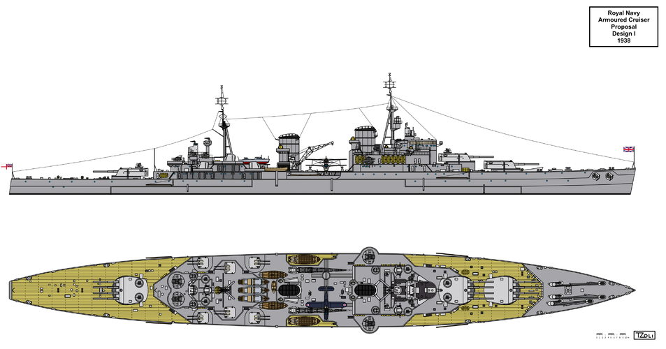

I suspect the Dido connection might arise from a [Christmas IIRC] Own Designs competition on Shipbucket, for which I was asked to set a target. I noted that Lillicrap, head of cruiser design, was seconded to produce capital ship designs for discussion at Geneva in 1936, The data available was that in the above table. I thought it a good target, because (a) there were NO DRAWINGS by Lillicrap, but his experience with cruisers would provide hints to stimulate competitors imagination.
There is no other connection between Lillicrap's designs in columns a and b and the other columns cdfgh which are RN studies from 1938 onwards. The basis of the study for Greece in column e is set out in the last two paragraphs, especially the 1936 London Treaty prohibiting 'cruisers' between 8000 and 17500 tons.
Kingpin6100 said "let my clarify: while that's where the data is from, I was wondering where the the table itself was from, as it appears to be from a book"
If you know which book, and if you have read its introduction which explains the rather condensed layout of the tables, you can find where I found the original information. For example, the references at the foot of each column are to the workbooks of Constructors Lillicrap and Johns. The background to the Greek request is from ADM116/4200. The design study for Greece was in Johns workbook, not Lillicrap's. My book was entitled "A Directory of British Cruiser Designs" so it was important to direct readers to where the information came from, and so where to check it or to find more detail (if any).
That all this data is in the same table was simply to allow easy comparison of a set of roughly comparable designs all from the mid to late 1930s.
Other tables were restricted to a single design and its various versions produced before the final design.
My whole book attempted to cram as much information as possible on to as few pages as possible, to keep costs down, with the original intention of 'print on demand'. Keele University was set up to do that, but the University authorities decided at the last minute not to extend that facility outside University departments.
Reading this post made me understand why your book 'a Directory of British cruiser designs' was not available for a long time. It doesn't fit the nature of this forum, but I'd like to politely ask you to purchase your book. In the meantime, I've been wanting to buy your book, but I couldn't find it at all. After seeing your post, I hesitated for a long time, and then I gathered up the courage to write this post. I hope that you will allow me the joy of reading your book, even if it is very cumbersome.
Kingpin6100 also asked "Erm...erm....erm...Did you actually read what you quoted???" a question with which I have some sympathy.
I find Tzoli a bit imaginative with his comments, and a somewhat cavalier with proper reference to others' work. It was well through this post before he mentioned Smurf, and I was a bit surprised that he thought I was not sending him my own work and that the table might be from the American "Warships International"
His first post said
"Greek Large Cruiser proposal from DNC. This warship is based on the Dido but on an enlarged hull."
It wasn't.
What he meant was "I have based my guess at this warship on the Dido"
Enough said, I think.

Well Sorry to disturb u but I have questionHere is my new drawing with much more accurate information:
DNC Design for Greece by Tzoli on DeviantArt
www.deviantart.com
The designs had these characteristics:
Dimensions: 205,74m(pp) x 23,16m x 7,31m
Displacement: 18.550tons (Standard)
Engines: 140.000shp Parsons Steam Turbines, 4 shafts
Speed: 61km/h (33knots)
Range: Unknown, likely 18.500km at 28km/h (10000nm at 15knots)
Armour: 76mm over machinery, 102mm over magazines Deck, 229mm over magazines, 203mm over machinery Belt
Armaments:
3x2 10"/50 (254mm/50) BL Mk VIII Cannons
6x2 4"/45 (102mm/45) QF Mk XVI DP-AA Guns
6x4 40mm/39 QF Mark VIII Pom-Pom AA Guns
4x4 12,7mm/60 MG Mk III AA Guns
2x Floatplanes
