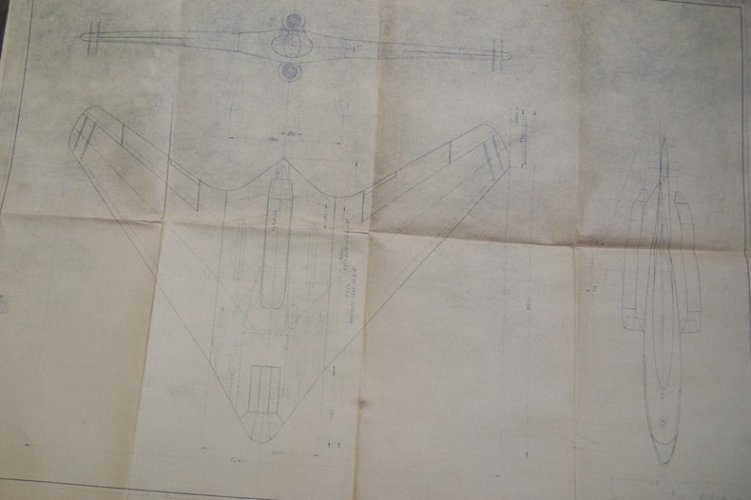

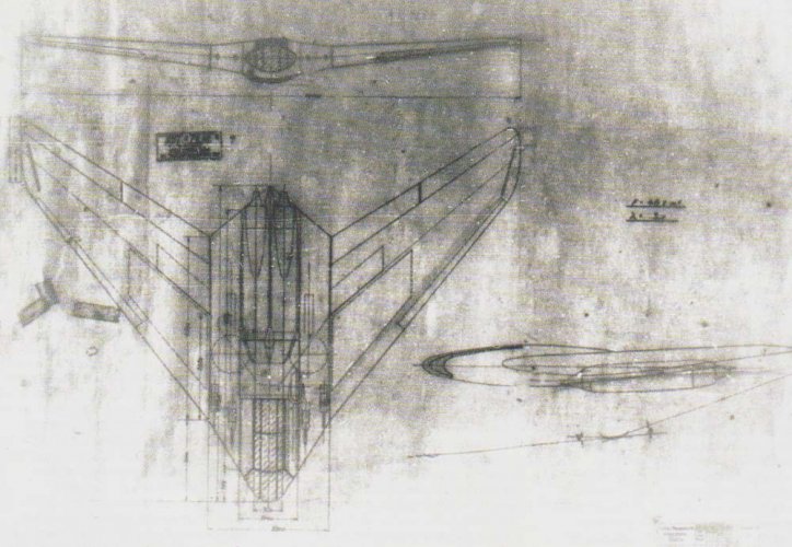

Here's something interesting - to me at least. It appears to be the Gotha P-60 A but... it's different. The wings appear to have a slight dihedral, the glazed panelling above the crew is longer, the point at which the wings meet the centre section is sharp rather than curved, the main undercarriage wheels tuck up further forward. And... it could be the appalling quality of the image but I don't see the characteristic above-and-below engine installations. Could the engines be recessed right into the fuselage with just lip inlets? Or am I seeing things?

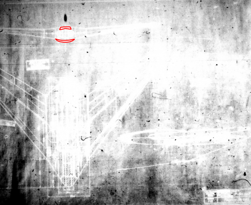

Bit of photoshop, it looks like there are two engines or some other bulge just off the center line near the rear

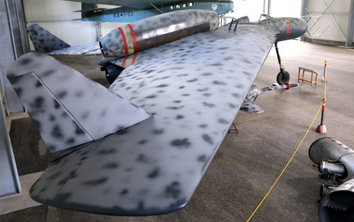

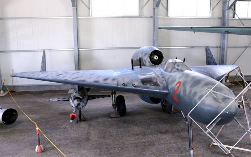

Holger Bull made this replica mock-up of the Gotha Go P.60C for the Aircraft Museum Rechlin.
Links (German):
http://www.klassiker-der-luftfahrt.de/luftfahrtmuseum/gotha-go-p-60c-enthuellt/732646
http://www.luftfahrttechnisches-museum-rechlin.de/aktuelles.html
http://www.mueritzportal.de/news/nachtjaeger-gotha-go-p-60c.html
Very interesting! I have to visit it (it´s just two hours by car...). Does anybody know what the two "things" under the wings are? Guided weapons, drop tanks...? ???

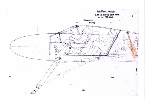

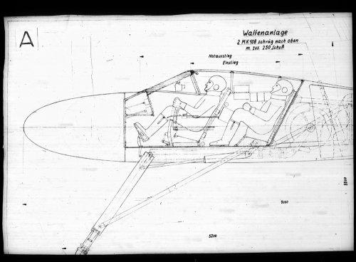

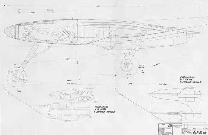

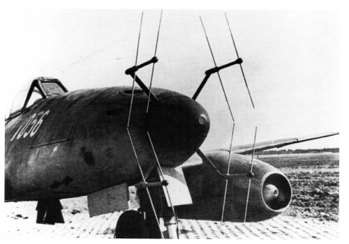

It can be appreciated in the original drawings that the Mk 108 cannons installed in the wing are invisible from outside and that the barrels of the Mk 108 ‘Schräge Musik’ are barely protruding.
The tips of the dipoles of the FuG 218 ‘Neptun’ array are not in contact with each other and the reflector dipoles are longer than the emitter dipoles.
The Fa P-1 is a rammer designed for day fighting against the B-17 and B-24. During the night, the S.O. pilot could not see the target. It is not the proper armament for a night fighter

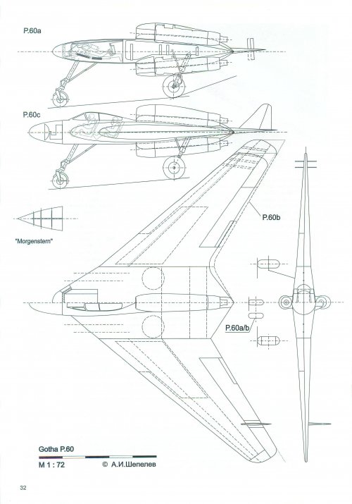

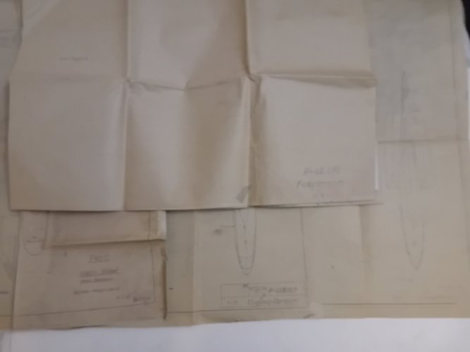

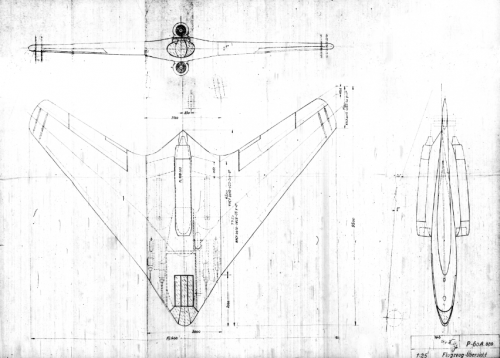

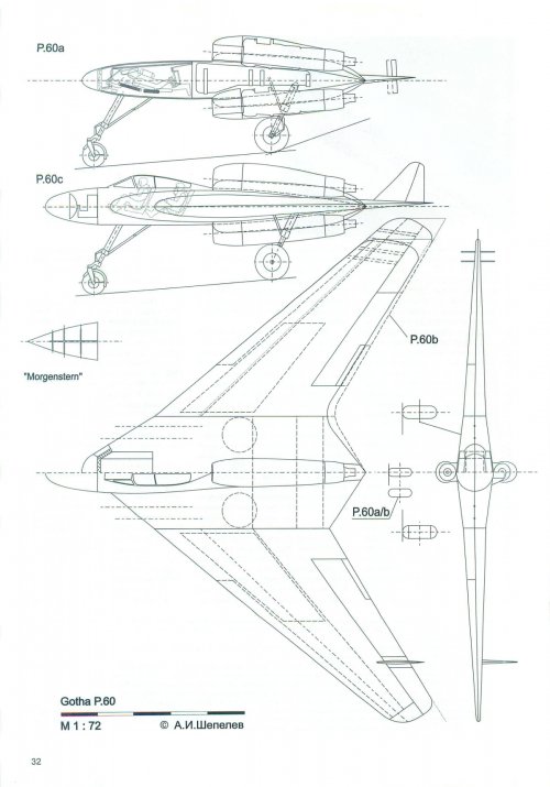

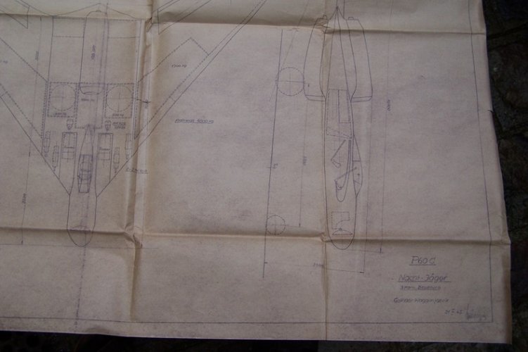

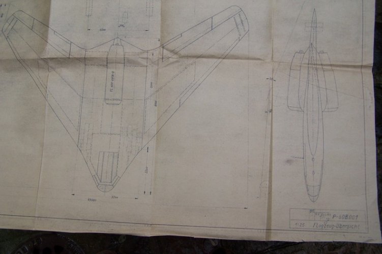

All of the designs show the front landing gear offset to the side (moving it away from the intake).
Something is bothering me about the P.60A-2: All of the drawings show the front landing gear unmoved... however it would be in front of one of the air-intakes?!
Is this correct? What do the original drawings look like?
There was no A-2. The different version of the Gotha P-60 are:
P-60 A mit BMW 003
P-60 A mit HeS 011
P-60 B mit HeS 011
P-60 B mit HeS 011 und R-Gerat
P-60 C mit HeS 011
P-60 C mit HeS 011 und R-Gerat
P-60 C mit HeS 011 (three-seater)
P-60.007
The real life design that's closest to the 'A-2' is the P-60.007 and the original drawing for this clearly shows the nosewheel offset to port.

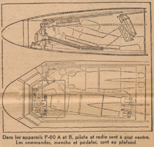

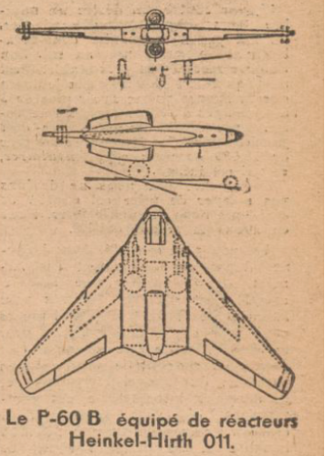

From Ailes 4/1946.
