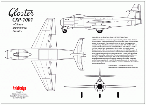

I do not often promote my own work on this site (as it is mostly made up of fictional/imaginary material) but this particular work will probably be of interest to some, at least I hope so. Since I wasn't satisfied with the various profiles and 3-view plans of the CXP-1001 at my disposal (most of which differed widely — and wildly — especially as far as the wing length was concerned), I decided to do one myself. I do not claim it to be perfect nor absolutely similar to the actual mock-up, of which no photo ever surfaced. I tried my best to make it coherent, using an old and very basic three-view as a reference point and adding to it from various sources. The panelling of the Sharkit model served as an inspiration, and the nose gear was snatched from a Meteor T.7, with a two-part hatch (many depictions show a single panel hatch, so I admit this was a matter of personal choice here as to which one seemed the most likely). Needless to say, I welcome any criticism, constructive remarks and suggestions.

That's great work always frustrating trying to make sense from varying information. Nice to see something akin to all the formation being put forward here promote your work as much as you desire as far as I am concerned.

Thanks archipeppe!! B)
