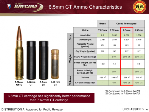

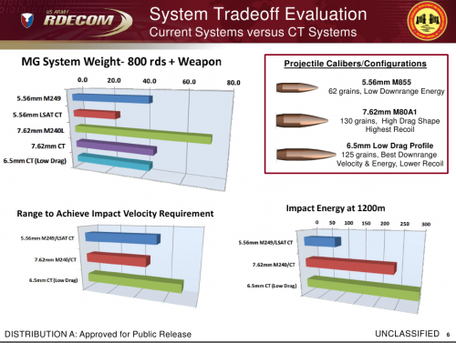

On that last one, I really don't understand the logic of the caliber choice: "The 123 grain 6.5mm has a muzzle velocity of about 3,000 feet per second, Cole said." That's 2,458 ft-lb so almost identical to 7.62x51mm NATO (147 gr M80 FMJ X 2,733 fps = 2,437 ft-lb). What's he point of a "carbine" in a full-power rifle cartridge in this day and age? Are going back to the M-14 and FN FAL? Wasn't the whole point of the move to assault rifles (intermediate calibers) to get away from this?

It's about retained energy downrange. (from Ms. Kori Phillips' Armaments 2016 preso which is attached)

Thanks, marauder2048, and I can buy the rationale for an LMG or GPMG application, but. nobody is hitting anything with a carbine at 1200m, even 600m would be rare and exceptional.
This lightweight ammunition study/Development is still very much a work in progress, they're running down the various options. A lightweight carbine that sacrifices control/accuracy at full auto for long-range engagement ability normally only found on heavier sniper/DMR rifles may not be worth it in the end, but I have no problem with them building a few and finding out how it goes.
