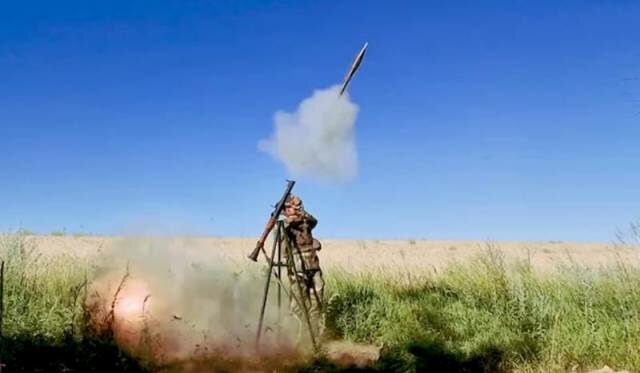

And? Tactics are the least statistical element of war. The chance of hitting someone with a machine gun is "basically zero" at 600 yards, let alone indirectly, yet people still shoot, because the point is to let your guys close to kill the other people in their trench, obviously. The machine gun keeps people in place, might kill someone (which is good), and keeps the other guys' heads down. All good things for trench sweepers with hand grenades, flamethrowers, and satchel charges.
It will hit the ground or bunker, throw some dirt and rocks around, maybe kill a guy. Good. It beats the "literally nothing" alternative, you have more rounds your mortars can shoot anyway, and it's harder to attack an RPG team firing mortar rounds at you than it is to attack the guys with a Podnos. Easier to aim, too, and being able to hit a dugout full of dudes on the inside with a O832 is really dope for an assault team.
It's not like people haven't turned disposable launchers and 66mm rockets into impromptu indirect fire units before anyway. South Africa tried to sell it to people in the '80's as this very forum has documented.

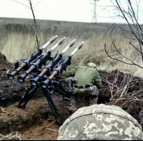

Here is a Ukrainian special operations assault team doing the same thing as the DPR troops:
View: https://twitter.com/Osinttechnical/status/1549156606050443265
They don't even have T&E gear, but they're a special forces detachment, so they probably want to be mobile. Here is a Ukrainian trench mortar devised from a pair of RPG-7s and some T&E kit:
It's similar to but probably heavier than the LDPR/DPR system.
So what of this "wreaks" of desperation? These are not slap-dash modifications, obviously, even if they are field-expedient. They are very serious, prescribed fabrications of weapons that the Red Army trained all its soldiers in, and went on to train anti-capitalist guerrillas in the jungle and desert to do the same, both in their use and similar modification.
It's much lighter than a conventional 82mm mortar, with a significant range out to around 3 kilometers. Actual mortar projectors are a scarce resource, yet this is true like every resource, and conservation of resources is the name of the game. The Soviets made more O-832s than the world could handle and both Ukraine and Russia are obviously going to take advantage of this.
Tanks are a uncommon beast in Ukraine. Thus, the rocket launchers end up being distributed poorly, with too many in small units, and insufficient anti-personnel indirect fire, because the past several decades have been spent stockpiling anti-armor means. Yet the most common military forces who have fought all P5 powers have been light infantry. It's very much a "last war" (WW2) mindset but without exaggeration.
Practically the only things that can be said to be found "in abundance" in the Ukraine theater is RPGs and mortar ammunition.
By creation of multiple rocket launchers on the frames of grenade projectors, the infantry unit increases its anti-personnel fire capacities by several times, with each tube being essentially a mortar, and preserves mortars for more important tasks such as stockpiling resources for the next push to the next set of trenches. In which the process repeats itself.
It's quite literally the opposite of desperation because it shows both sides are still willing to kill the enemy, and go to relatively high levels of effort (but absolutely very low levels) to do this. Desperate troops do not preserve themselves. Defeated troops do not fight back. This is neither. These are troops who are in a bad way finding creative solutions out of the way by improvization in the manner of their grandfathers.

The accuracy is adequate, but if you think it "wreaks of desperation" perhaps you should consider that Ukraine does it a lot more than the Russian levy troops? The rocket projector RPG-7 firing PG-7V has a dispersion of a little less than 10 meters at 1 kilometer, although stuff like high crosswinds will affect this, and the travel of a high angle fire will be slightly more than 1 kilometer. Regardless, it's quite accurate as a piece of recoilless rocket artillery out to around 2-3 kilometers, provided you've sited the position properly, and you're getting accurate range to target. You can attack a platoon or squad DFP with consistent casualty production radii of between 5-10 meters with the PG-7V/-VL. Double that for the 82mm HE.
All that assumes accurate positioning and gun laying, which is the only real telling issue for short range artillery in the modern age. A couple of kilometers won't meaningfully impact accuracy unless you're firing something like a, S-5.
Lateral dispersion might be a few meters higher, and the balance will be off somewhat (which will affect range dispersion), using the O-832 shell instead of the PG-7V. That might explain why the DPR troops were firing PG-7Vs instead of the field produced O-832 rounds that the Ukrainians have photos of, but the Ukrainians use this a lot more than either Russian or DPR/LDPR troops to begin with, so yeah that might explain it too.
If you find this to be questionable, that speaks more to your ignorance of what Soviet-trained troops consider fairly basic field knowledge tbh. I don't know what your experience is or whatever, so I won't really judge, but I will just say that your doubt about this technique is pretty unfounded in the real world. People do it all the time and have won wars this way against much more powerful armies than those in Ukraine or Russia.
The weird part is using the O-832, but I guess if you can lose 2-5 meters of accuracy, you technically gain another 3 or 4 meters of killing area. Except that's not really how it works, but soldiers will do weird shit all the time based on myths rather than sound facts, as tactics being the least statistical element of military art is informed more by individual biases and experience than true understanding. It's not very important to have true understanding outside of some common fundamentals.
Which is to say if it's stupid and it works, it isn't stupid. Nor does it "wreak" of desperation.

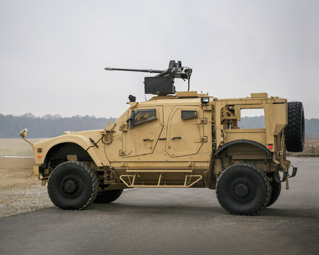

Seems a weapon like this mounted on a light vehicle, not a Bradley which were not in any of these columns probably road/terrain limited, would be cheaper/quicker than an air strike.
JLTVs are already getting PABM rounds for the M230LF. The Mk44 would probably do to JLTV what the M242 did to Humvee.
Then again the Russians have been able to put 2A72 on the Typhoon 4x4 so anything's possible.
