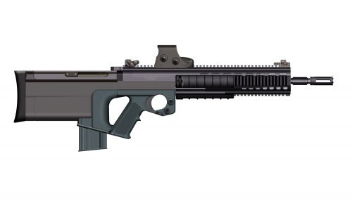

Hey Racer I'd like to see the design you're talking about. I am not a proponent of caseless anytime soon. I feel that as long as bad folks will be using AK-47's then the good folk will need robust and simple guns. Specialized rolls may allow for fancier stuff (i.e. a Javelin is not as simple as a RPG but people carry them anyway) but the regular joe's get the regular kit. I think lighter and smaller with the same capability of modern weapons or the same size and weight of modern weapons with more capability and power are the way to go. I think cased weapons will last into the next century. The materials may change but the operation will remain consistent with what we have today. I just like indulging in a bit of fantasy from time to time.
My bad. This is the version I was looking to post. It's not finished yet. I need to add the mag release button. All the add on bits I'm doing separately. It's just a bullpup version of the HK 416 mechanism, which I am fond of.

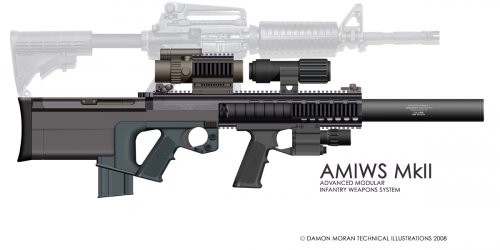

Here it is with all its accouterments. Mag release is of the ambidextrous finger operated variety, just above the multifunction buttons. With rails you could go nuts with the add-ons like laser sights (in the works) and the such.

I tend not to be all that impressed with what we call downunder "Guccified" weapons. Invariably such accoutrements tend to upset the balance of a weapon. About the only useful ones I've seen have been infra-red pointers and grenade launchers. The others tend to tell you more about the owner's personality rather than how actually useful they are. ;D
Well the standard issue would be the top. The lower image is just a list of possible attachments which are optional. Rather than post 5 or 6 images of each part I tacked them all on.
