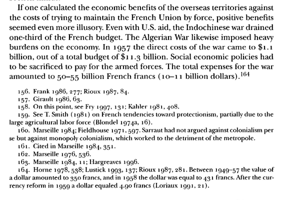

Did France have the money and resources in 1945?
No. So let's take POD as late-1949. NATO Treaty signed, France in, but not yet an operationally meaningful Org.

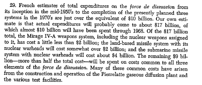

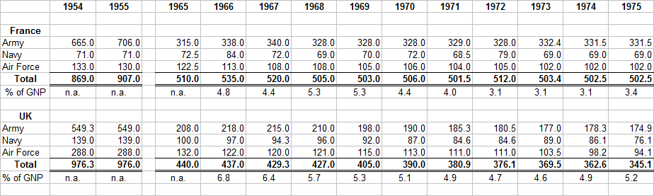

How would this Franco-british deal compare cost wise to the very good deal Britain got with the usa (aperintly smothed over quite a bit by lord Mountbattens personnel relationship with Admiral rickover and president Kennedy in case one wants another pod).
Also what would be more likely, raf mirage IV or force de frappe V bombers ? (maby both?)

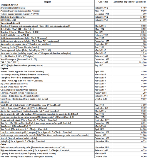

We all know that on the British side, the TSR-2 development and cost was pestered by all kind of others expensive projects: CVA-01; P.1154; AW.681; Polaris; Skybolt; countless others.
Bottom line: a strong political power told the military they could NOT bickering and delay the Mirage IVA with any side expensive projects. That was clear from 1958 and De Gaulle return to power.

Now, look at the attached picture. I put Wikipedia tables side by side. And guess what ? Resolution and Redoutable development milestones are remarquably similar - until 1966 at least. For some unknown reasons it took the French four more years to finish their boat and shakedown-cruise it. Probably the lack of Valiant SSN experience beforehand, also the lack of Uncle Sam help.
Updated the picture to put Resolution and Redoutable milestones side by side. Well, all I can say is that their respective milestones were astonishingly close. It's almost unbelievable !
On both sides of the channel the Redoutable and Resolution shipyards builders were - unknowingly ! - racing each others. The French resisted until 1966 then completely dropped off behind.
I'm left wondering whether it wasn't a ploy by De Gaulle to (as usual) screw the anglo-americans he loathed.

I wonder if anyone has done any analysis on the R&D money spent on HTP motors, ramjets and other rockets?
This is the best that I can do.
Any similarity between this and Post 71 on Page 4 of the thread "British Cold War: Facts and Figures" on alternatehistory.com by someone with the username NOMISYRRUC is completely deliberate.
Source: The Flight Global Archive - Aviation History19671967 - 1672.PDF
https://www.flightglobal.com/pdfarchive/view/1967/1967 - 1672.html
Notes:
  1. Square brackets contain the equivalent description from Appendix 5 of Project Cancelled by Derek Wood.
  2. There are some discrepancies between Wood's list and Flight's list, which are noted.
  3. Wood included the cancellation costs of the Vickers variable geometry projects (£1.5 million) and the cost of the Bristol 188 supersonic aircraft (£20.5 million), but the Flight article omits them.
  4. Wood said that £0.9 million was spent on the Vickers Red Dean, while the Flight article says £7.5 million. If he obtained the information from the Flight article he may have been reading the line above, which was an "Air-to-ship guided bomb" cancelled in March 1956 and is not in Wood's Appendix 5.
  5. The "Air-to-ship guided bomb" may be Green Cheese.
This is the table in Post 33 in date of cancellation order.
Any similarity between this and Post 73 on Page 4 of the thread "British Cold War: Facts and Figures" on alternatehistory.com by someone with the username NOMISYRRUC is completely deliberate.

Main problem is France is ruined, the Indochina war ends in July 1954 only for the Algerian one to start in November of the same year, and finally, the 4th Republic is a quagmire without a backbone.
France was at war continuously from September 3, 1939 to March 19, 1962... from my grandfather 30 years to my uncle's 20, and it did no good to their mental healths, really. War is hell.
https://en.wikipedia.org/wiki/First_Indochina_War 20 000 soldiers KIA
https://en.wikipedia.org/wiki/Algerian_War 25 000 KIA
Drats, never realized that Algerian war had led to such losses on the French side. More than Indochina, damn it. Total 45 000 soldiers killed between 1945 and 1962 ! Never thought the toll had been so high, I was leaning toward 10 000 each.
Plus this before
During the course of the war, French military losses totaled 212,000 dead, of whom 92,000 were killed through the end of the campaign of 1940, and 58,000 from 1940 to 1945 in other campaigns, 24,000 lost while serving in the French resistance, and a further 38,000 lost while serving with the German Army
That's near 250 000 killed between 1939 and 1962. Of course that's "peanuts" compared to the 1.3 million killed in 14-18.
Plus the goddam Algerian war proved expensive as frack. 11 billion dollars ??!!!!
Quick search brought a 1968 US intelligence report (NIE) assessing the Force de Frappe cost in billion of dollars: $17 billion. For the sake of comparison, Apollo cost north of $20 billion, perhaps as much as $25 billion.
Bottom line: no surprise De Gaulle wanted to shut down the dirty Algerian bush war and pour the military budget into the FDF instead. Plus NATO committments in conventional weapons... clearly something had to give. Algeria was shut down first, then a bit of NATO in 1966.

I skimmed through the CIA report which was interesting.
This is a table I found looking for something else. It's a comparison of French and UK military personnel. The sources are the Encyclopaedia Britannica Book of the year. There's a gap between 1955 and 1965 because they didn't have the information.
What I was looking for was a note from the same source saying that said France had an army of over 800,000 men in 1958 including 500,000 in Algeria.
Peak US troop strength in Vietnam was 543,482, on 30 April 1969 according to: https://www.vva310.org/vietnam-war-statistics#:~:text=Peak troop strength in Vietnam,country during the Vietnam War.
Part of Post 38
I was wrong. It was actually the Book of the Year 1961 - Events of 1960 and that the French Armed Forces had a total 1,026,000 including 810,000 in the Army and the defence budget was £1,182,500,000. It doesn't say how many troops were serving in Algeria.
Events of 1955 says that 300,000 troops were in Algeria and Morocco.
Events of 1956 says that 400,000 troops were now in North Africa as 200,000 reservists had been called up. It also says that the last troops were withdrawn from Indo-China in April 1956.
Events of 1957 says that 400,000 troops were in Algeria after the 11th Division was moved there from Morocco which left 12,000 in that country.
Events of 1958 doesn't say how many troops were in Algeria, but it does say the garrison of Morocco was reduced from 40,000 to 30,000 and Tunisia from 28,000 to 7,000 with the balance 33,000 going to Algeria. Add that to the 400,000 troops there in 1957 and the total is 433,000.
Events of 1962 says that there were 440,000 French troops in Algeria at the start of 1962 which was to be reduced to 80,000 by mid-1963. It also says that National Service was being reduced from 27 months to 18 months and that the US had offered to sell Polaris to France on the same terms as the UK.
Events of 1964 says that French military personnel was now 636,000 and that nuclear expenditure amounted to 25% of the Defence Budget.
