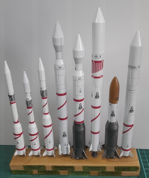

In the meantime I switched for better printers and two months ago I've been asked by a French association to supply them with finished models of the whole range (from the early Veronique of 1950), but at the larger scale of 1:100 (originals are 1:144).
The magic of 3D designing and printing allowed to print these rockets and launchers.

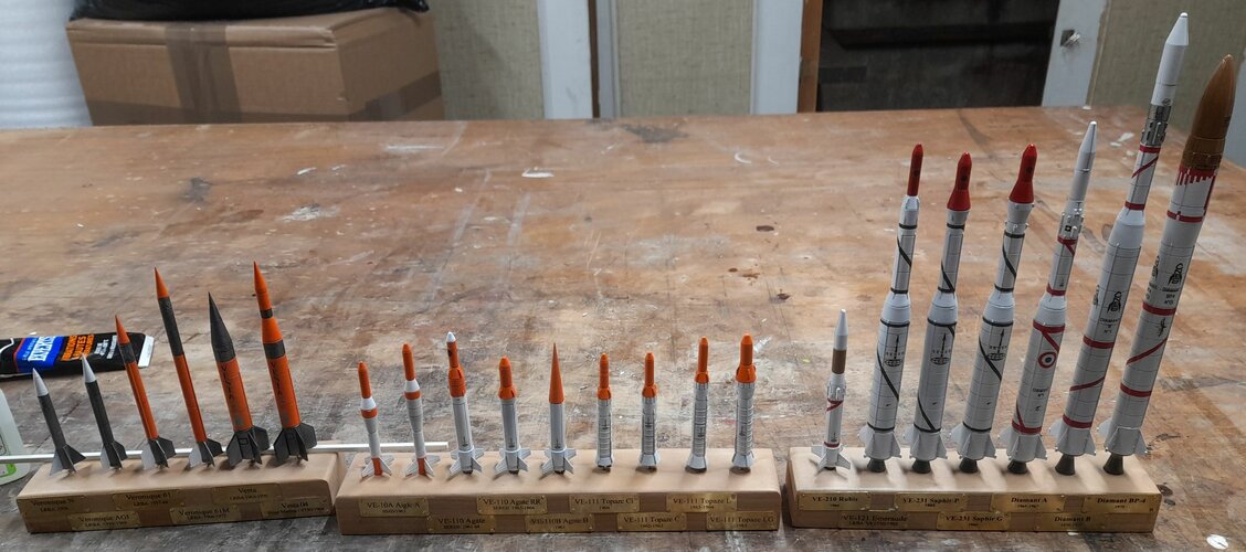

I proceeded chronologically, starting with Veronique and LRBA designed rockets, then SEREB designed solid propellant rockets, then Precious Stone series of test rockets/ space launchers.

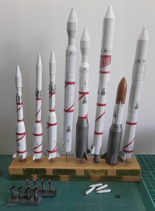

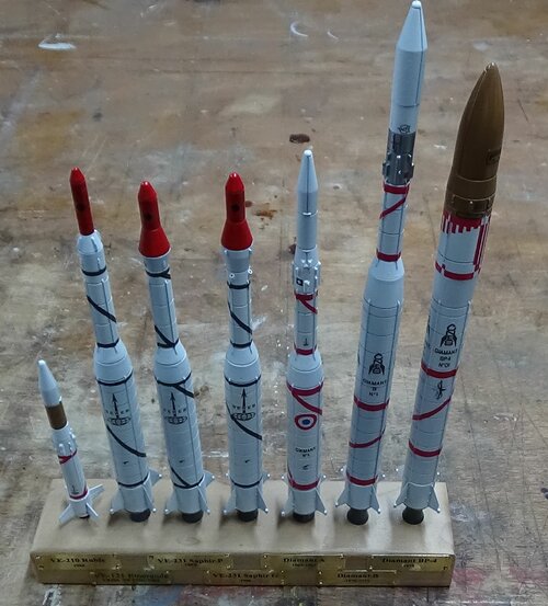

Here is a family portrait:
A portrait of the "Precious Stones":

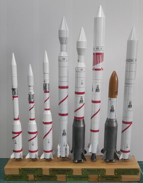

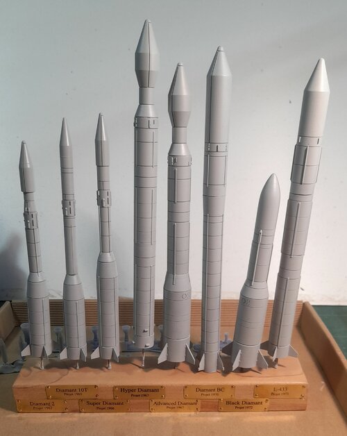

I was then given the "Go Ahead" for the following French launcher projects of 1967-1970, which, of course, never materialized.
First batch is with the so-called "Super Diamant", a range of rockets designed as upgrades of Diamant, replacing original stages with new powder powered ones from the military, some recycling the Coralie second stage of the Europa programme and even a fairing borowed to British Black Arrow programme (Black Diamant)
I readily second the above opinion. Hail 3 D priting and a talented modeler, who lifted all those forgotten rockets out of Flight International - and oblivion.

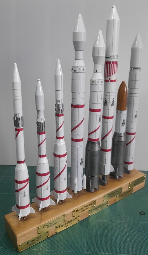

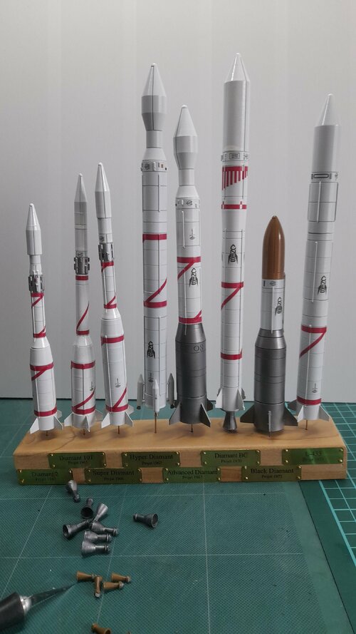

Decals are layered. As these projects never finalized I took some artistic licence, inspired by period liveries:
The, the rockets were given two coats of glossy VMS varnish:

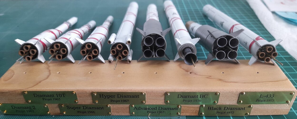

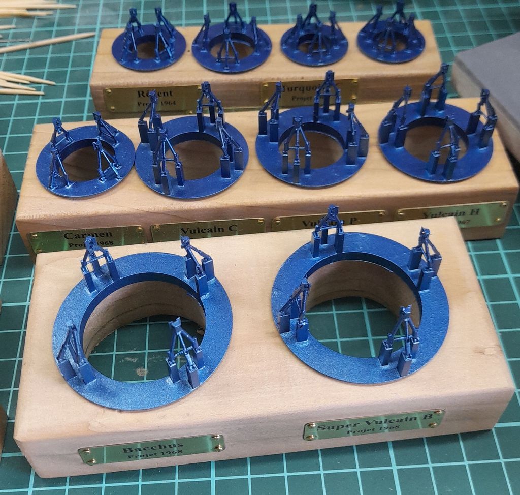

Multiple rocket nozzles are installed:
At last the rockets are secured on their wooden base:

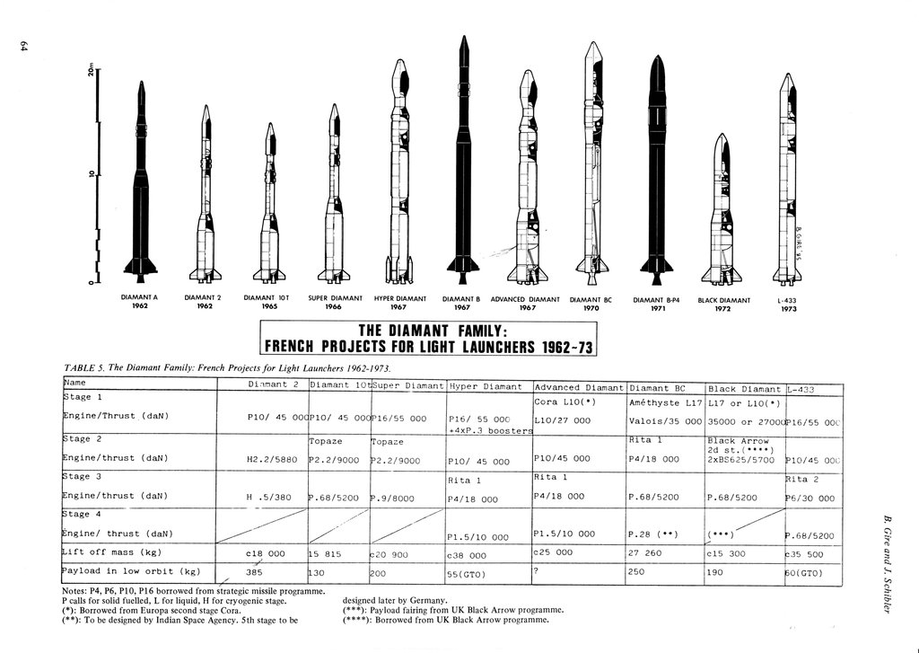

Description of vehicles: In the list below "P" stand for powder powered stage, "L" for liquid powered. P10 is a powder stage with 10tons of propellant.
Diamant 2: based on a military P10 first stage and two «to be designed»
cryogenic stages H2.2 and H0.5. 385kg payload in low orbit. Lift-off weight: 18t. Diamant 10T: a P10, a Topaze second stage and a small P0.68 with a payload of 130kg in low orbit. Lift-off weight: 15.815t. Super Diamant: a new P16 stage, a Topaze and a small P0.9 with a payload of 200kg in low orbit. Lift-off weight: 20.9t. Hyper Diamant: a P16, a P10, a P4 Rita 1 (from the ICBM programme) and a P1.5 to send 55kg in geostationnary orbit. Lift-off weight: 38t. Advanced Diamant: an L10 (Coralie), a P10, a P4 Rita 1 and a P1.5. Lift-off weight: 25t. Diamant BC: this was the natural follow-on of Diamant B before being cancelled for lack of funds and replaced with Diamant BP4: An L17 Améthyste, a P4 Rita 1, a P0.68 and a P0.28 to carry 250kg in low orbit. Lift-off weight: 127.26t. Black Diamant: a curious design with a L10 Coralie first stage, a second stage from the British Black Arrow programme and a P0.68 housed in a Black Arrow fairing (the very one to be used aboard Diamant BP4) to lift 190kg in low orbit. Lift-off weight: 15.3t. L433: a full solid propellant launcher: a P16, a P10, a P6 Rita 2 and a P0.68 to carry 60kg in geostationnary orbit. Lift-off weight: 35.5t.

Very impressive and convincing! Reminds me the company-produced presentation models, intended to high-ranked decision makers. Nice composition of plastic, paint, wood and metal.Keep up a good work!
Between @bgire and @Radium respective works, those weeks I feel like a spoiled kid on Christmas day, in a chocolate shop... kudos to you, you are doing justice to all too forgotten 1960's France aerospace ambitions.
Thanks, guys, for your support.

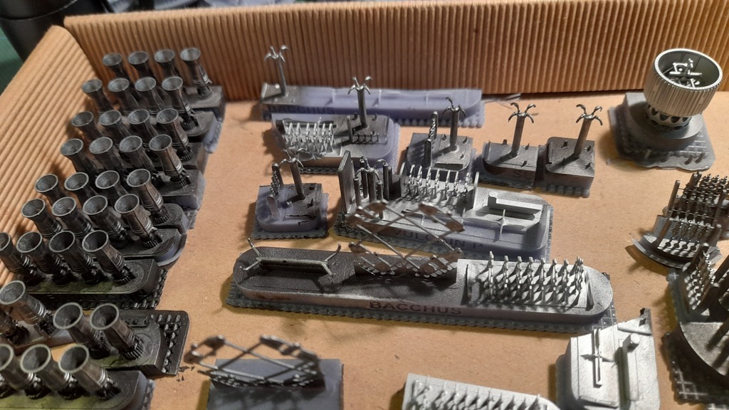

Aside this 1:100 scale production for a customer, I'm now pursuing design, printing and assembly of the same range for me at 1:144 scale.
Time, now to concentrate on the larger 1966-1968 projects.

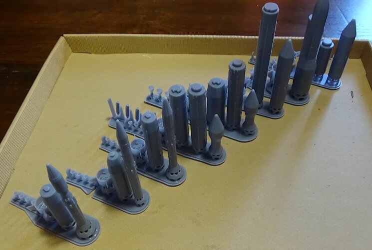

First the numerous SEREB designed projects, based on multiple combination of existing or about to be developped solid fueled stages:

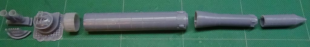

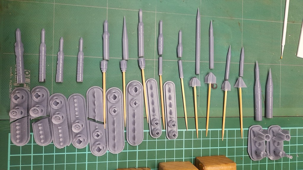

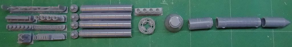

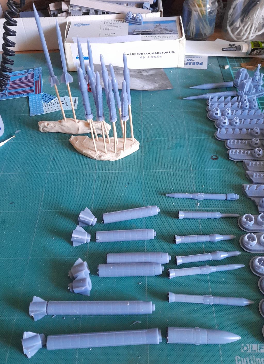

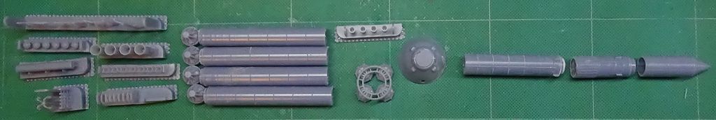

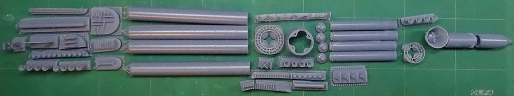

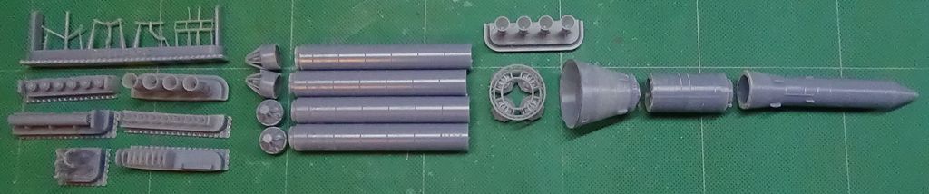

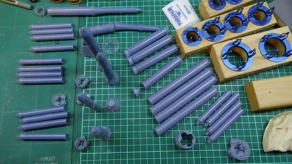

The printed parts at 1:144:

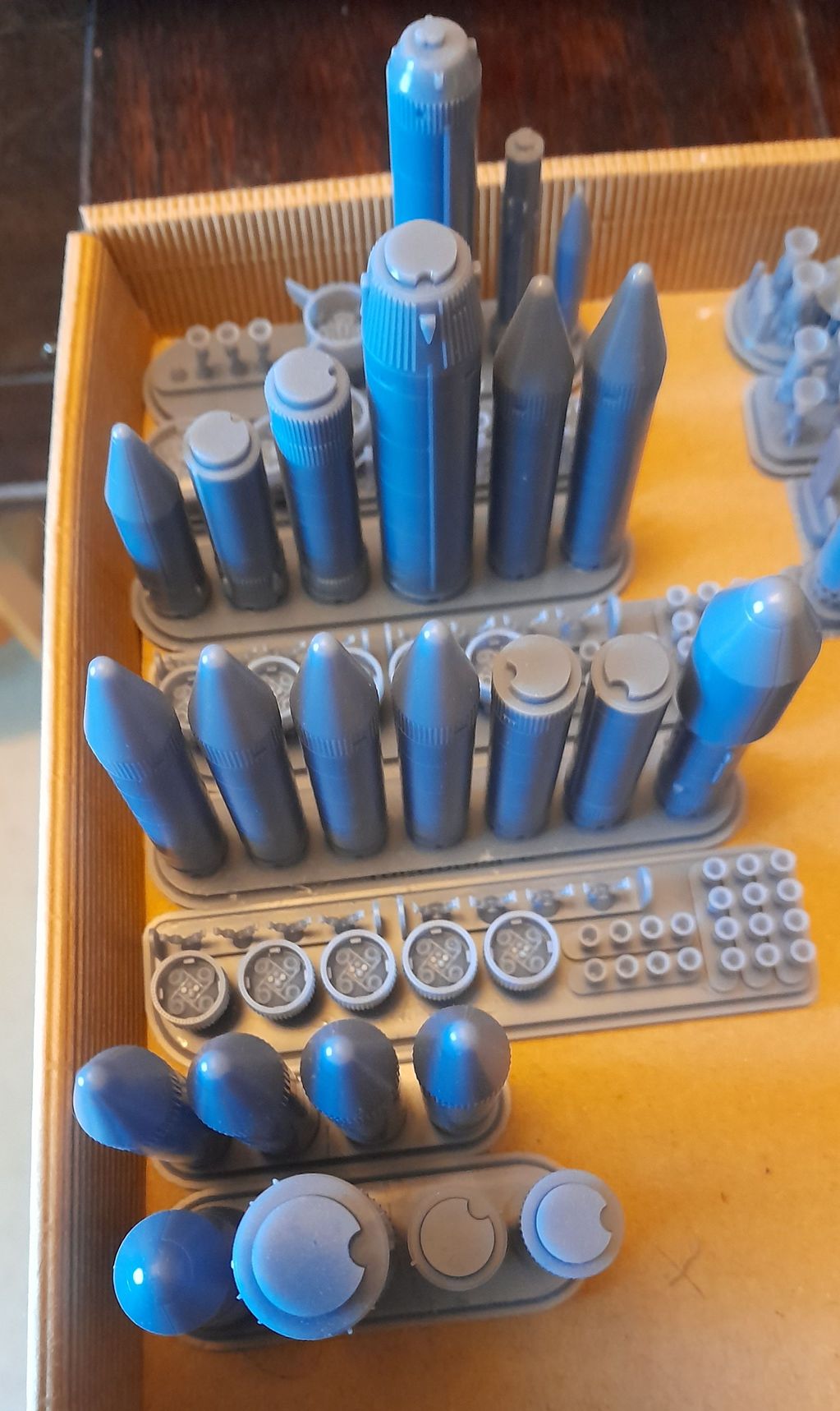

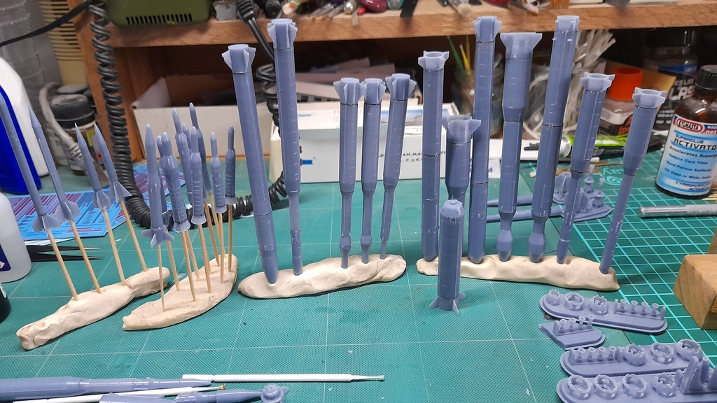

Then come the LRBA designed projects, based on liquid fueled cluster first stages based on existing Diamant Améthyste and projected larger versions:

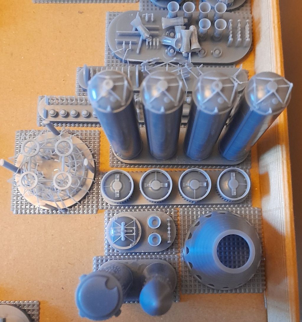

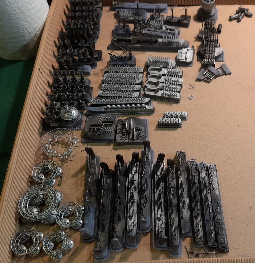

Compared to my earlier prints (shown at the begining of this subject) many parts have been redesigned, correcting errors, enhancing details, making further assembly easier and more geometrically accurate. I managed to withdraw any photo etched part or brass rod, thank to the tremendous progress of 3D printers over the last five years

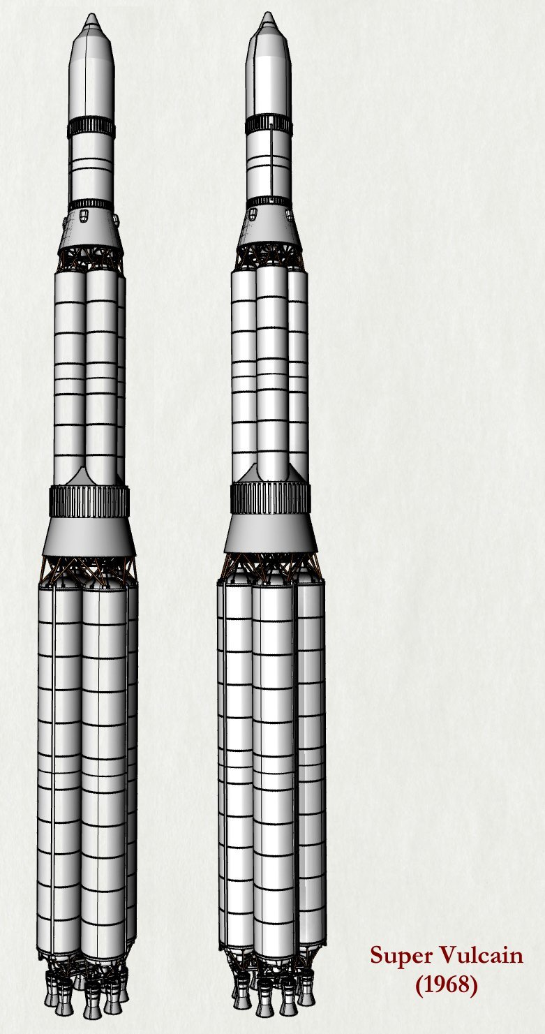

At last the "Super heavy" launcher projects from LRBA of 1968:
Redesigned parts: this Super Vulcain interstage structure replaces a former ensemble of 4 resin, 8 photo etched and 56 brass rod parts with one single more sturdy printed part

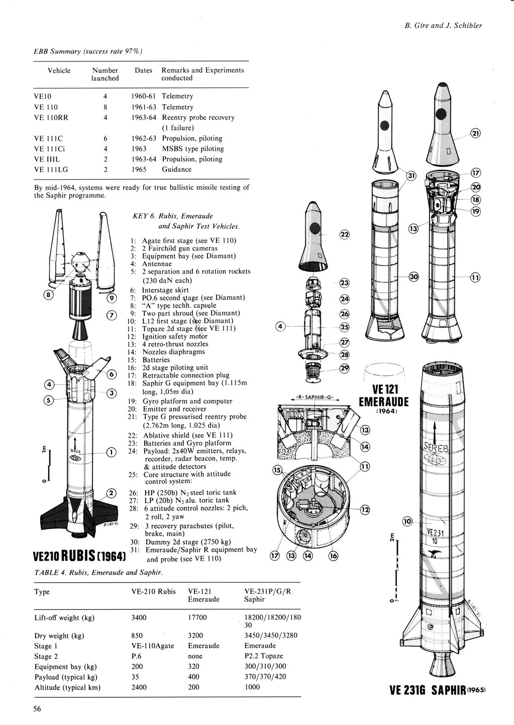

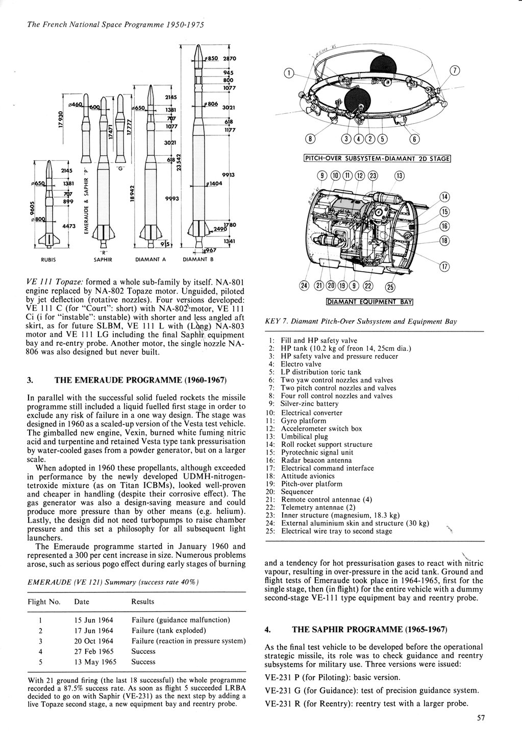

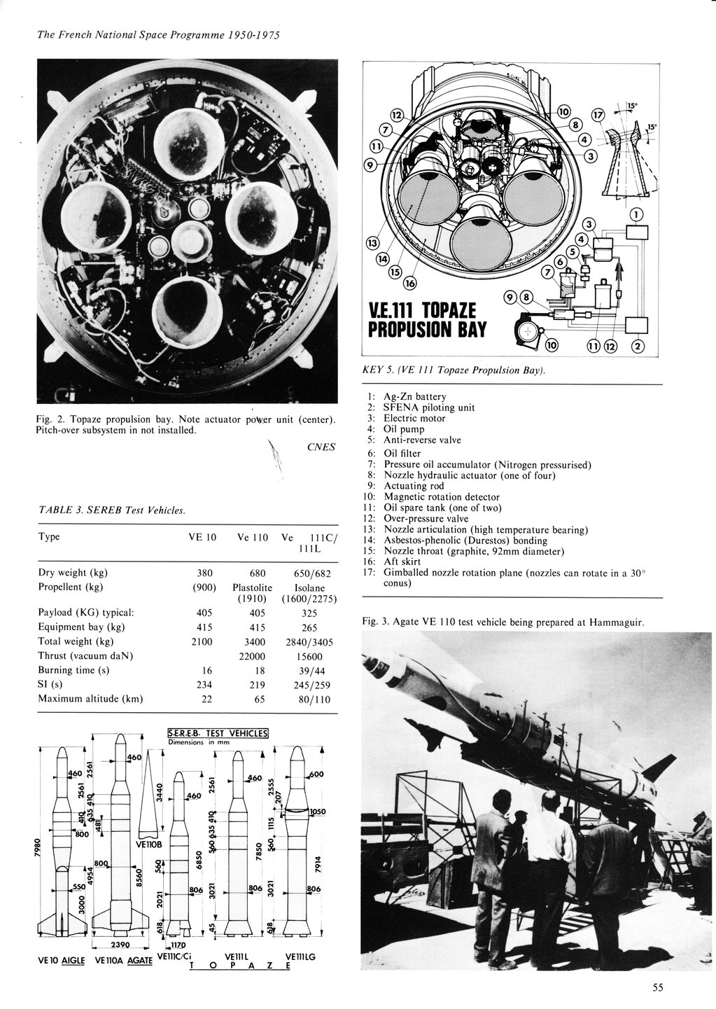

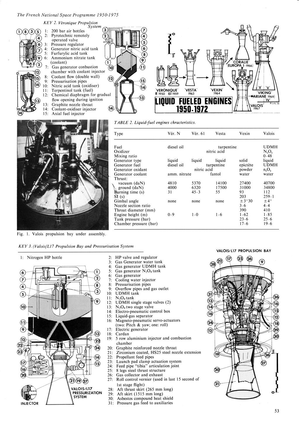

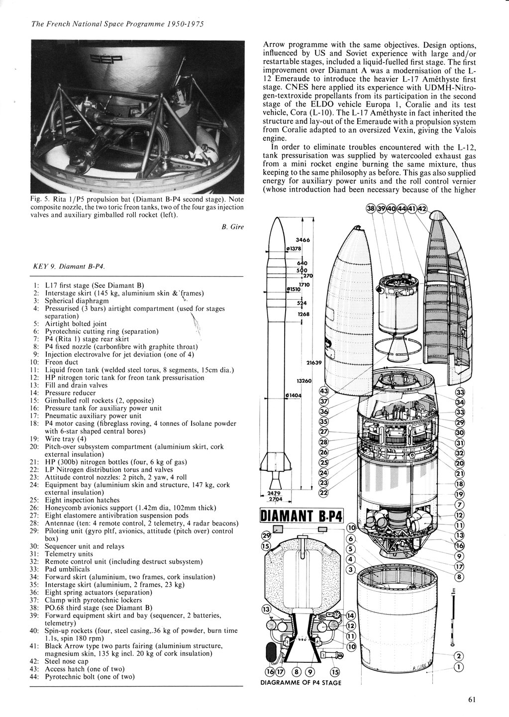

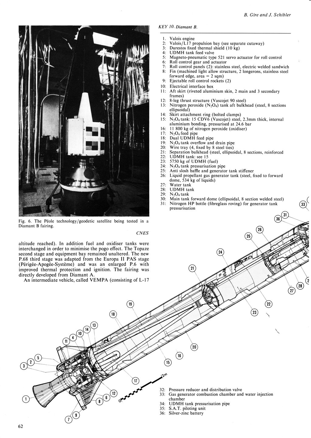

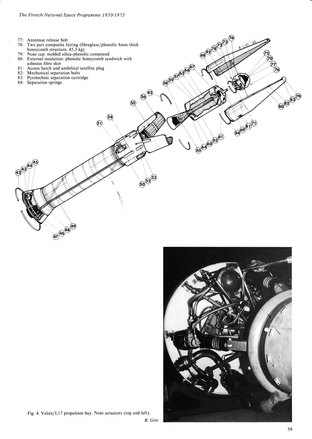

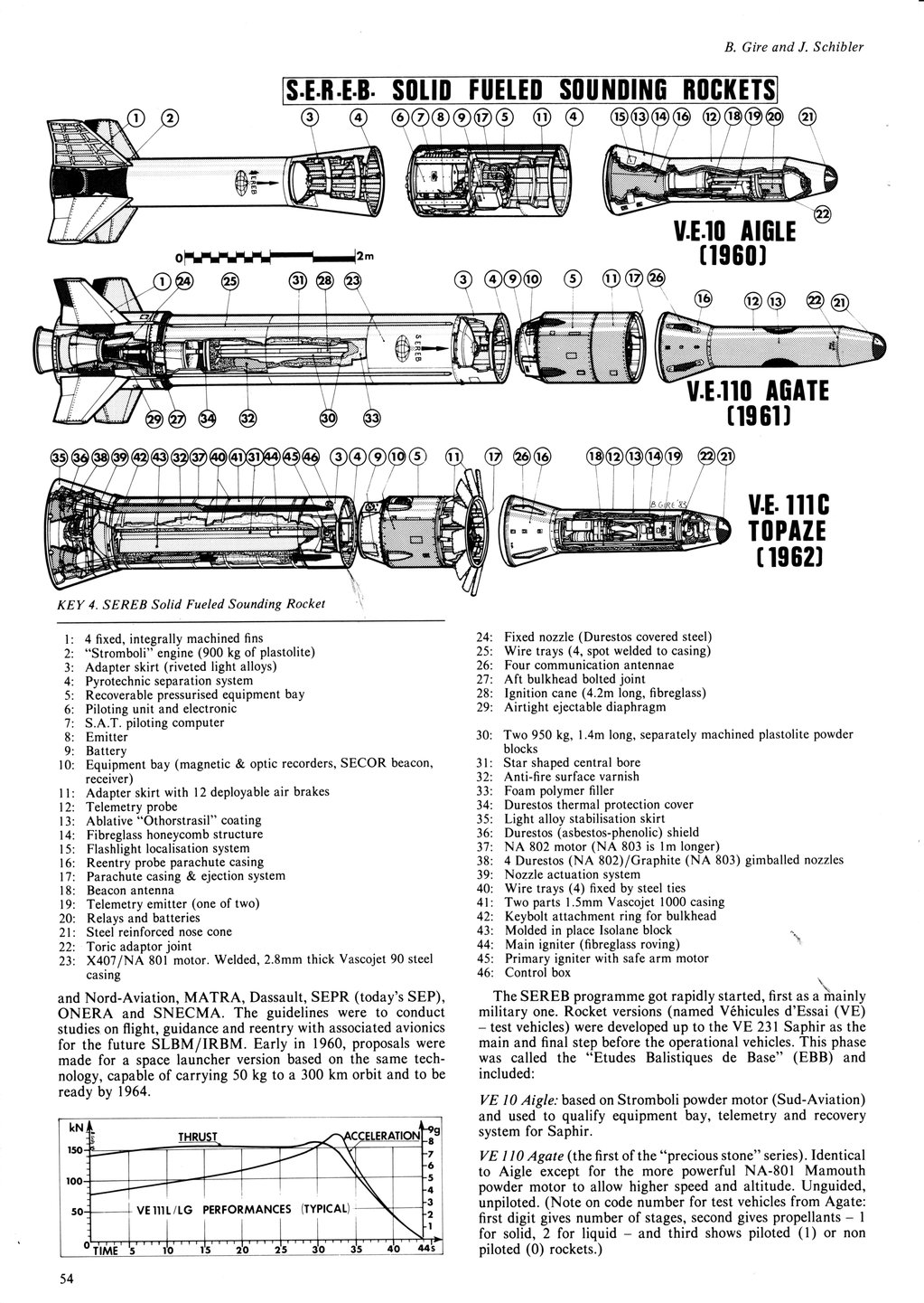

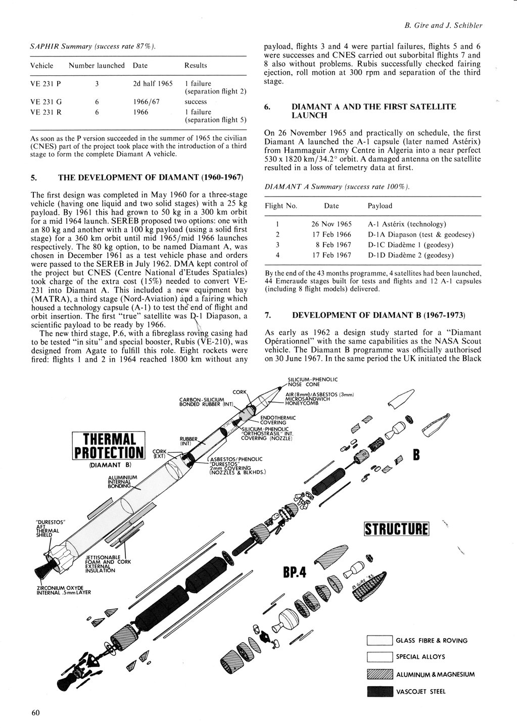

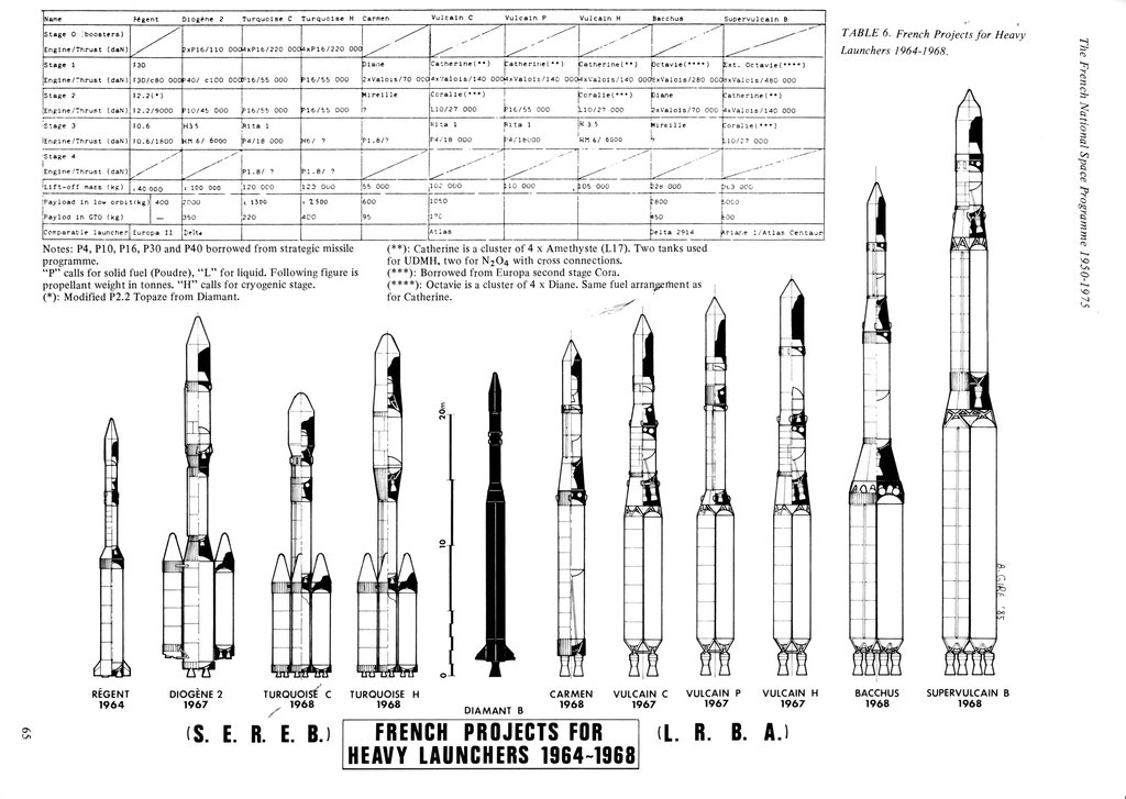

Actually does someone have bgire’s " The French National Space Programme 1950-1975" from JBIS 40 that he linked in the first post of this thread ? The link is dead
Hello TheKutKu,

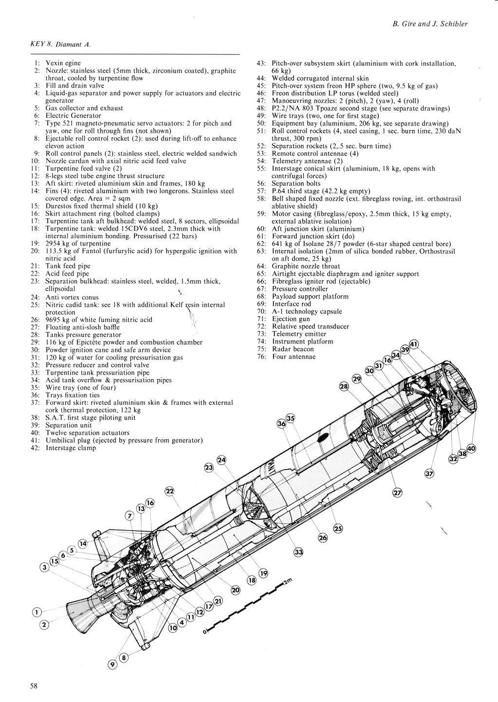

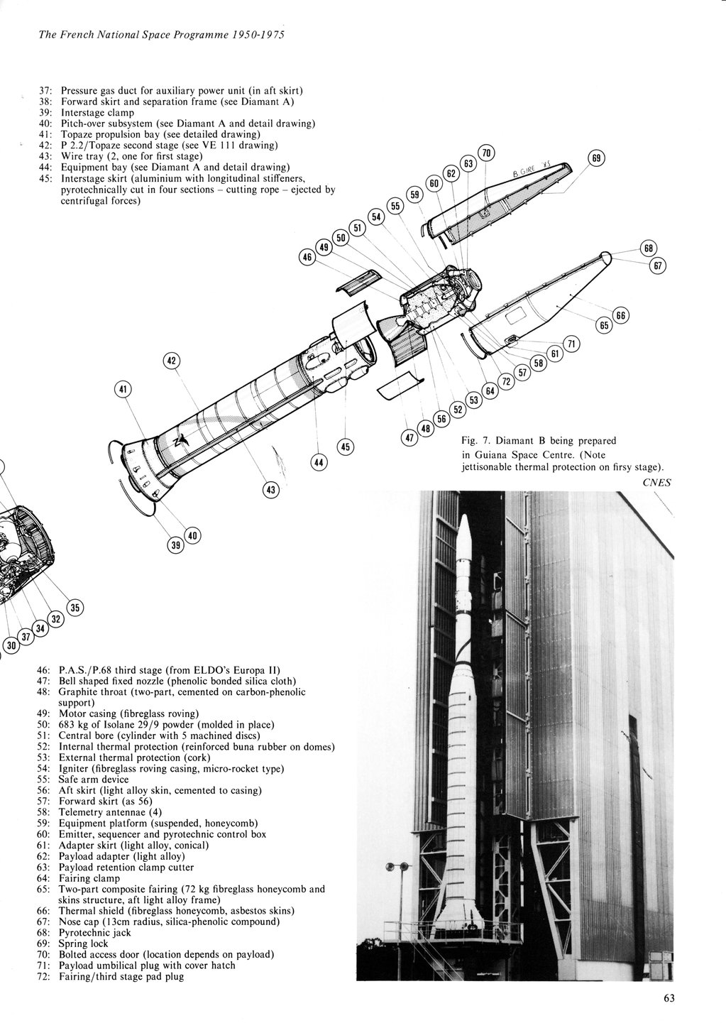

Here is the JBIS 40 article I co-wrote around 1983 and which originated my "quest" for modeling these forgotten projects.
All drawings are mine, done "the ol'way" using China ink... that was eight year before I got my first computer!
Hello TheKutKu,
Thank you so much! These are really beautiful cutaways, they almost feel out of place in a scientific publication, incredible.

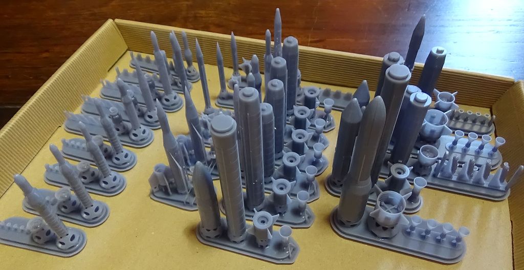

After a six month break, I'm back on my French launchers project, this time at 1:144 scale.
Previously on this subject:
My original project (1982) was a detailled technical survey which went published in the Journal of the British Interplanetary Society by 1987. At that time I began thinking of doing models of these launchers... sometimes.
The challenge was: which scratch technique to use? By these early times I was just aware of photo etching and my first resin castings weren't really presentable.

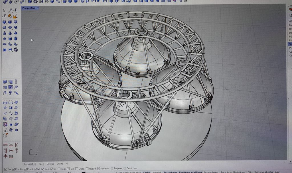

In 2010 I discovered 3D drawing, then two years later 3D printing (from a company... expensive... not great resolution).
In 2017 I bought my first 3D printer and set about producing masters of these machines for reproduction by resin casting. These are the photos above. Accuracy was good but the finished product (moulded) still left something to be desired.
In 2022 I bought my third printer and this time I discovered excellent precision (19 microns) and a printing cost so affordable that it became possible to produce direct prints. Gone was the expensive and time-consuming moulding phase.
The new printing precision meant that the drawings could be completely reworked for a fourth version with even greater finesse and precision. In fact, between 2017 and 2023 I went from a resolution of 84 microns to 19 microns, and I had to redesign the most of it.
So the final assembly of these forty launchers is finally complete.

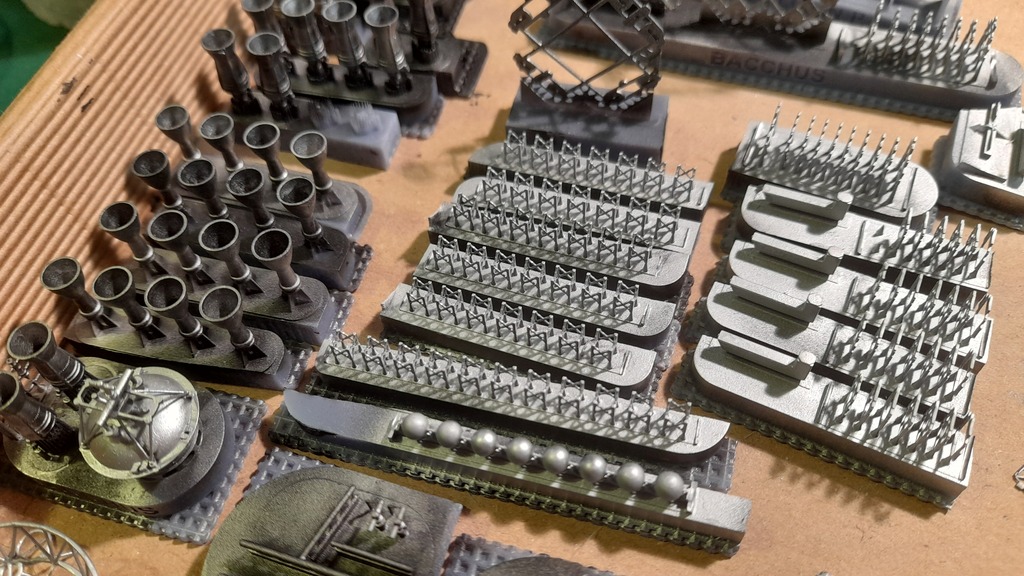

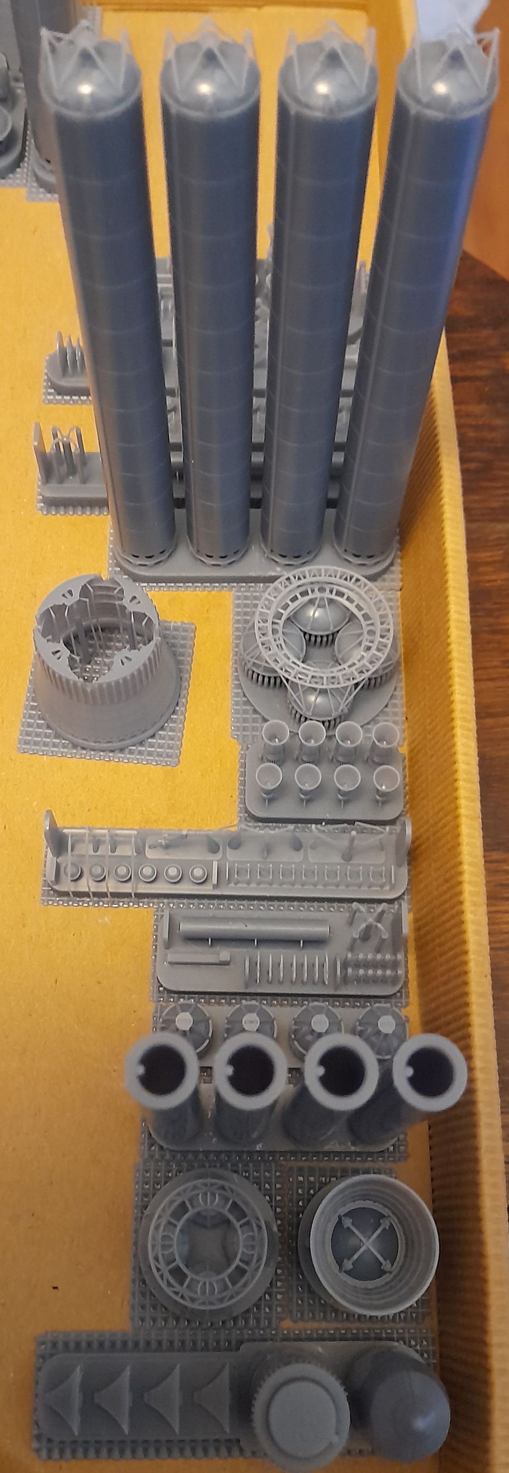

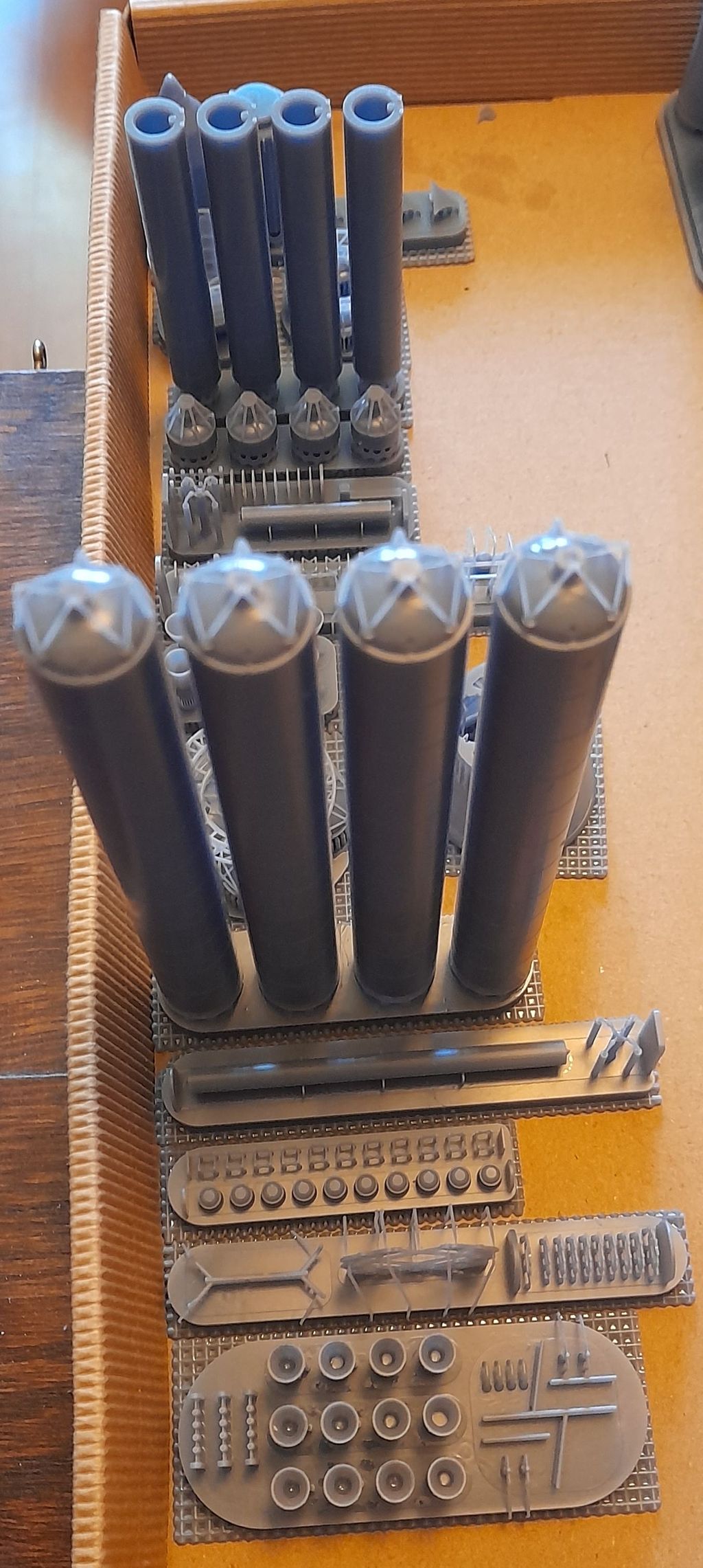

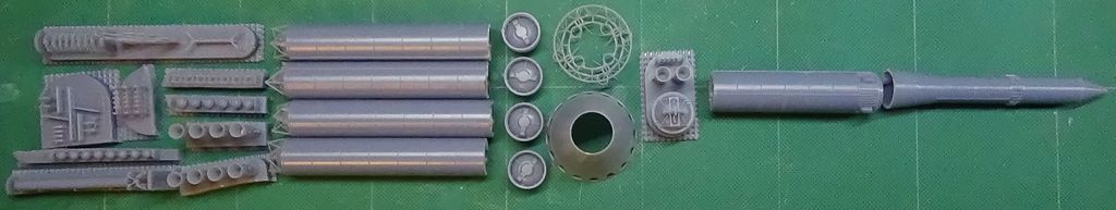

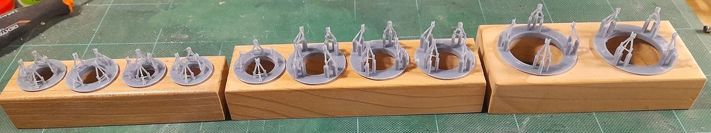

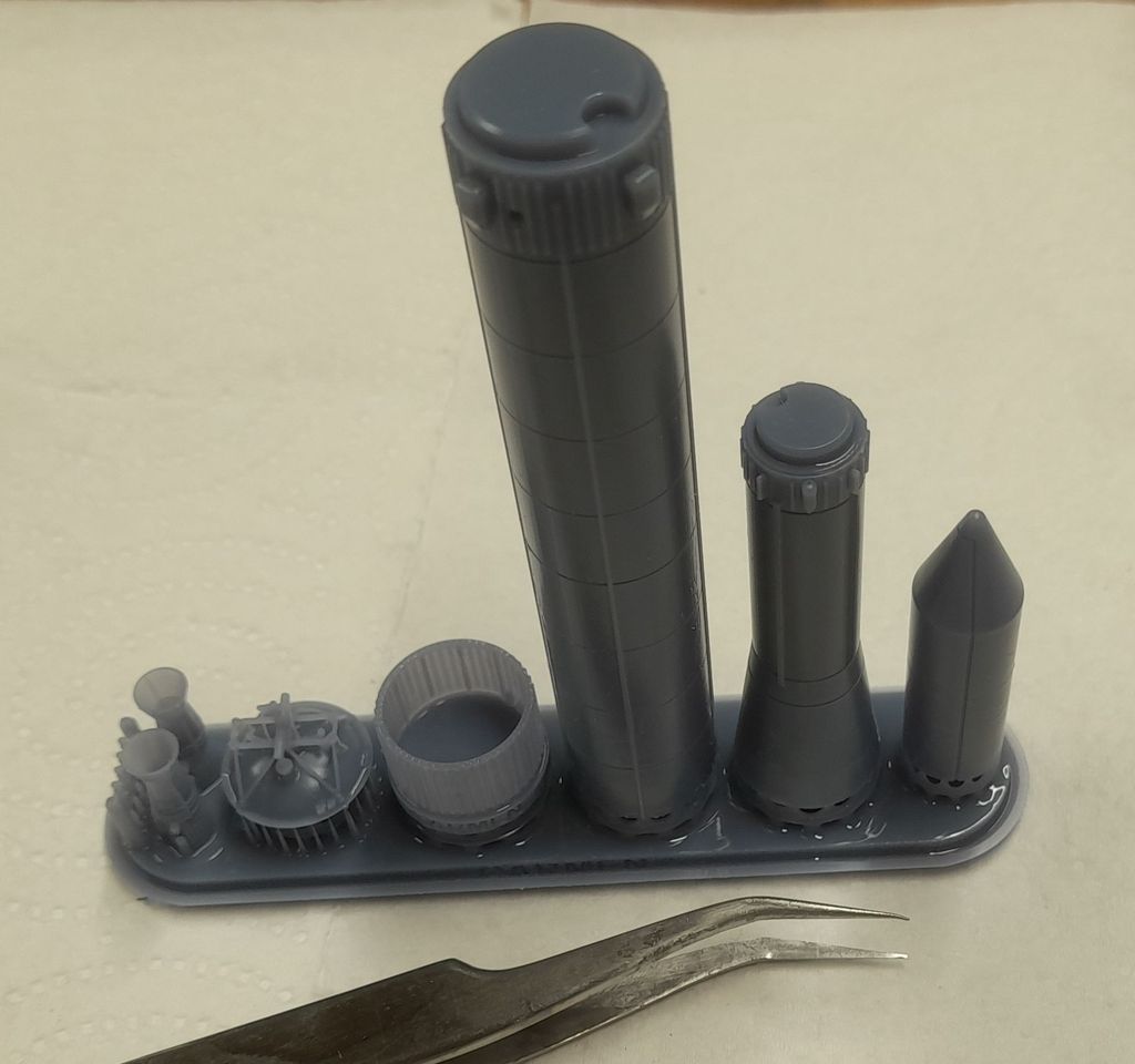

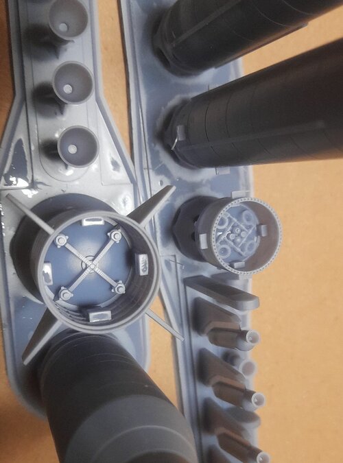

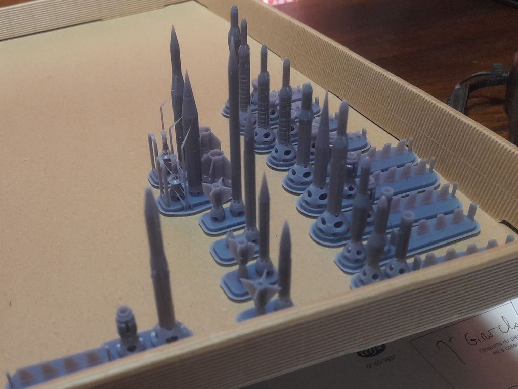

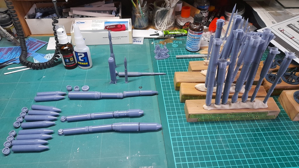

We start by printing the last version:

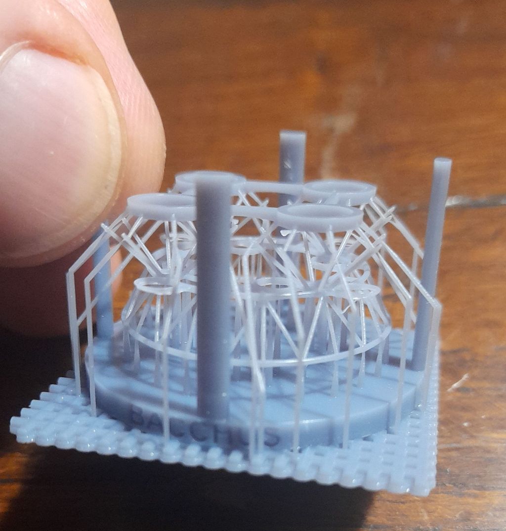

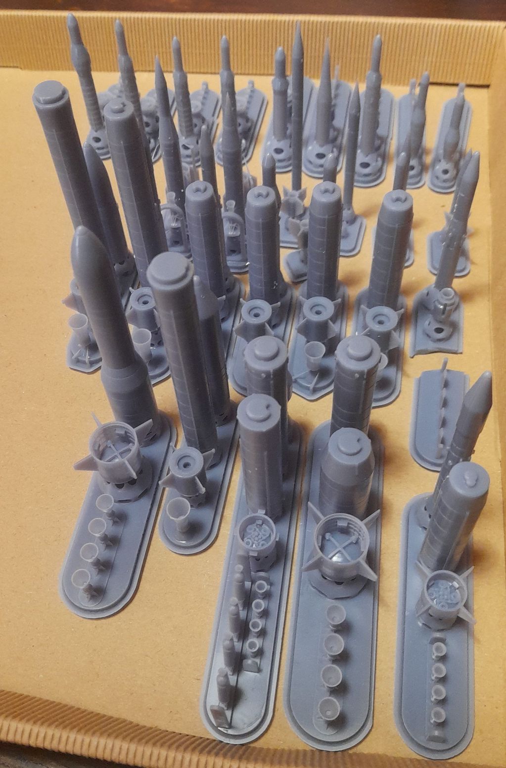

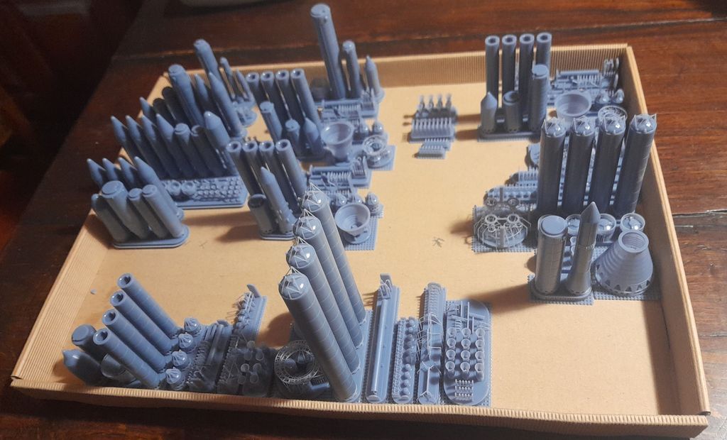

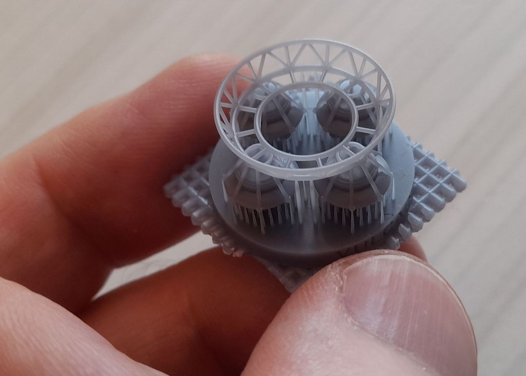

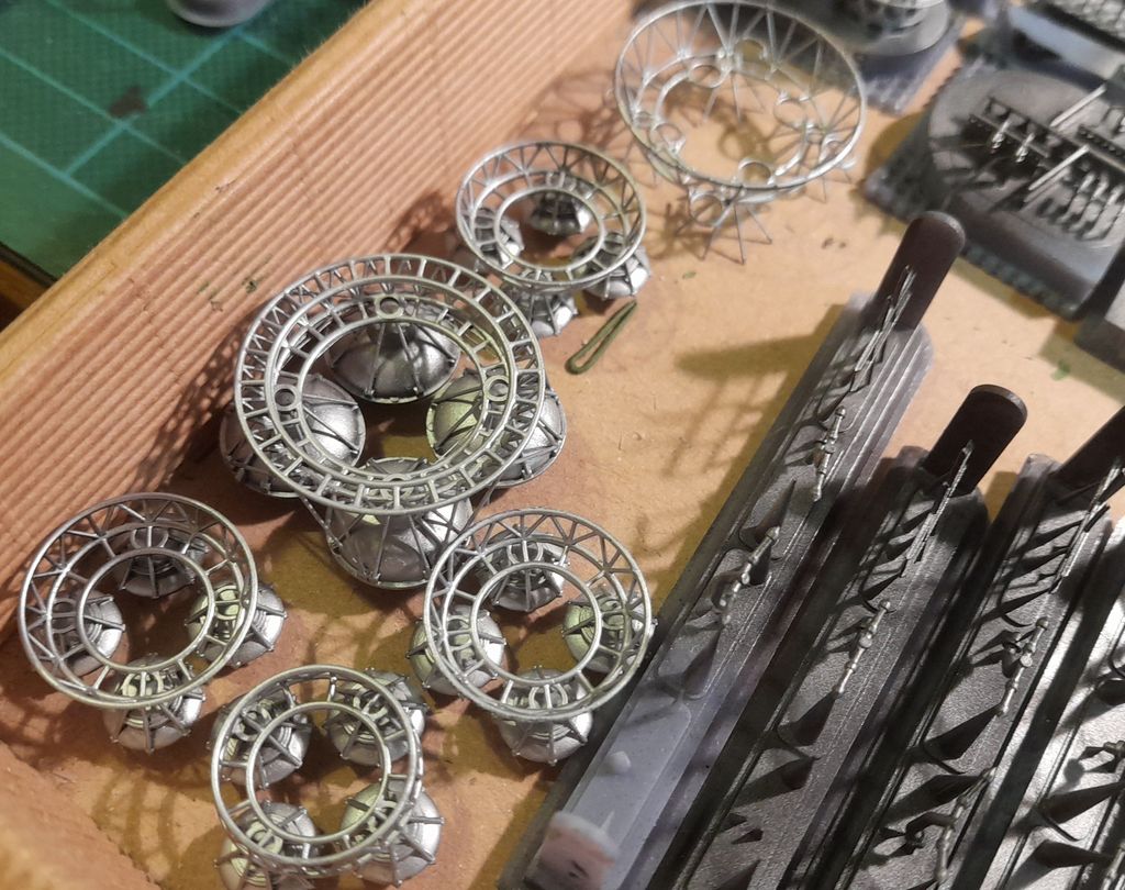

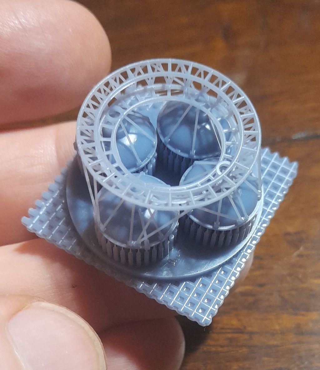

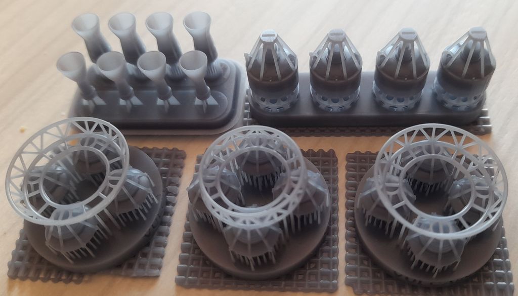

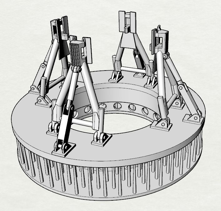

The interstage trusses of the big LRBA projects of 1966-68 were reworked, refined and printed. The first versions were made entirely of PE, which made assembly extremely difficult, if not impossible. Well... impossible in fact.
L'impression se poursuit :

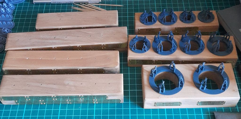

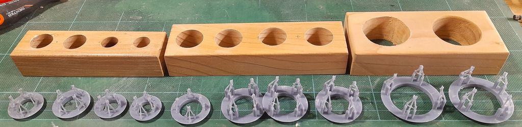

I'm taking this opportunity to solve a support problem: the biggest launchers have multiple engines at the base and to make them more visible I've taken inspiration from a contemporary launch cradle for American Titan rockets to invent a support that goes well with it:

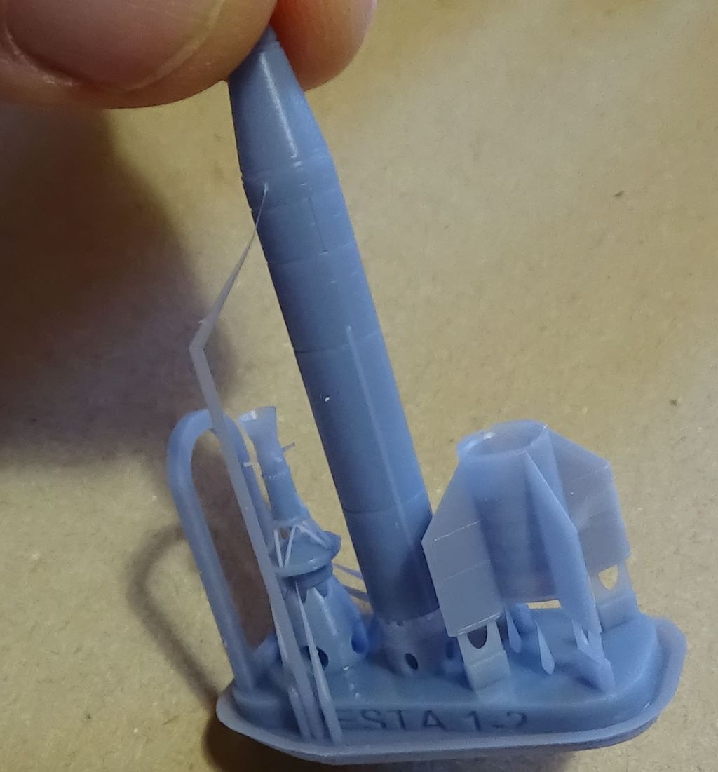

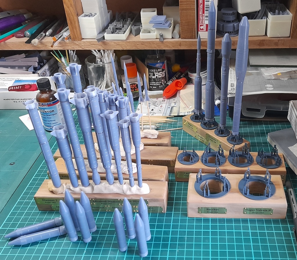

Start of assembly (in real chronological order) :
The interlocking studs on the different stages are not long enough (2mm), even though they also act as locators for the relative orientation of the two elements. I'm still managing, but precise alignment on the axis is a bit tricky. This will give rise to a fifth version of the drawings with tenons 3 times longer, which will be used for future prints. This proves the old adage: always make a prototype assembly before moving on to the final assembly.
On the right, the first rockets on their cradle:

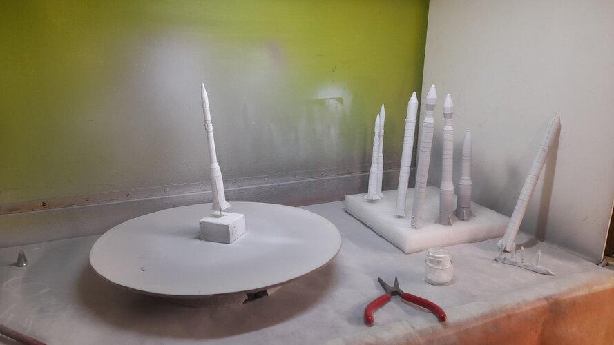

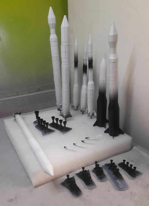

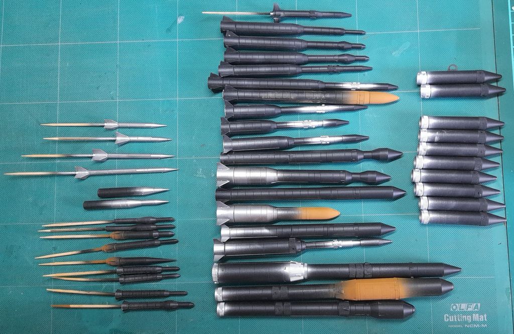

The first part is finished, containing all the launchers that actually existed, from Veronique to Diamant BP4. The painting phase begins with an AK black primer:

Then the LRBA's liquid fuel launchers:
Carmen :

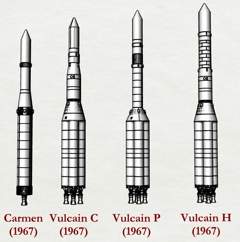

Vulcain C, P and H :

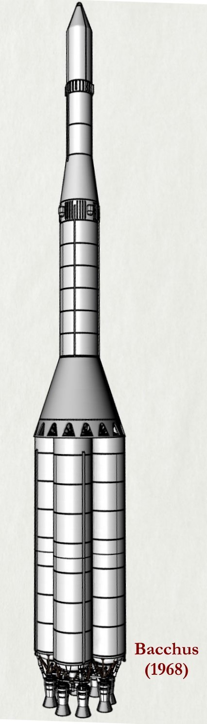

Bacchus and Supervulcain 2 :

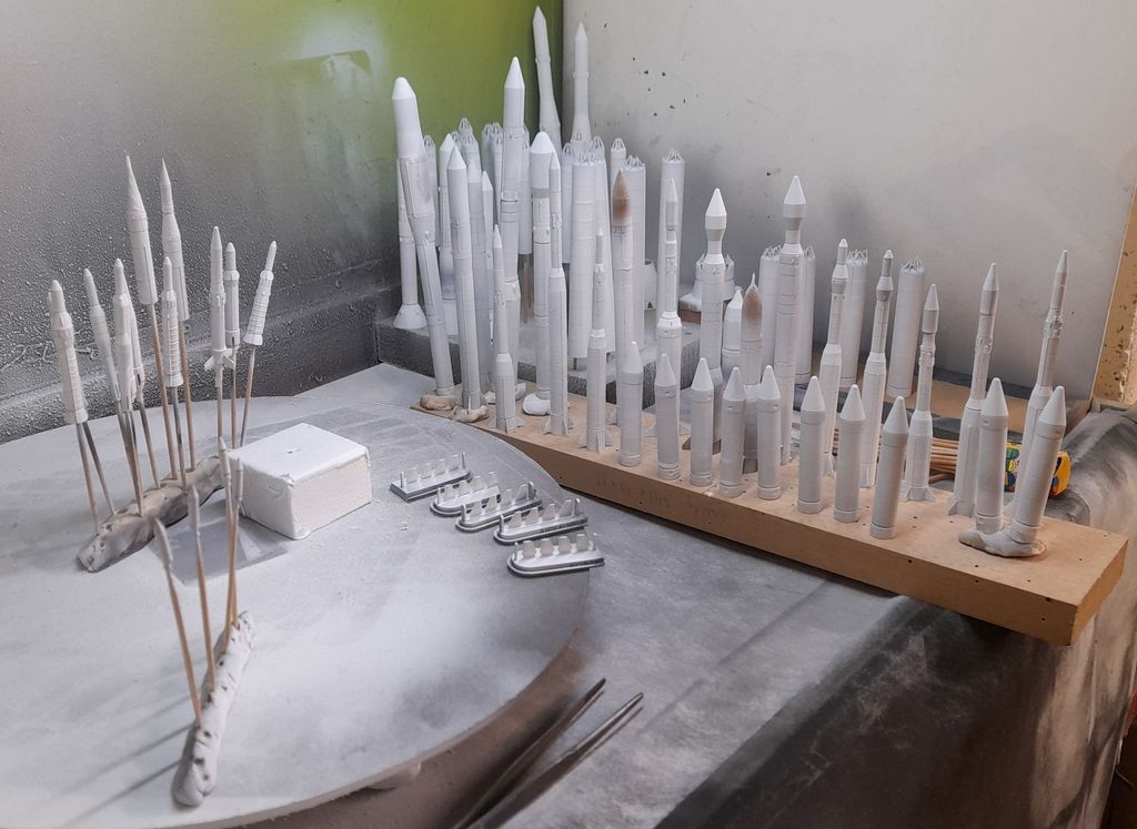

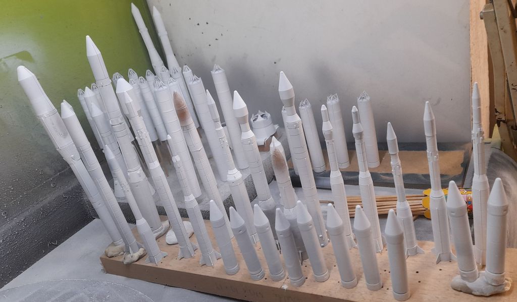

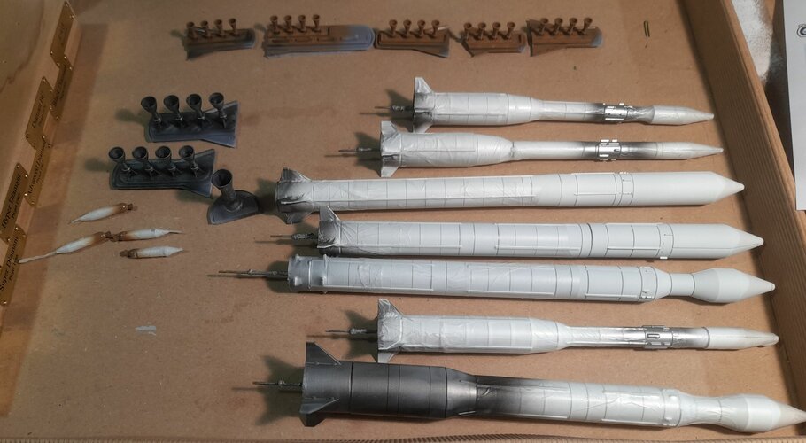

After assembly and priming, this second group joined the first for general painting.

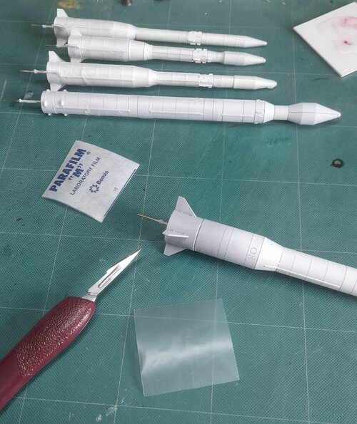

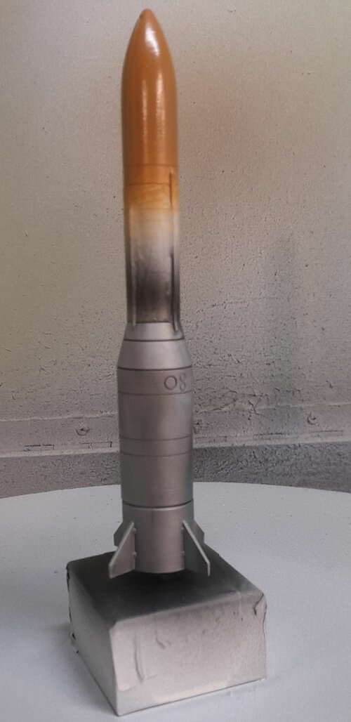

After masking the parts that will remain metallic with Parafilm, 4 coats of Tamiya XF-2 matt white are applied. 4 hours of work and two large 23ml pots of paint, but the result is there:
Close-up of the Hyper Diamant boosters. Note the nozzles, previously painted light brown and masked with Parafilm, which is also used to fix them with toothpicks. Each booster is 8mm long and its nozzle about 1.5mm:
The other elements are painted with Alclad2 on a black base (Steel, Airframe aluminium, White aluminium, Magnesium).
Three more masking-painting operations for the other colours and we'll move on to the final assembly.
