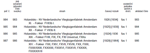

Fokker Civil Projects
From Czech National Technic Museum,
I found those unknown Projects for Fokker,F.XXXIX,F.XXXXII & F.XXXXXVII,or F.39,
F.42 & F.57
,does anyone hear about them ?.

They likely never existed as pre-1945 designs. By 1935, Fokker was abandoning its chronological sequence of 'F' designations in favour of designations based on seat numbers - beginning with the F.XXXVI (F.36) airliner. (Around the same time, the shift from Roman to Arabic numerals in Fokker marketing materials began in earnest.)
Since then, many people have tried to 'rationalize' those 'F' series designations under the misapprehension that Fokker was still following a numerical sequence.
Yes my dear Apophenia,
but we can consider them unknown Projects ?.
I would say not. We can consider these as possible designations for potential projects. We do not know for sure that 'F.39', 'F.42', or 'F.57' represent actual projects.

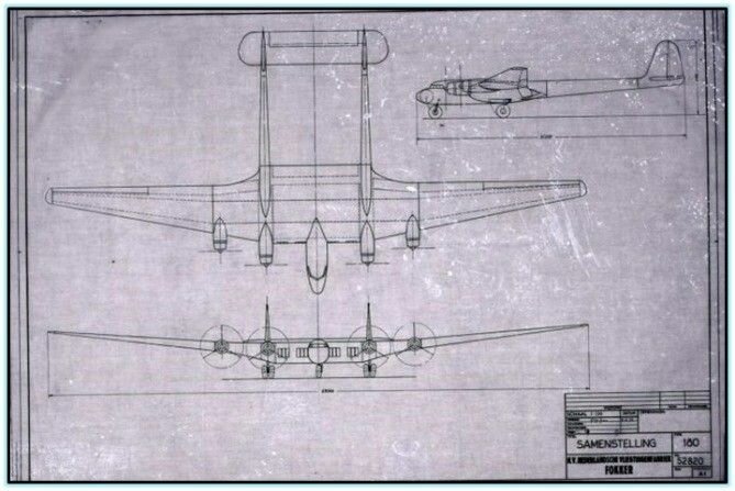

A few captions in de book are incorrect , especially in the chapter abour te Fokker 4-engined designs.
The drawings (or the captions) of the F.XXII and F.XXXVI are wrong. The schetch of the 180 is not the F.180 but ontwerp 180.

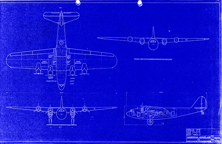

here is a drawings to Fokker F.XXXVII and F.XXIII.
See the photograph spanning pages 296 and 297 of "Anthony Fokker, the flying dutchman who shaped American Aviation." by Marc Dierikx (Smithstonian Books, Washington, D.C. 2018). ISBN 9781588346162 (eBook) or 1588346153 (hardcover).
The photo portrays Anthony Fokker explaining the D.XXXVI airliner to Soviet representatives. The airplane was traditional wood and steel structures covered in fabric. Fokker never sold airplanes to the USSR. By the late 1930s, Anthony Fokker personally was unable to keep up with the latest developments in all-metal airplanes, so he shifted away from production and focused his efforts to acting as European sales rep for Douglas (DC-2) and Lockheed (Electra)

I ran across this 3-view of a possibly proposed Fokker project, but I can't find any information about it. The title block on the 3-view is blurred, but the words "Fokker" and "US" can be discerned. Does anyone have more information? samenstelling 3view.jpg
