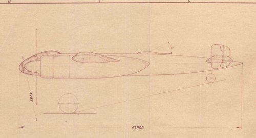

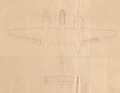

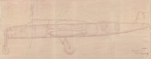

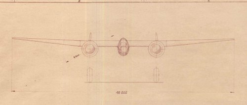

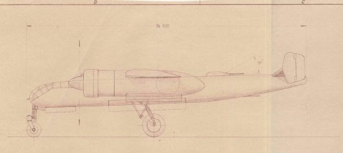

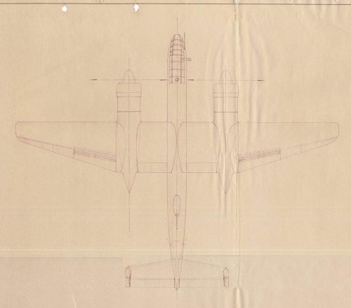

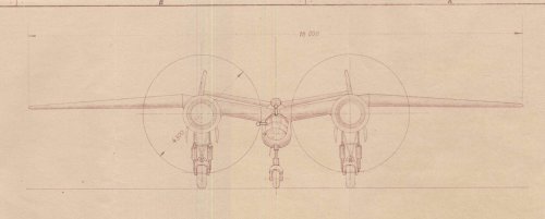

Two unknown high-speed bomber project Focke Wulf with 2x222 C / D, dated September 1942.
Re: Focke Wulf - 'Shnellbomber' (1942)
Very interesting Borovik,
Such a design would have comparable performance to enemy fighters. Even if the fighters could get into an intercept position, the bomber could turn away and easily force the fighters to attack from the rear. This would make the enemy fighters very vulnerable.
This seems to be recognised by the designers as well - since the turret has such a limited range of motion. It is interesting to see that they figured out this principle.
It would be interesting to calculate performance figures for these designs.
Thanks for posting, Borovik! :)
Dear mods, please change the topic title to "Schnellbomber", before I get eye cancer. :p
Apologize
My German teacher, today turned over in his grave.
Alas for thirty years without practice. ((

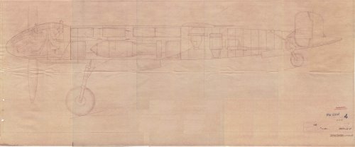

it was from P.222 series,we know only four designs,P.222.001,P.222.004,
P.222.010 and P.222.018,the missing numbers are unknown.

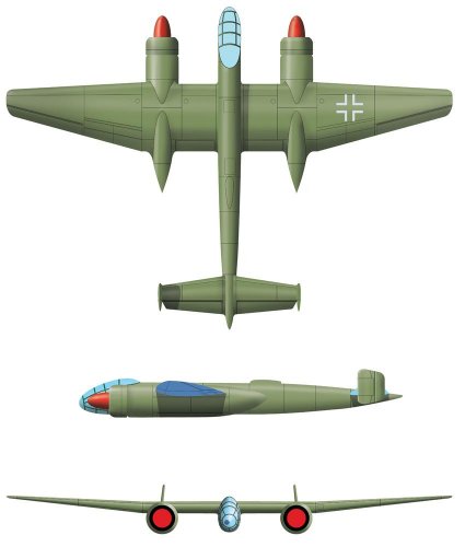

airman said:
seems based on core of Focke Wulf-154 or am i in mistake ? ???
I think thats looks like more a Fw 191 - specially the first drawing!
Hi all...
I'm about to start.
Of the two designs which is the 'C' and which is the 'D'.
Forgive me if it's obvious ;)
P

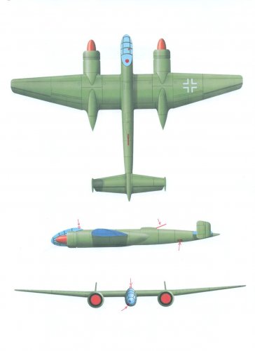

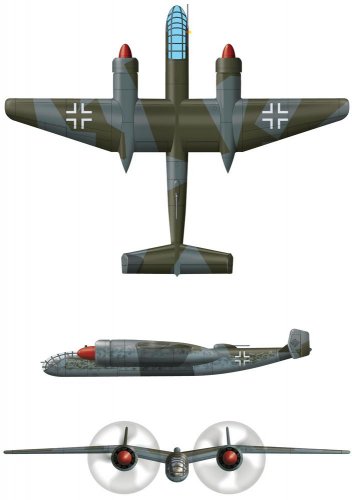

Indeed I've made a start; of the cranked wing version first.

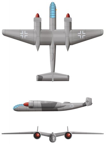

As usual, corrective critique or additional detail info truly welcomed and appreciated.
Many thanks
P

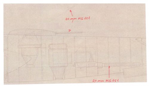

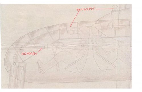

Hi all...
a bit of confirmation please...
looking at the cutaway side views both versions would have had 2 crew members, am I correct?
I'm pressing on with these two now.
Many thanks
P
You're correct ! You can find it on the data sheets in Boroviks post #5:
"Besatzung 2 Mann 180 kg" . So, Hermann Göring surely didn't qualify
as crewmember . ;D

Justo Miranda said:
Hi Flitzer,
It looks very much like the Mitchell. :)
But without the stepped cockpit !

Great find Orionblamblam
Interesting comparison with the Mitchell, Justo and Jens.

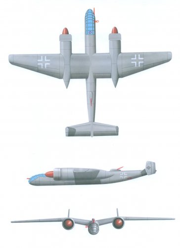

A little further with design 2. Spinners too big on front view.
P :)
Progress report for the other one...
P

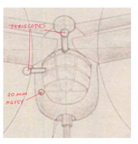

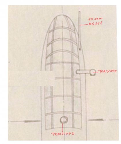

2nd drawing , my opinion
Great stuff Justo.
These will all be incorporated....
Thanks
P
Another update...
Started adding Justo's suggestions.
And much better for them too.
A few more to do. :D

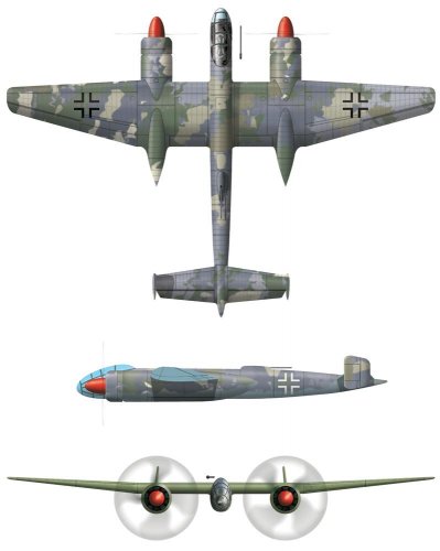

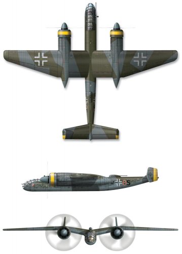

Latest statuis.
Nearly there. A few bits and bobs to sort it.
What next? Do I do the other Schnellbomber or get stuck in to the 'fresh-in' Stukas? It never rains but it pours... ;D
Comments on a postcard...
P

Your wish is my command...well, a progress report if not finished.
P :)

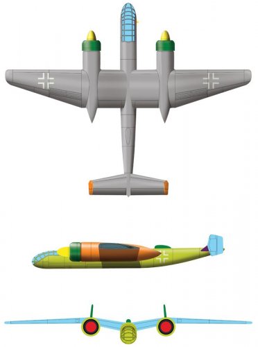

Many thanks.

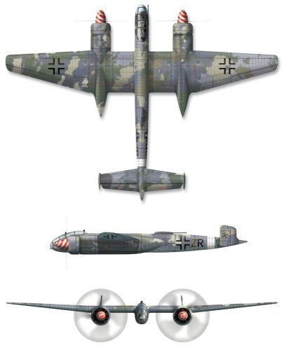

Finished, more or less, the first design.
P
Excellent work :)
I do like the gull-wings version a bit more then the straightwing version :)
Also I like that you can see into the cockpit, that adds a lot more realism to the drawing.
