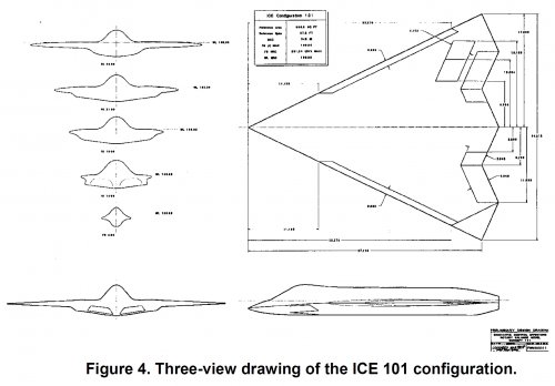

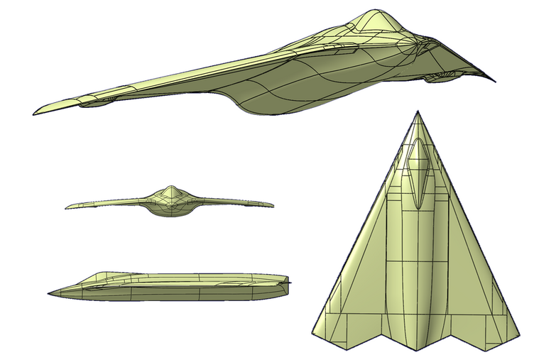

Innovative Control Effectors (pdf). These are the same Lockheed designs shown up thread, but with more detail on the structure and the effector schemes tested.
