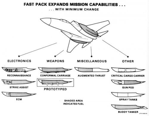

Yes, but those missiles were launched on the rails. The AIM-120 falls first and then the motor starts.
AIM-120 can be launched either way.

As you mentioned, just the missile extraction from the FAST packs is going to take some serious time and money to develop.

And those spray tanks weren't for puttin' out fires. ;)
