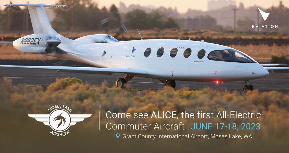

I wonder what all those terabits are worth when flying around without even retracting the gear. Probably all the information was, it is by far too risky to fly it a second time...Very likely, the wet hands of the pilots was all they needed to know...
I'm not an aircraft expert, but I guess with some experiences in aircraft design (maybe by building model planes), the plane would have had less problems and could have even used the originally intended runway…

We don't know for sure but it seems the airframe fared well during that flight. I haven't noticed anything twitchy in the flight trajectory. Let me know otherwise.

They had to go for a longer runway, which clearly showed, that the plane didn''t behave as expected. What kind of information can you learn about aerodynamic efficiency when flying with extended gear?
Someone here in this thread said, the FBW system was never installed.
A while back, an interior picture of the prototypes rear fuselage showed what looks like control cables I.e the type that are tugged on by the pilots. A quick search of the web and I can’t find it, indeed pictures of Alice’s prototype interior seem to be non existent.
As I said before they announced the move to the longer runway, a simple look a tailplane volume fractions suggested marginal pitch control moments.

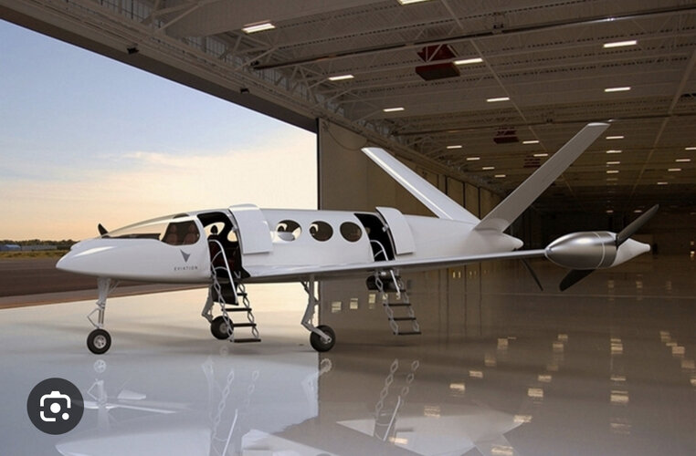

I thought I would post some detailed images of the very first prototype that burned down before its first flight for comparison with the current aircraft being flight tested. Even though the company never admitted it, they must have had some serious CG issues caused by the weight of the batteries that forced them to select a tailwheel configuration, which was ultimately rejected by potential customers and completely discarded. So this project has had design difficulties since the very beginning. Very interesting to note that back in 2019, they were claiming a whopping 650 miles of range.
I believe, the tailwheel configuration was choosen to protect the rear propeller during rotation
But for a while it was rear prop engine with a nose landing gear, as you say hopeless.
And before that, it was a wingtiped engine twin, again utterly hopeless if you lost thrust from one side…. Say a blade came off like happen recently to Vertical’s XV4.
It's not uncommon for landing gear to be left down during a new design's first flight.
What IS very unusual is for a flight test campaign to consist of a single 8 minute flight, which is then declared (months later) to have provided everything they needed to know about the aircrafts performance....!
I know, that it is the way to do it for the first flight, but if you really want to learn about the behaviour of the plane and if it can fullfil the expectations, I assume you need to test it in the most used configuration with the gear up.
The wingtip version also had a rear propeller, I guess that was the reason why they wanted to have a wheel at the end
