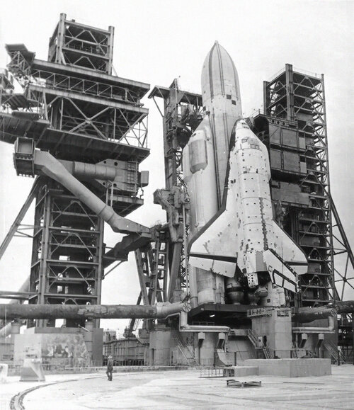

Did the main rocket use foam insulation like the American main tank? Tha's what I always wondered.
Yes, it was covered in spray-on foam insulation similar to the one used on the space shuttle (Ripor 2N, PPU-17) with some sections covered in ablative material (PPU-306, PPU-306N, PPU-306NP, applied mostly around the aft orbiter attachment points)
Oh so the Buran would had had the same issues as the space shuttle!
Yes, but since Buran was never meant to become the only Soviet crewed spacecraft, Rescue with one or two Soyuz (or eventually, Zarya capsule) would be more manageable if the heatshield would be thought to be compromised, there were proposals to carry emergency return capsules in the payload bay too.
Well, the oxygen ramp on STS faced the orbiter on the exterior. Energiya could have had the line in the middle of opposite from the orbiter.
No SRBs--no Challenger.

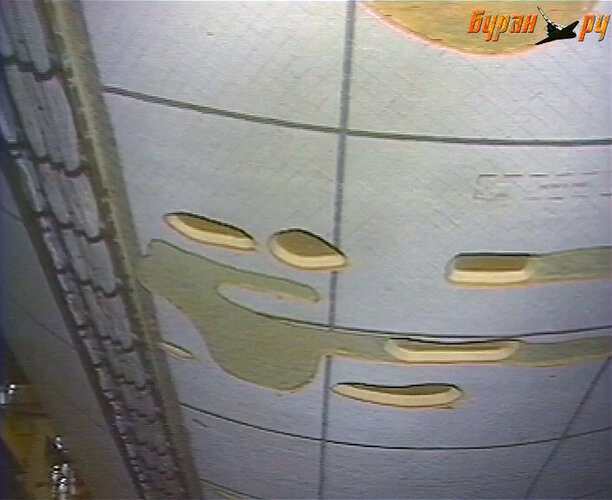

Falling ice was definitely a serious issue that was considered by the designers and was probably what caused most of the tile loss during the 1988 orbital flight. The core stage did not have any foam ramps like the ones on the Space Shuttle ET, so a Columbia-type foam impact was unlikely, same with Challenger-type SRB burn-through, but "standard" ceramic tile spaceplane risks were still present: falling ice, tile erosion, gap filler protrusion, airframe overheating etc.
Doesn't matter. Debris came off of other areas than foam ramps

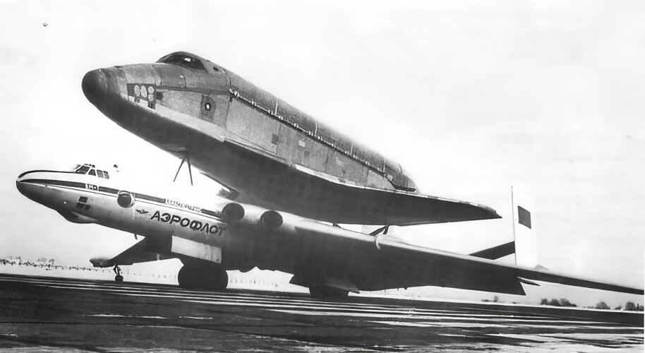

No, the Enterprise was built by NASA to perform atmospheric test flights after being launched from a modified Boeing 747. The OK-MT was built for static testing (*), the only time it flew was when it was transported by the Myasishchev VM-T "Atlant" from Moscow to Baikonur.
(*) OK-MT was built in Moscow in 1983 for technological developments, the transport documentation development and loading of the gas tanks, the hermetic systems of safety, the entry and the exit of the crew, the development of the military operations, the maintenance and the flight manuals. Source: www.buran-energia.com
