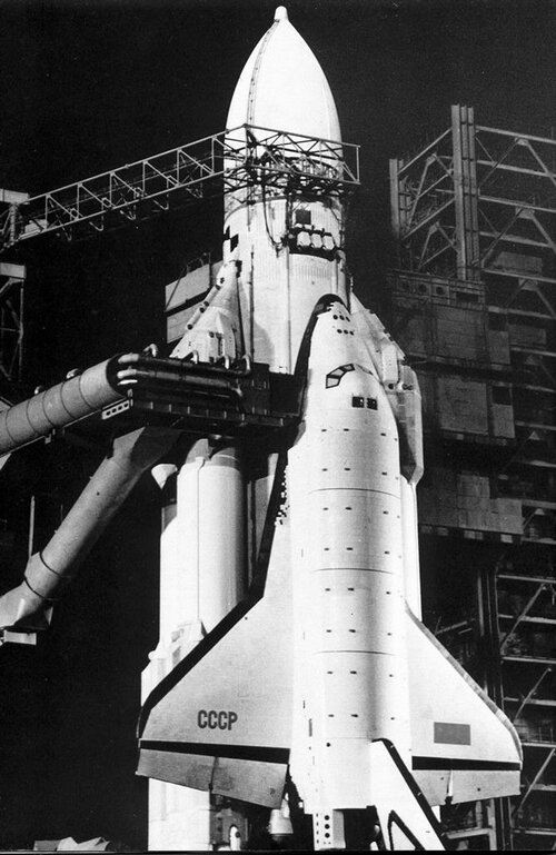

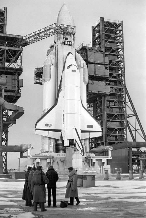

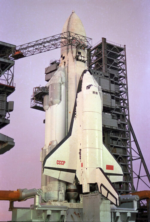

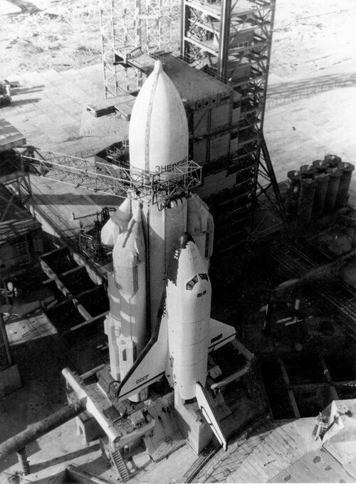

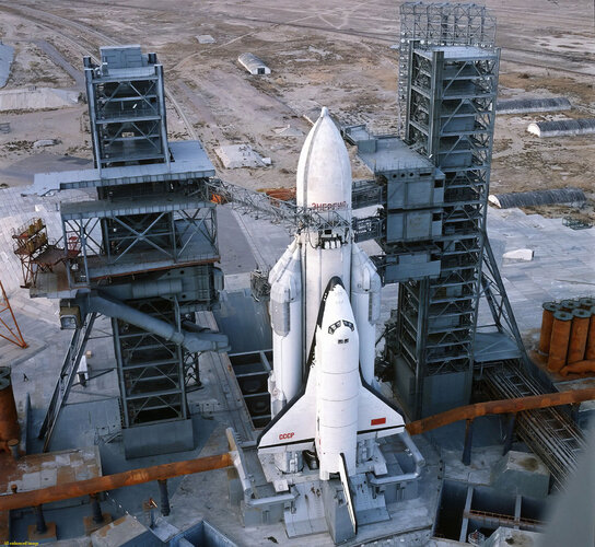

Thought you might find this interesting: photos of Buran on the pad during the May 1988 rollout with the Buran decal airbrushed out. They were released in late September 1988 to coincide with Discovery's Return To Flight mission, but before the name "Buran" was officially released as the name of the orbiter.
1733597004271-jpeg.751345
And in color as published by TASS (re-released by RGANTD), and in Aviation Week - this time with "Buran" blacked out:

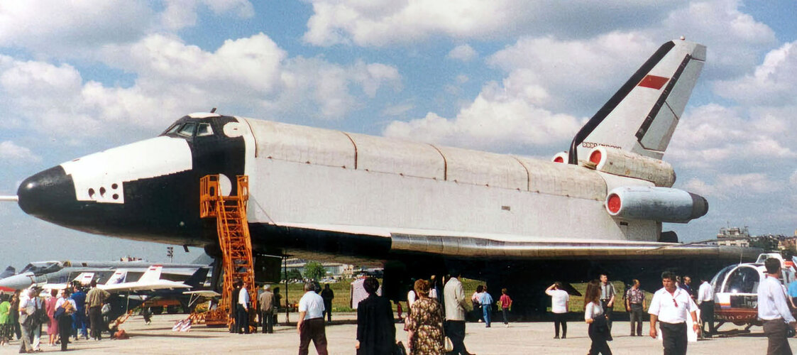

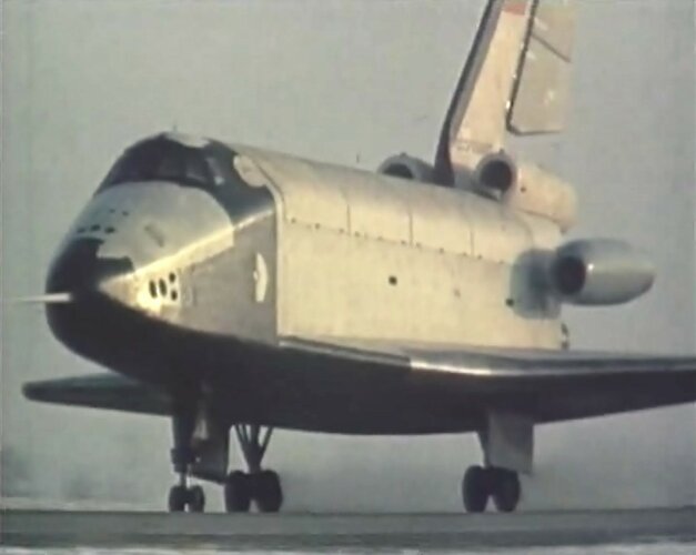

1984 December 29: The prototype of the Buran orbiter, designated BTS-002 GLI, conducted the first taxi tests on the runway in Zhukovsky. The crew was Honored Test Pilot of the USSR Igor Petrovich Volk and test pilot Rimantas Antanas Stankevičius.

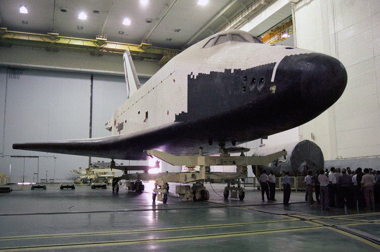

The Museum Complex of Verkhnyaya Pyshma (Sverdlovsk Oblast) has started restoring the legendary Buran spaceship - Izdeliye 2.01, the only flying copy in Russia. In a year's time, it will become part of a large-scale exposition about Soviet cosmonautics.
✔ The hull is being scanned to recreate lost parts: engines, fairings and glazing.
✔ Drawings from the 1980s have been partially lost - restorers are working with archival data.
✔ A separate pavilion is being built for Buran with exhibits of the Energia-Buran program.

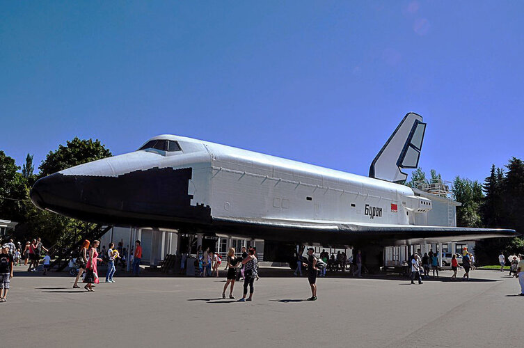

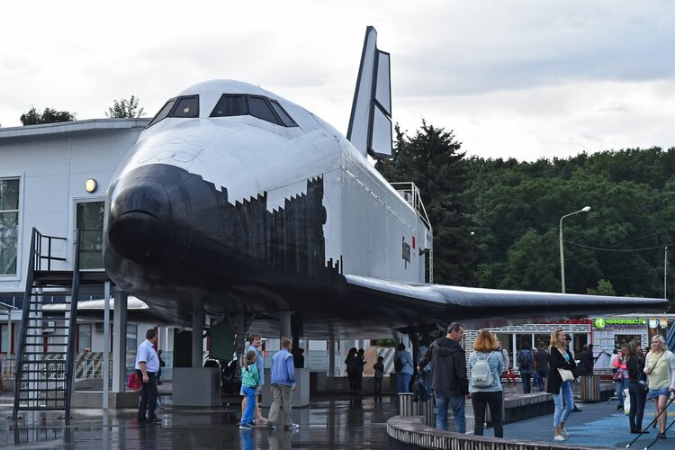

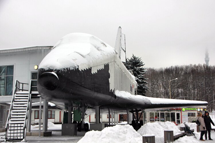

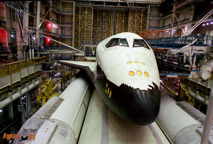

:oops:
What happened to the underside of the nose? Is it a non-original part?
If you mean the nosecap that's sticking out it's because the VDNKh orbiter does not have any silica tiles and is just painted to have the same pattern. The nosecap (like the wing leading edge panels) simulates the shape of the reinforced carbon-carbon part of flight-worthy orbiters, so it's meant to be flush with tiles that this orbiter doesn't have.

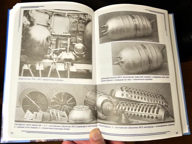

Book “Fuel Element Based Power Installations for Lunar Orbital Vehicle and Buran Orbital Vehicle” by Sergey Khudyakov, an honored labor veteran of RSC Energia.
  • razrabotka-energoustanovok-na-osnove-schelochnyh-toplivnyh-elementov-dlya-lunnogo-orbitalnogo-...pdf
