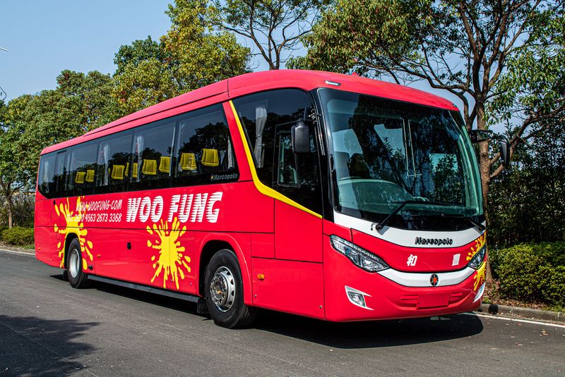

In the first quarter, Marcopolo exported 369 vehicles assembled in Brazil and produced 371 buses in other factories maintained abroad. The volume represented 27% of the company's total production in the period. In terms of revenue, exports injected R$370 million into the cash flow, approximately 39% of total revenue in January-March.
The company is based in Caxias, but has factories in several countries, including China, where it has already delivered 60 buses to Hong Kong alone in 2024. Since 2012, Marcopolo has been supplying vehicles to the Chinese market, selling almost 700 units in that period.
"The factory in China is ready for the mass production of several solutions developed by Marcopolo, and this is possible thanks to the continuous investments we make in innovation and technology, both in the country and in the company's other operations," says José Luis Moraes Goes, the company's director of international operations and foreign market sales.
Among the recent innovations developed by Marcopolo at the Chinese plant is the Audace Fuel Cell, a hydrogen fuel cell-powered bus, considered a case study in innovation and sustainability.
China is a market that invests in technologies of this nature and has a fleet of more than 20,000 commercial vehicles in operation, which demonstrates the vast field of opportunities ahead. In addition to the Audace Fuel Cell, Marcopolo is investing in other electric and hybrid propulsion solutions, aligned with the global challenges of decarbonization and its impacts.

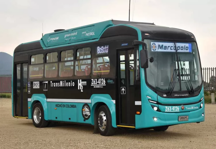

Specifications
The bus is powered by hydrogen and operates with a fuel cell and an electric battery, so its only waste is water and, like electric vehicles, it does not generate noise pollution. The low-emission hydrogen comes from a PEM technology electrolyzer with 165 kW of installed power that can produce 23 tons per year and is powered by a system of 2,000 1MW photovoltaic panels installed at the Green Móvil Logistics Center in Bogotá. Additionally, there is a backup alternative from the National Interconnected System (SIN) with REC certificates, guaranteeing that its origin is exclusively from renewable sources. The hydrogen station can charge the bus in less than 10 minutes and since the vehicle has a storage capacity of 30 kg of hydrogen, it has a range of more than 450 km with a single daily recharge, reaching a maximum speed of 90 km/h.
With this project, which to date has had an investment of more than 2.5 billion, Marcopolo Superpolo reaffirms its commitment to mobility, technological progress and innovation in the country. Additionally, the company expects to invest 1.5 billion dollars for the adaptation of the plant, thus confirming that this investment in infrastructure and technology represents a significant step towards the creation of a more sustainable and resilient transportation ecosystem in Colombia.
This commitment is also due to the latent tendency of the Colombian market to move sustainably, contributing to the environment, which is reflected in the significant growth in Colombia for acquiring vehicles with this technology. According to data provided by Andemos, the category of hybrid and electric vehicles in the country registered an increase of 13.1% in 2023 compared to the previous year, reaching a total of 31,500 vehicles sold, demonstrating a boom in the awareness of Colombians about the importance of environmental sustainability in the transportation sector.
It is estimated that, with the implementation of hydrogen-powered buses in Bogotá, a reduction of 1,083 tons of CO2 emissions per hydrogen bus (zero emissions) will be achieved for eight years. This is equivalent to planting 73,000 trees.

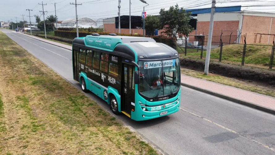

Specifications

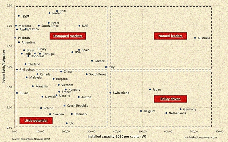

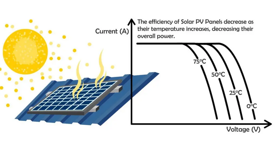

Although solar panels absorb energy from the sun, hotter temperatures actually make them less efficient.
Photovoltaic solar panels work by absorbing light energy and using the energy to 'excite', or energise, electrons.
An electrical field is then created across the layers of silicon in the cell, allowing the electrons to flow as electricity.
The greater the intensity of the light, the greater the flow of electricity.
But the hotter the panel is, the greater the number of electrons that are already in the excited state before the photon hits, reducing its efficiency.
Higher temperatures also increase the electrical resistance of the circuits that convert the charge into electricity.
Modern hybrid solar panels are designed to suffer less from the heat, but they can still lose 10 per cent of their rated efficiency on hot days.
This is part of the reason why Cornwall is the best county for solar energy in the country, home to over 8,000 solar sites.
It has over 15,000 hours of sunshine annually, but typically stays fairly cool allowing for the solar panels to work efficiently.

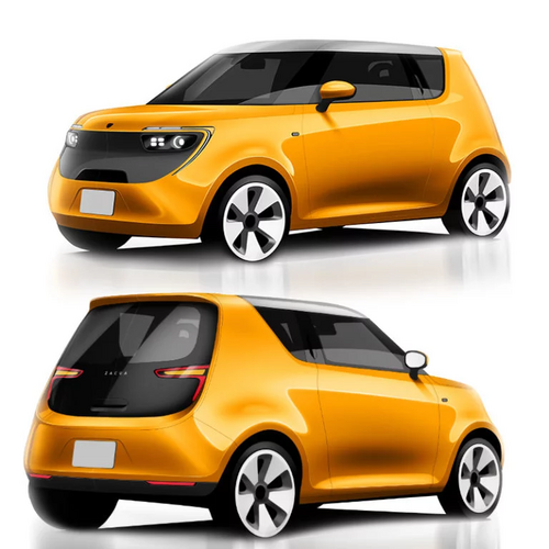

Concept Design​
One One Lab design team has the task of designing a completely new and fresh identity for the Mexican company. The layout and chassis couldn’t be touched the automotive styling process had to respect the existing base. And here is where we see the importance of style above other factors.
Clean, young, simple and elegant where the words that ruled over this automotive design process. Removing unnecessary elements not only reduces costs of production but can actually enhance the design. Having hidden A pillars, a different color hatch, front end and roof opens up the field of personalization. The result is a small cheerful little car with a unique identity that embraces the concepts of, affordable, simple, small, electric, elegant and friendly
