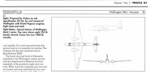

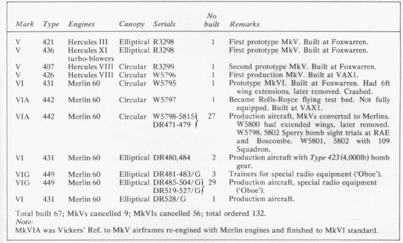

The ultimate plan was for a remote control 4 gun tail turret aimed via periscope from the pressurised crew compartment.
From Profile magazine.

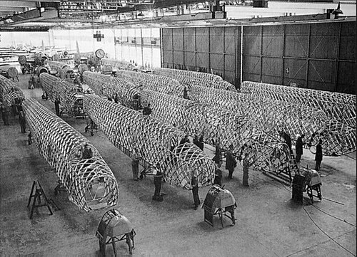

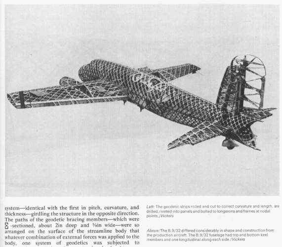

The Isogrid construction of the fuselage is an interesting detail seen in this picture...

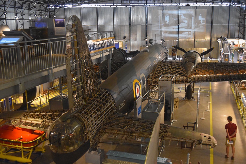

Here's the Brooklands 'Loch Ness' Wellington partially uncovered, revealing all that juicy detail (I'm an engineer, this stuff appeals to me).
3006 Brooklands Display Hall
