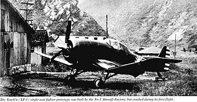

Hi!
http://cwlam2000.0catch.com/index.htm

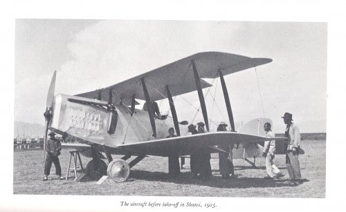

Fresson Fr.FBI Biplane
On 20th September 1925 Ernest 'Ted' Fresson's own aircraft the Fr.FBI undertook its first flight at Tai Yuan Fu, Shansi, China.
In 1922 a Chinese War Lord had imported a dismantled Avro 504K and 'Ted' Fresson, a former WWI pilot, assembled it for $250 over a period of a fortnight. This was followed by two more years of test flying various Avro's and Curtiss aircraft in and around Hankow.
In 1924-25 Governor Yen, the Chinese Governor of Shansi Province, asked Fresson to establish an aircraft factory at Tai Yuan Fu, within the walls of the local Arsenal. This was in an area surrounded by warring local factions and was not particularly safe area to work.
Fresson began designing the Fr.FBI based on the Armstrong-Whitworth FK.8 design and ordered materials from the Aircraft Disposal Company in London. The design was drawn up in Shanghai and construction began in the spring of 1924.
The Fresson design called for two separate cockpits behind the main wings and had a revised Centre of Gravity. He was assisted in the build by a German aero engineer, and English maths expert who worked on the stress aspects and a Chinese carpenter called Loh.
Although built in the Arsenal confines, a separate airfield was built six miles north with an 800 metre runway for testing.
After several successful flights, passengers were carried. There was no further production of the type due to Civil unrest and Fresson returned to Britain to found Highland Airways in Britain.
Attached are photo's of the aircraft under construction (Clegg) and the machine prior to its first flight (Fresson).
For more on Ted Fresson see http://www.undiscoveredscotland.co.uk/usbiography/f/tedfresson.html
Sources:
Rivals In The North (Peter V. Clegg) published by P Clegg 1989 ISBN: 9781872347028
Air Road To The Isles (Captain E E Fresson) published by David Rendel Ltd 1967 no ISBN (a 2008 edition has ISBN 0951895893)

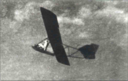

What is the identity of the apparently unpowered aircraft illustrated in the last photograph (image036) in the first post?
That is Wong Tsu's XG-1 troop-transport glider. Like the three trainers designed by Wong, the XG-1's structure was created largely from bamboo mat composite boards.
AFAIK, the technique was developed by Y.-C. Fung at the Chinese Bureau of Aeronautical Research. To create this 'ply-bamboo', Sinocalamus affinis stems were split into strips, interwoven into mats, layers of bamboo mats were then soaked in resin and pressed together.
One source says that the same technique was used to make the XG-1 spars ... but I wonder if they wouldn't have used a bamboo-wood veneer composite for the spars?

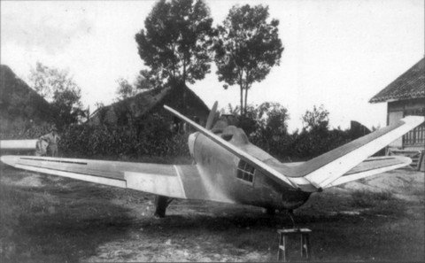

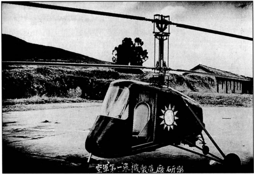

I know the first one. The helicopter is named Chu CJC.3. He was build in Taiwan.
Servus, Maveric

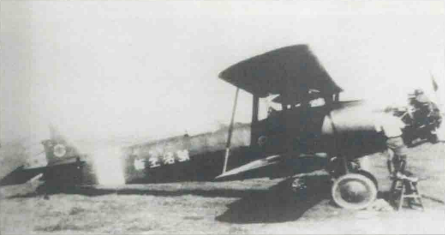

My dear Blackkite,
the last aircraft was Bejing-1,and it made its maiden flight in 1958,the two and three
are still mysteries.

From "aviastar.org helicopters"
Your helico is the "chu cjc3"
but it was not "prewar it was build in 1952
Bye"

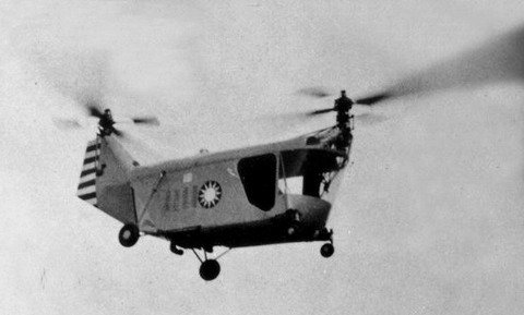

This helicopter has been developed after the war as you expected.
A very modern design. Anyway, you offer us valuable information, thank you very much.

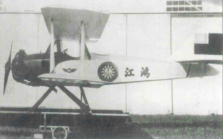

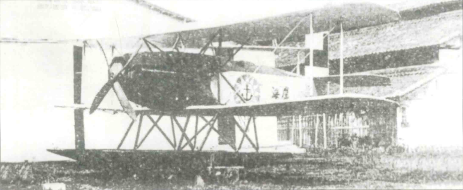

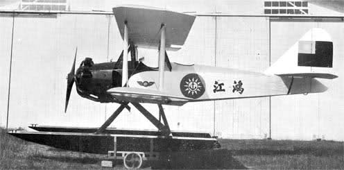

How I forget this company,

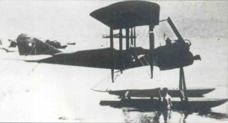

I know it from long time ago,the Naval Air Establishment was formed in 1918,and re-allocated
to Changai in 1931,the Chiang Hung was two/three seat recce biplane seaplane intended for
Chines Navy,also designed the Chiang Gaen,a two seat recce/military trainer biplane,all of
them were built.
Also developed Chiang Hau,Nin Hai,DH-6 looks like,Beeng,Char,Ding,Wu and Yee,here
is all details and we can conclude the two mysteries aircraft;
Aircraft produced include:
Chiang Hung (1930) - 2 or 3 seat touring plane and reconnaissance aircraft
Chiang Hau (1932) - powered with single 165 hp Wright Whirlwind engine
Chiang Gaen
Nin Hai
DH.6 like seaplane
Beeng (1918?)- tractor biplane/float fighter bomber with single 360 hp prop engine
Char1918 - 2 seat primary trainer seaplane
Ding (1934) - 2 seat bombing/torpedo seaplane using a single 360hp Rolls Royce engine
Wu (1918?) - general purpose observation aircraft
Yee (1918?) - 2 seat advance trainer and variant of Char seaplane
http://all-aero.com/index.php/69-manufacturers/manufacturers-n-z/7224-naval-air-establishment

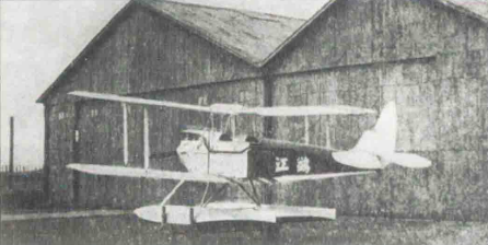

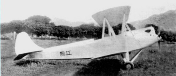

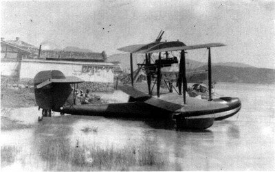

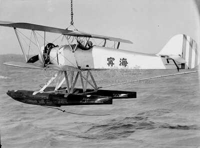

there is unknown design,the Foochow Ning Hae 2,does anyone hear about it before ?.
"Ning Hai" was actually the name of the Chinese Navy light cruiser that carried the airplane in question. The ship's name was painted on the sides of its aircraft, hence the confusion.
Originally, the Ning Hai carried a Japanese Aichi AB-3 seaplane. But the aircraft had to be disassembled and stowed after use, because it lacked folding wings. This limited the plane's usefulness.
So Mar Te-Tsu of the Navy yard at Shanghai designed and built a replacement in the 1934-35 timeframe. The Hsin (Xin) was a twin-float, single-seater powered by the same 130-hp Gasuden Jimpu radial engine used in the AB-3. It generally resembled its predecessor except that the new airplane had folding wings.
My source is A History of Chinese Aviation: Encyclopedia of Aircraft and Aviation in China Until 1949, by Lennart Andersson (Aviation Historical Society of the Republic of China, 2008). It is an excellent book and, as far as I know, is still available from the AHS of ROC, P.O. Box 112-129, Taipei, Taiwan, ROC (fujinping@gmail.com).
Thank you Iverson,
but as you see,in Wikipedia they are two different aircraft,Hsin-1 Ning Hai 2 and
Foochow Ning Hae 2
https://en.wikipedia.org/wiki/Hsin-1_Ning_Hai_2
https://en.wikipedia.org/wiki/Foochow_Ning_Hae_2

I doubt that they are different. The absence of a Wikipedia entry is not especially strong evidence.
Since "Ning Hai" is the name of the parent ship, it is surely more likely that "Ning Hai 1" refers to the ship's first aircraft, the Aichi AB-3, while "Ning Hai 2" refers to the ship's second, Navy-built airplane, "Hsin", that replaced the AB-3.
This seems likely because the AB-3 was, in fact, built specifically for the small, Japanese-built "Ning Hai" (see https://en.wikipedia.org/wiki/Aichi_AB-3 and the book cited above).
"Foochow" is just an alternative transliteration of the name of the port now called Fuzhou. Fuzhou was the home of the Foochow Arsenal, the first and main Chinese navy yard (see https://en.wikipedia.org/wiki/Foochow#Seaport and https://en.wikipedia.org/wiki/Foochow_Arsenal). So the "Foochow" in "Foochow Ning Hae 2" probably just means that the plane was built by Navy personnel from the Navy's engineering department at the Fuzhou yard.

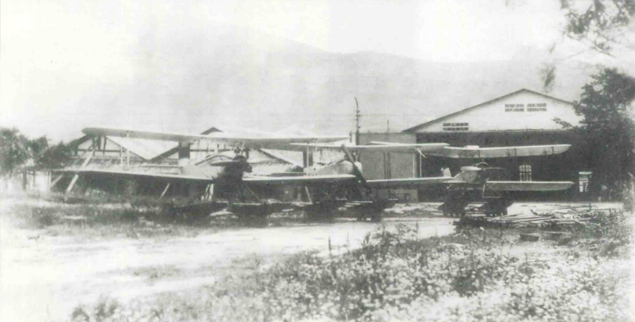

what about Guangzhou series,are them an aircraft or airship ?, (No. 51,53,54,56,57,58,59
& 74).
& 74).

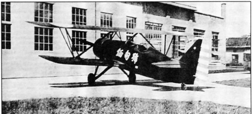

"Guangzhou" is the city called "Canton" in English. The Aviation Department of the autonomous Canton government set up a factory that built aircraft from 1928-37. They were of various designs and in several cases were based loosely on Western designs.
Late in 1928 the factory built its first airplane, a three-seat biplane called "Chengkung" (Success), powered by a Curtiss OX-5 V-8. It spanned 9.75 m (meters), was 7.32 m long, and stood 2.67 m high. It weighed 950 kg empty and 1360 kg loaded.
In 1929 the factory built four airplanes, called Yang Ch'eng ("City of the Five Rams", i.e. Canton) 51-54. Yang Ch'eng 53 spanned 9.82 m and weighed 1089 kg loaded. It was a two-seat trainer powered by a 180-hp Hispano-Suiza V-8.
In 1930 the factory built another four aircraft, Yang Ch'eng 55-58. Yang Ch'eng 56 spanned 10.98 m, was 8.3 m long, and 3.1 m high. It weighed 793 kg empty and 1497 kg loaded. Yang Ch'eng 57 spanned 9.82 m and also weighed 1497 kg loaded. Both were powered by 200-hp Pratt and Whitney Wasp radials and carried a single rear-mounted machine gun.
By 1933, about 22 aircraft of various types had been built, including four copies of the Avro Avian called Yang Ch'eng 70-73.
In 1934, the factory built Yang Ch'eng 74-78, loose copies of the Douglas O-2MC.
In 1935, it built at least one parasol monoplane based on the O-2MC (designation not specified).
The Canton government then ordered six two-seat light bombers powered by 200-hp Wasps and resembling smaller Vought Corsairs. These weighed 725 kg empy and 1139 kg loaded.
At the same time, the government ordered a single-seat fighter powered by a 300-hp Wright Whirlwind.
The total production of Yang Ch'eng aircraft is thus thought to have totaled 60+.

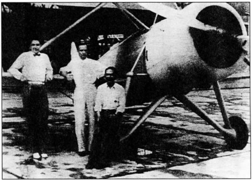

1. First assembled in China, "Fusina" K.L. Zakharchenko (left) and his colleague and friend S.Kh. Day.
Chinese General Zhou. is sitting on the wheel. May 1936
2. Serial "Fusion", judging by the inscription on
fuselage assembled in Burma. Photo of the 1940s

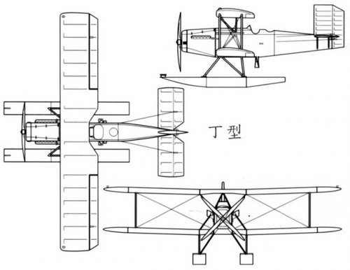

己1/2.png

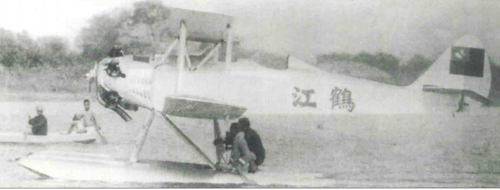

Mawei type-Hsin 1 "Ninghai No.2"---1 built(copy Japan Aichi AB-3, equip in Chinese navy ship)
River Crane---1 built(Nov 1934)

Jiangnan manufacturing Bureau
Shanghai Type Geng 1/2 sea-reconnaissance---2 built

Yang Ch'eng(羊城號) series---60 built(Aircraft designed and made in China,various appearances,think of the aircraft made by the three Baltic countries,various appearances.)

XP-0---9 built(Fighter designed and made in China)

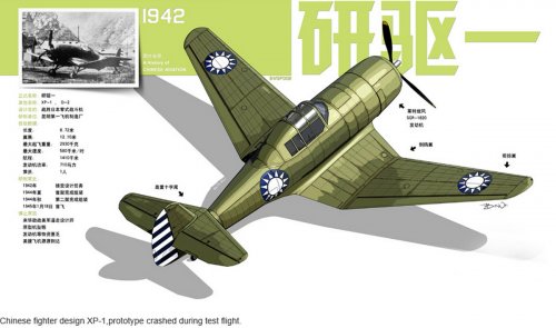

XP-1---2 built(Aircraft designed and made in China)

Hummingbird A helicopter---1 built(Helicopter designed and made in China)
Hummingbird B helicopter--- 2 built(Helicopter designed and made in China)

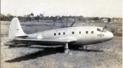

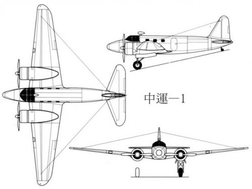

Chung Yun 1(中運 1) Transport---1 built(Transport designed and made in China, refer to Airspeed AS.6 Envoy)
Chung Yun 2(中運 2) Transport---1 built(Transport designed and made in China)

Ta Kung Pao(大公報號) Glider---35 built(Glider designed and made in China)

羊城號 = Yangcheng series of trainers
-- https://daydaynews.cc/en/history/83430.html
中運 1 = Chungkuo 1 (China 1) transport aircraft, aka 'Loyalty 1'
-- https://www.secretprojects.co.uk/threads/chinese-transport-aircraft.7549/#post-65707
中運 2 Chungkuo 2 (China 2) transport aircraft, aka 'Loyalty 2'
大公報號 Glider = Ta Kung Pao No.(?) 'advanced cabin glider'
-- I assume that these gliders were in some sponsored by the newspaper of the same name?

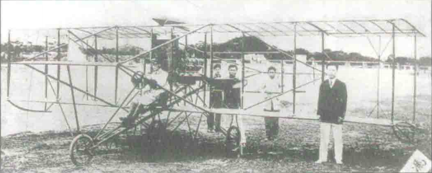

Dear bunnystar211, thank you a lot for your digest.
On the first photo there is Fong Yue-1, not two. Fong You (Feng Ru) has built two similar aircraft, No 1 and 2. The first one burned in hangar in 1910. Both were built in the USA, so I doubt they are "chinese aircraft". The No 2 airplane Fong Yue returned to China in February, 1911. 25 August, 1912, Fong Yue crashed during demonstration flight on this airplane and died.

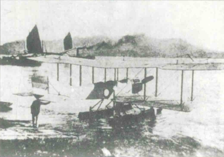

I'm really doubt about year of Tangen seaplane, it looks too modern for 1910. Could you, please, give me the source
Is there any standard transcription rules for Chinese language, like Polivanov's rules for Japanese? The transcription of names in different sources differs drastically. FengRu = Fong Yu, Jia = Char (!), Yi seaplane = Yee seaplane, Chenggong = Chengkung, Geng = Keng and so on.
Sometimes it's difficult to recognize which aircraft is written about.
"River Crane" it seems the same as Fuzhou Chi-1 "Chiang Hung", but according to the article "Aircraft construction in the Сhinese Navy" (Flight, 1934, No. 10, pp. 211-214) it was built in 1930, not 1926. Is "1926" the correct date?

It seems, only the second AB-3 (Ninghai, Hsin-1) was built in China in 1934. The first one was just bought from Japan. Or am I mistaken?
