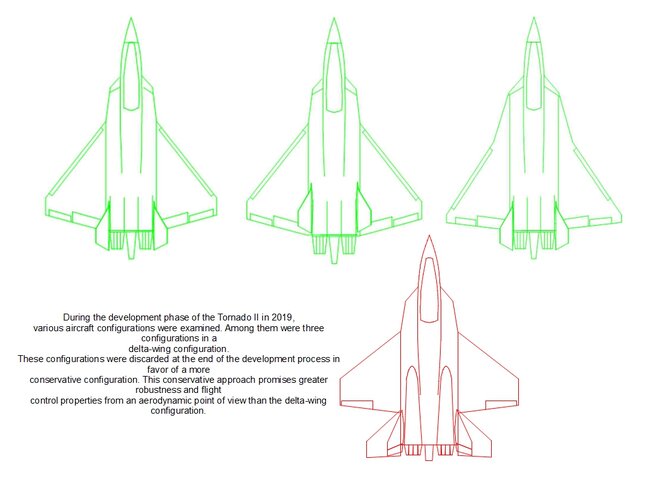

Thank you kqcke for you and Pioneer for your pictures. I had already looked at various configurations in 2019 and then came up with the theory shown in the next picture. What do you think? Is this thesis justified?
And I didn't want an more stealthy Eurofighter. ;)

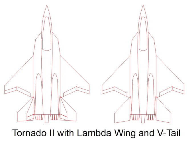

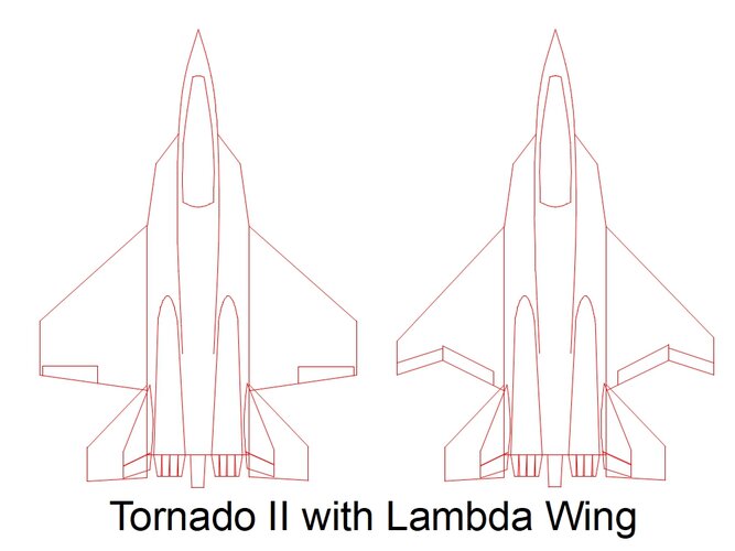

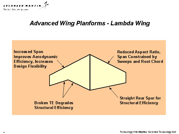

On the aircraft, the Lambda Wing would look like this with the same wingspan. However, the Lambda Wing would reduce the wing area.
Edit: now a V Tail and we have GCAP xD
But given the Lambda Wing allows for more edge alignment
Yeah quite similiar but you didn't had to do that.

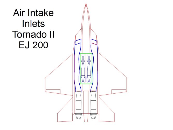

Anyway what was your plan for the air intake?
Right now it looks like fixed inlets without an S-shaped duct.
Edit: Based on the speed goal a DSI should do the trick with the S-shaped duct.

Yes, you are right at the moment it looks like fixed inlets without an S-shaped duct. I'm afraid due to the internal weapons bay the course of the inlet ducts remains relatively straight.
I guess there 2 solution for it. 1. F-35/J20 DSI inlets or yf-23 Style (also possible with DSI). Engines could get w Stealth Treatment but in that area one should ask F119Doctor.
And as I said, I checked the design of the IWB again and found that the dimensions mentioned were not correct, far too big to be able to install the inlets, for example. Please excuse this mistake. The height of the IWB is reduced to approximately 70 cm.

For the Lambda Wing we could use LERX or chine to get the lost wing aera back.

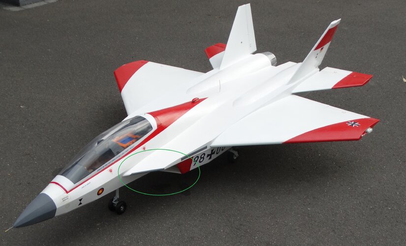

In my opinion, LERX are already available (see green circle in the picture).
Yes but this would (could) be an extension / larger one as we don't really want 90° places on the plane. In that Sense its not far from a double delta / cranked arrow (based on the lambda). I was also a little unsure If there where some LERX as it was kinda hard to see with mostly a bird view.

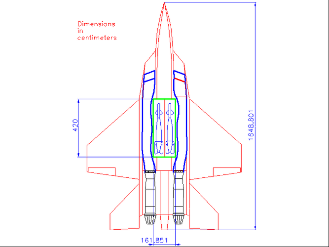

Well then I want to reveal how small the internal weapons bay has now become. Unfortunately, I'm afraid it won't get any bigger, or the plane will be made larger overall.
Still large enough for atleast 3 MK.84 or 9 Amraam or 3 JSM. Short you got around 50% more space for ammunition over F-35B for the IWB and thats still without smart use of it.

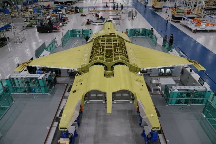

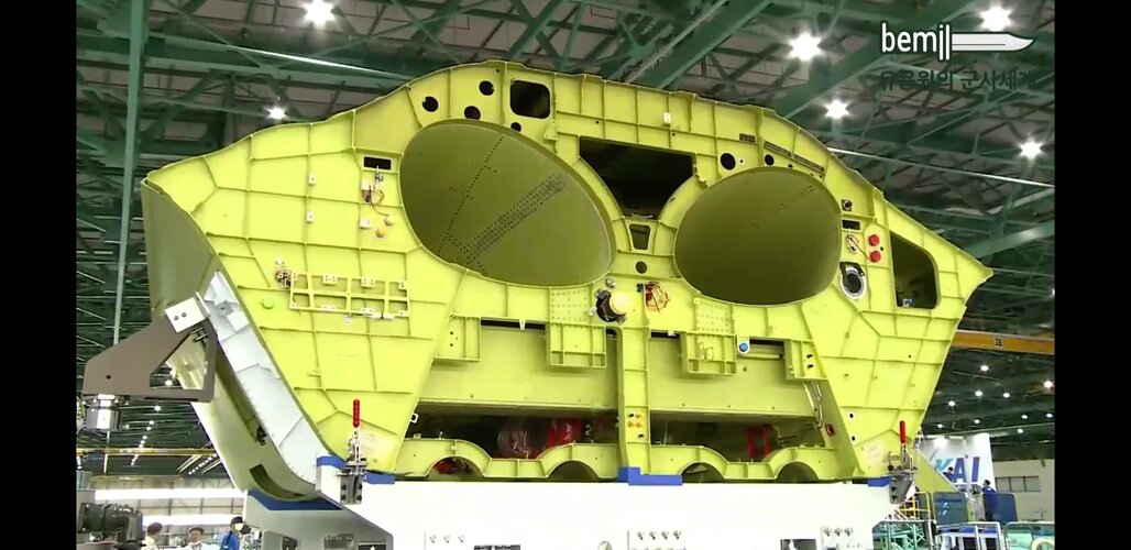

I would highly recommend you to take a closer look at KF-21. Due to the use of the same engines it is the best reference you can get. There is no way for a stealth fighter in this category to have such a huge weapons bay without severly compromising other performance aspects (e.g. range).
As I mentioned earlier in the thread, the KF-21 is not a reference for me. Not because I didn't notice it in time and not because it doesn't have an internal weapons bay.

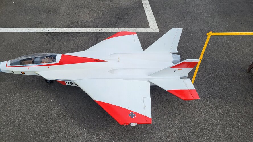

Hi dear forum members, especially to ItalianAFDFail, kqcke for you and Nick, thank you very much for the last comments, very interesting. Unfortunately I have to take a break for a few months because I have to move from Cologne to Berlin. I'll get back to you as soon as I can.
Here is a short video of the Tornado II demanstrator as it could sound with two EJ-200s. ;)
