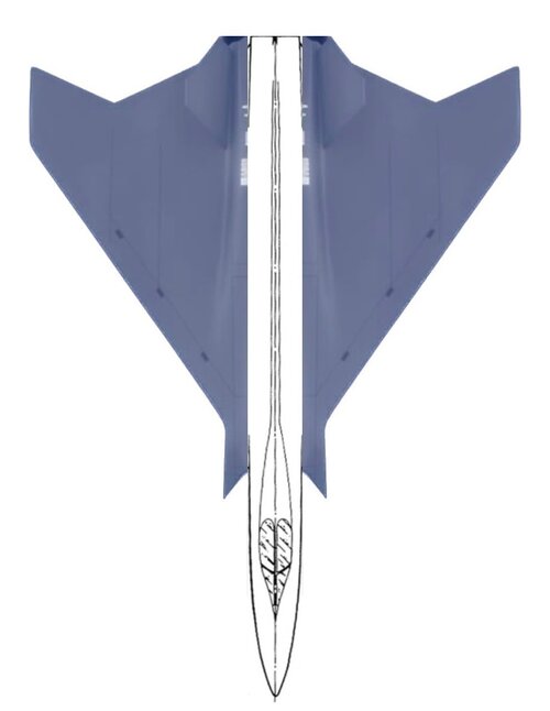

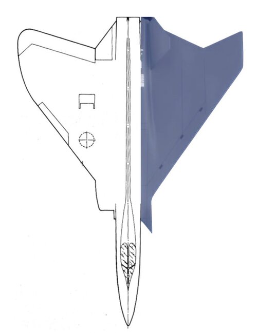

Might I suggest the Douglas F4D as a point of departure?
I think you mean the F5D Skylancer?
Certainly wouldn’t be a bad starting point. With an F414 EPE or EJ200 growth derivative instead of the massive J57, that would free up internal volume for more fuel (already quite generous at 4+ tons) and produce a ~7 ton empty fighter with a small weapons bay and good range.
F5D Standard aircraft characteristics:
In a modern LO fighter flavor with Tempest style twin tails and cranked delta wings it would be in the right ballpark… similar to some of the Rolls Royce renderings:
Gotta admit, the F4D/F5D are probably my favorite late-50s/early-60s Navy fighters.
edit: And looking at it, the F5D might actually be the better starting point than even a Gripen...

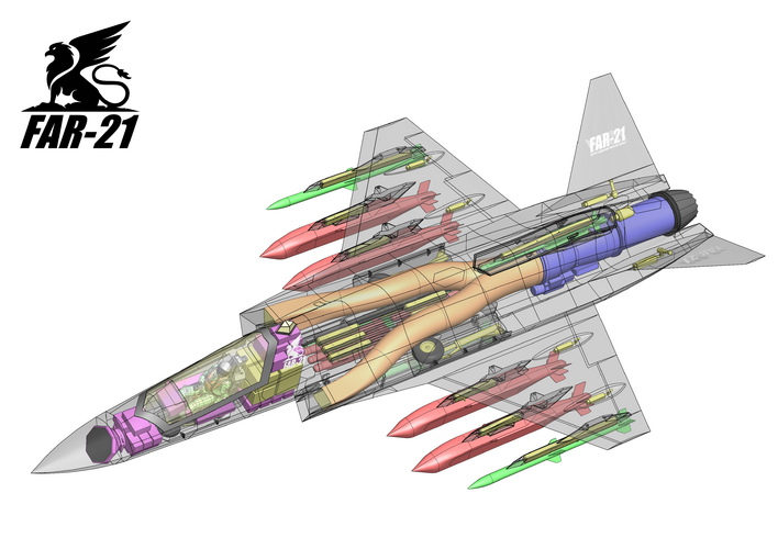

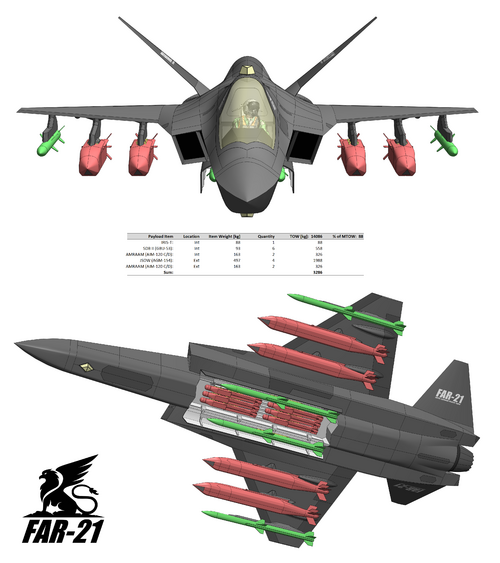

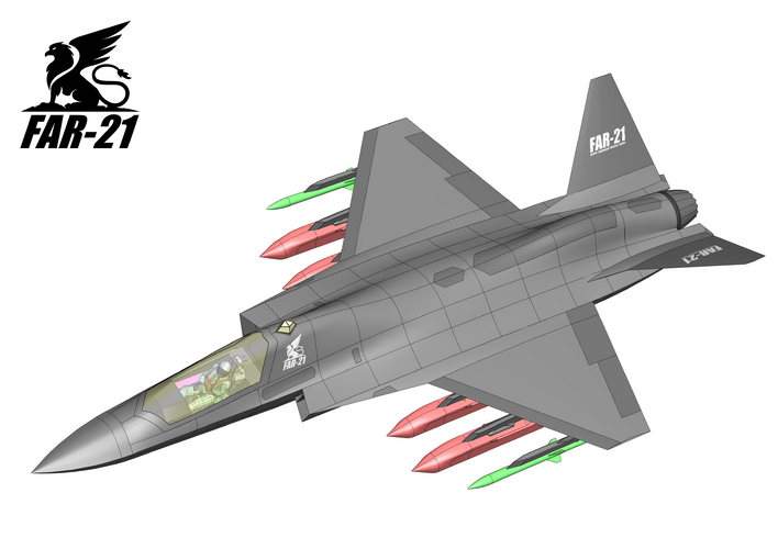

Some updates on the 3D model...
I've created some air-to-ground weapons* and added pylons for external weapons carrige (beast mode). Furthermore, a cockpit/pilot, radar, avionics and other systems and details. However, I haven't had time to integrate a retractable refuelling probe yet (probe-and-drogue).
With the ordnance depicted (3286 kg) and full internal fuel (3200 kg / 4000 l), the takeoff weight (14086 kg) is 88% of the projected maximum takeoff weight (16000 kg).
*SDB II / GBU-53/B
*AGM-154 (JSOW)

I really missed fuel tanks.
When we want a modern fighter, which uses the latest technologies, but at a low cost, the cubic volume struggles with all the requirements.
I wouldn't fight with all the requirements and I would try to focus on keeping some of them with superlative characteristics, so that you can complete some missions with really superior characteristics without worrying about fulfilling them all.
For example, we have maneuverability, combat load, cost, speed and range.
I would focus on range and autonomy, combat load.
In this aspect, if you include a version, in this same design of yours, canards, move the wing further towards the end of the fuselage, move the engine to the outer back and hide them with trapezoidal empennages.
This will free up almost the entire fuselage for electronics, fuel tanks and weapons bays. Even think of the weapons bay as a plug and play switchable module for sensors, weapons or even fuel tanks like Textron's skorpion.
Don't neglect the old air intakes by tapering them towards the nozzle, where more equipment can be installed, including Radar antenna edges...
A version of this would be interesting, and you will see that it would result in different characteristics, even with a small fuselage.
Your drawing was beautiful and I saw that it included a lot of study!
But I believe that the plane's airframe structure still stole internal space. Your challenge is very big.
It would indeed be very interesting to try some of these suggestions. Yes, it would be a different plane, but it could be a version of his own proposed design.
You will notice that by pushing the engine towards the (Dorsal Position), the air intakes that previously took up a lot of internal space are freed up. Air intakes can become new systems or weapons bays if you integrate them into the radar root. This solves the previous proposal of inverted conformals above the wing if you use these plane cheeks. Yes, you will be concerned about the interruption of airflow when the fighter is in a steep attitude, but install auxiliary gills on the belly and wing roots just to supplement the flow when necessary and controlled by the FBW. The internal area will grow, regardless of what you have already designed, around 30%-40%....this is superlative and will give this translation of capacity in your model without similar competitors. Think, even in front of these cheeks, you can even install an expansion of the radar antenna....larger antenna area, greater capacity even if the hardware is the same....don't let the aircraft's nose be the limiter of your radar ....and again...the old air intake caverns, missiles fit there...the canards will allow rebalancing the cg with the FBW...
You will notice that by pushing the engine towards the back, the air intakes that previously took up a lot of internal space are freed up...
I don't get what you mean, the engine is already all the way back!
The only air intake type that would free up a large portion of internal volume is a dorsal intake. However, pros and cons of dorsal intakes were extensively discussed in this thread... I decided against for the explained reasons.
Yeas Dorsal intake.....

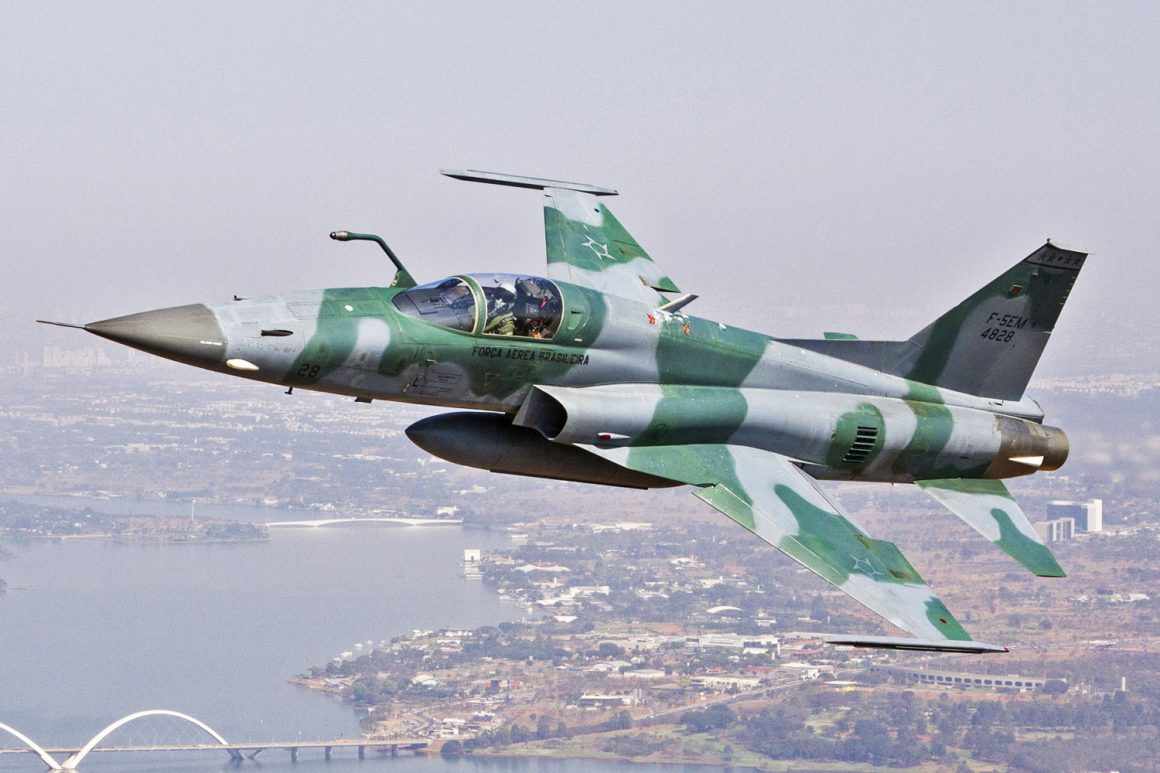

See the F-5, install automatic ventilation gills in the belly (on the ground) in the belly of the plane right in the direction of the air flow when the fighter is in a high attitude. Auxiliary airflow is restored directly to the engine whenever the fighter is threatened with a flow cut.
The auxiliary air Inlets of the F-5 are in the furthest aft end of the intake duct just before the compressor face of the engine. You don't want that on a stealth aircraft. The purpose of serpentine shaped ducts is to prevent direct line of sight to the compressor blades and disperse radar waves, thus lowering RCS.
Aside from that, those kind of auxiliary air intakes are intented for low speed operation during takeoff and landing, not high speed maneuvering.
try it. You don't need direct ducts although the lower distance to the edge of the engines on the dorsal position would be negligible, as well as the grille would only be opened in the maneuver controlled by the FBW. The flow does not need to be large, just complementary during the aggressiveness of the maneuver and can remain closed almost all of the time. In any case, it would be a very small duct and in no way superior to the discretion of the original ducts I designed. It's a new approach, for a new challenge... The grille below the plane is only opened during the maneuver and is necessary, controlled by a computer.

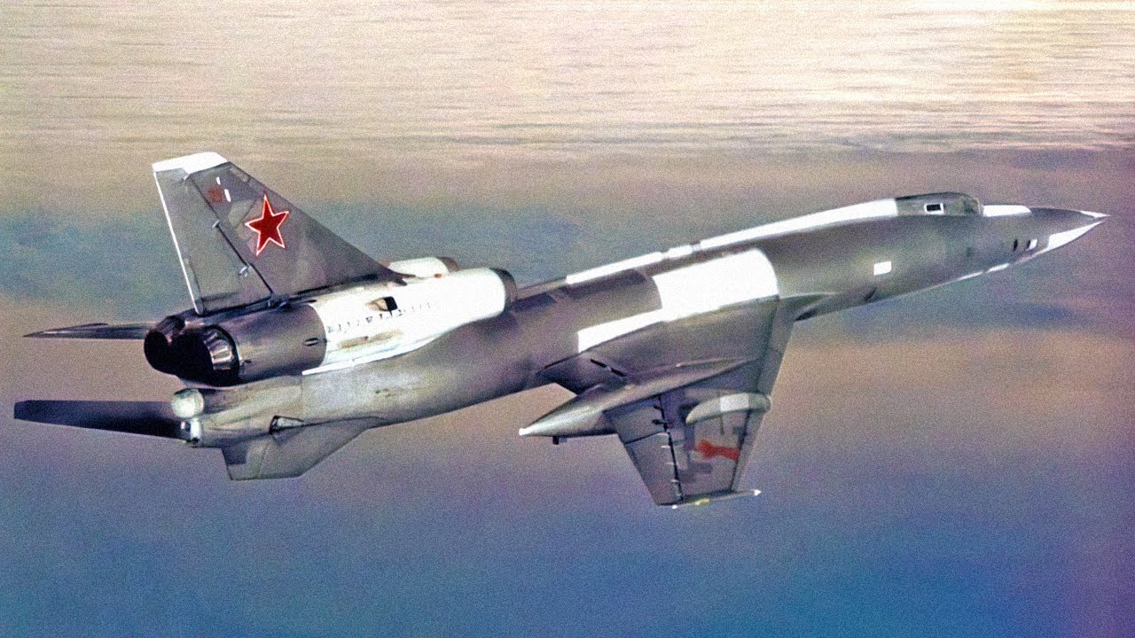

As a matter of fact, dorsal air intakes never made it into a supersonic fighter so far. And it's not because no one thought of auxiliary air intakes before ;)
The F-107 had a big dorsal intake, but that was positioned just aft of the cockpit. @VTOLicious I agree with you that a dorsal intake as proposed by @carvalho2008 (much further aft) would be problematic in a supersonic design.
Really? maybe yes maybe no. Supersonic speed is not limited by dorsal position, but rather the problem of reduced flow at high speeds to the engine. as colleagues have already recalled, the high attitude versus speed, at least in theory, is only achieved when in the flight envelopes and dogfight engagement, and the dogfight is limited by the pilot's G limits... the important thing is that in this scenario, the requirements of invisibility are already relaxed, as the combat is no longer in the BVR arena. Your drawing is wonderful and exemplary, really cool. But it would be interesting to explore these other possibilities. Do not be prejudiced or worried about giving up any requirements, as this would indeed happen, however, other superlative characteristics will appear in a compensatory way. The versatility of exchanging equipment, more abundant fuel and increasing the areas of radar antennas and missiles would be very great, whilst still maintaining practically the same external area through these tricks... this secret project room is the greatest example of great tricks that they died just for the question...if no one did it before, then it wouldn't be good...and conceptually, these tricks are actually simple...an automatic grid can change everything....
