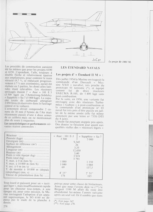

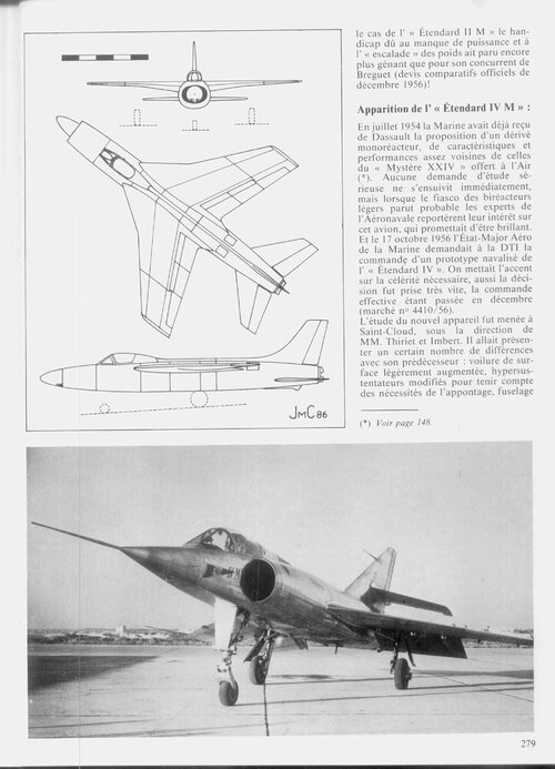

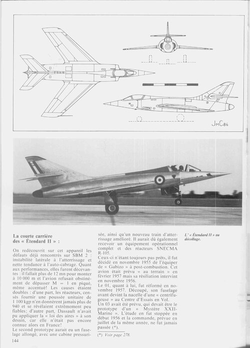

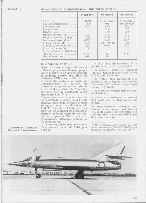

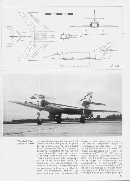

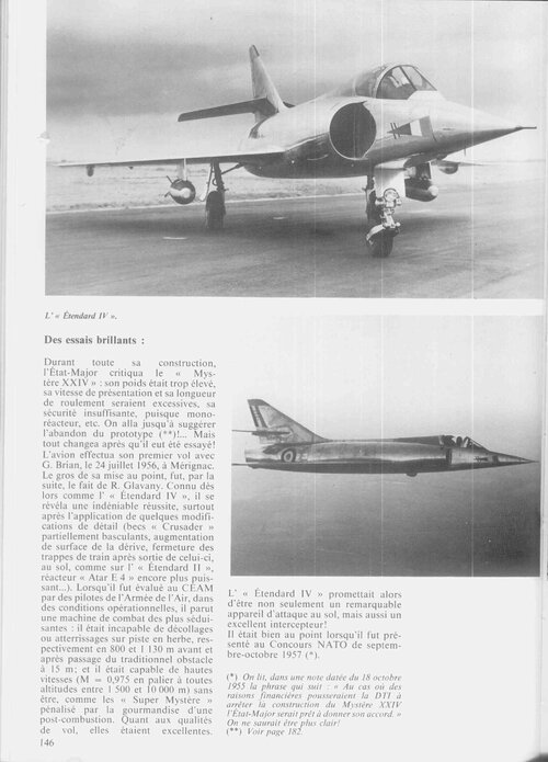

Ha ! I checked Jean Cuny old but still valuable books. I've found a few answers to that Etendard / Mystere nightmare.
Guess what ? There were two Etendard V ! TLAP was the second one, in the mid - 1960's. Which mean, there was a first Etendard V, in the late 1950's, member of the complicated family of Etendards - the II, the -IV and the -VI.

@NOMISYRRUC I think the answer is in the first picture posted by @Archibald (p.142): it states that Dassault was using even numbers only for its Mystère projects (Mystère XX, XXII, XXIV, XXVI). So no odd numbers.

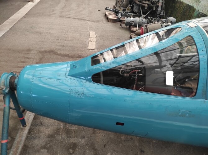

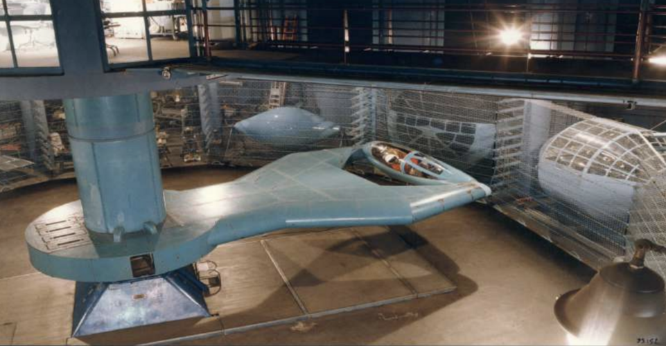

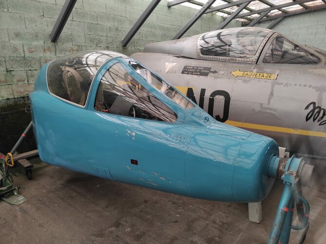

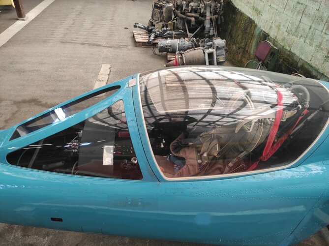

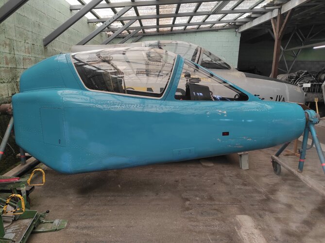

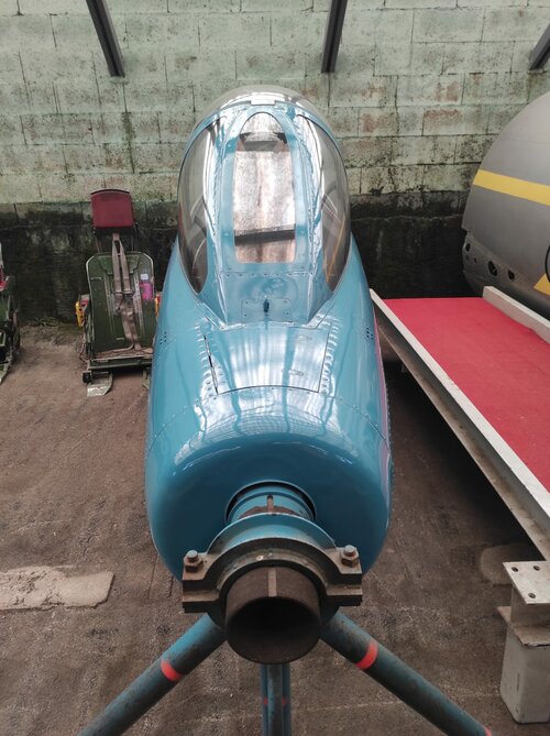

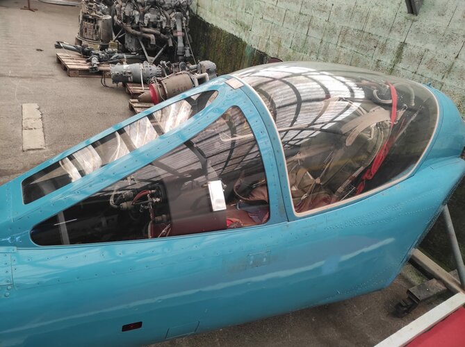

The Etendard II cockpit can be seen in a museum in Savigny-lès-Beaune (Burgundy region in France). It was one of the gondolas of the human centrifuge of the Centre d'essais en vol (flight test center) in Brétigny-sur-Orge (France). It is beautiful, in amazing condition, a one-of-a-kind piece of aviation history.
The first photo is a period photo of the centrifuge with this gondola.
