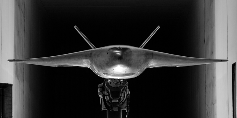

The team is currently designing an uncrewed demonstrator with a 45-ft wingspan and 1,000-pound payload capacity for the SPRINT program. The propulsion system includes off-the-shelf turbofan and turboshaft engines that would power the vehicle to a maximum of 450 knots true airspeed (KTAS).
The technology demonstrated in the SPRINT X-plane could be scaled to medium and heavy lift aircraft, creating a future family of systems. For example, Aurora envisions a manned, 130-ft wingspan aircraft with four lift fans and 40-ft payload bay. The FIW aircraft could meet or exceed the payloads, ranges, and speeds typical of fixed wing military transport aircraft while delivering the tactical advantage of true vertical takeoff and landing.

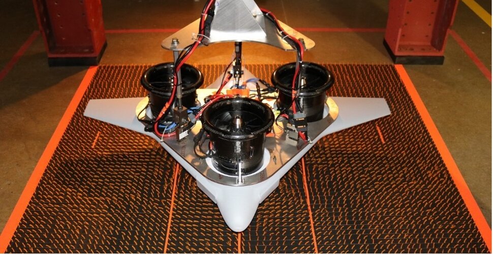

For the vertifan at least, the downwash was much more benign than either a harrier or F-35 - you wouldn't have someone walking under either of those in a hover!
View: https://youtu.be/zbXVjx_kqu8
At t=3:20 & 12:00 you can see a ground crewman walk under a hovering vertifan

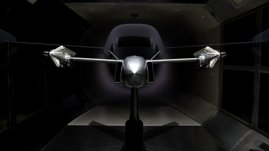

Another advantage of the quad-copter configuration is that they can shut off one or two outboard engines to improve loiter time (ala. Lockheed P-3 Orion).
Their website does mention being able to feather or even fold unused props in horizontal flight.
From the recent articles posted above it appears that Bell has done considerable work to reduce the potential parasite drag associated with the drive and folding mechanisms. As much as I am a believer in tilt rotor as a step forward in VTOL flight, I would have to think that the fan in wing competitor has an advantage if range is a primary driver. It will come down to how much 'VTOL' time and very low speed maneuvering weighs against cruise efficiency.
Conversion also. A fan in wing needs to manage the low speed that comes with transition. You are not going to pop the nose at near the vertical before the VTOL system take over (think at your cargo).
What that means is that your are constrained with over dimensioned wings, hence high drag during the cruise portion.
