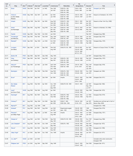

Surely enough, with 24 Essex (over 32 planned at some point) the USN was pretty lucky. Plus the three Midways, and voilà, only 2 different major carrier types. A pool of 27 carriers, indeed, was plenty enough to wait for the Forrestal in the mid-50's.
Although two Essex had been very badly crippled in 1945 and never really recovered from the kamikaze onslaught that holed them.
