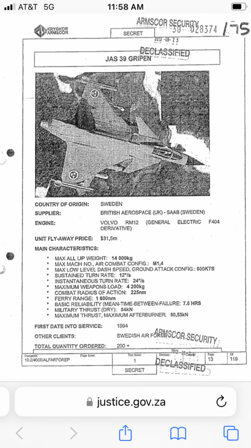

To be honest. I feel the Gripen.. or something Gripen sized is the most appropriate aircraft for most European air forces..
MAYBE an exception to the UK and French air forces given their distant territories and interest in overseas conflicts.. (although I think such a size is still more useful for them too)
other wise countries like the Netherlands, Germany, Austria, Romania, etc.. all their main problems are next door and most of these countries don't really need the range, complexities and operational expenses of a larger twin engined combat aircraft.
Arguably the same could be true for most other air forces in the world outside of the asia-pacific region.
Gripen is the perfect size, but I guess one factor against it is it being Swedish (less political influence).
Had the British marketed it, or something similar, it could have been more successful I bet.

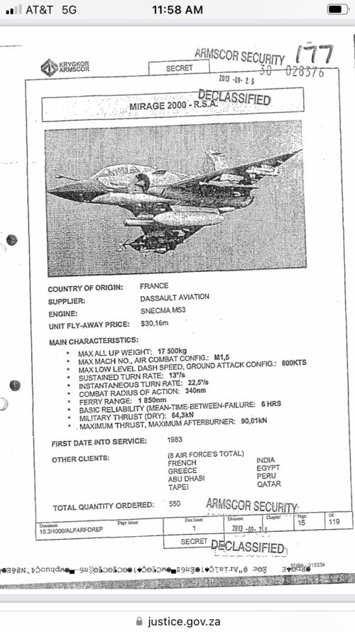

Beyond that I think one aircraft not mentioned as a competitor is the Mirage 2000. Its often compared to the F-16, and for good reason. But its length, empty weight, and operational costs.. put it much closer to the Gripen than the F-16. If it was a bit cheaper, perhaps it could have been more successful in global exports. I feel a heavily upgraded variant could still be very competitive today too.
Bingo.
The Mirage 2000 base, with better intakes and canards would've give Grippen a run for it's money. Cost was probably close to the F-16, but there is no political baggage as it was the case with F-16. Political baggage was a problem for a lot of possible buyers of modern military aircraft.
