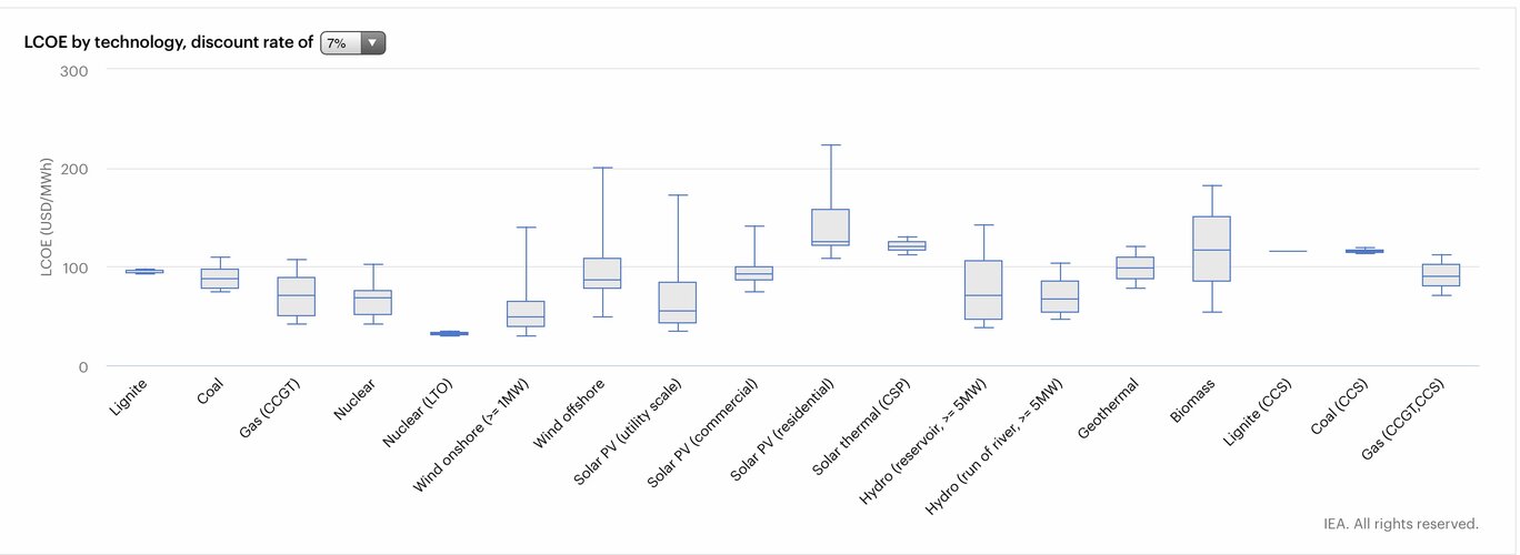

From the International Energy Agency’s latest report (emphasis mine):
Renewable energy costs have continued to decrease in recent years and their costs are now competitive, in LCOE terms, with dispatchable fossil fuel-based electricity generation in many countries. The cost of electricity from new nuclear power plants remains stable, yet electricity from the long-term operation of nuclear power plants constitutes the least cost option for low-carbon generation.”
Nuclear thus remains the dispatchable low-carbon technology with the lowest expected costs in 2025. Only large hydro reservoirs can provide a similar contribution at comparable costs but remain highly dependent on the natural endowments of individual countries.”
I attach figure ES.1 comparing the Levelized Cost of Electicity (LCOE). Note LCOE does not include transmission or distribution costs, so renewables will probably have much higher costs. And just as a point of interest - look at the highest cost - Residential Solar.

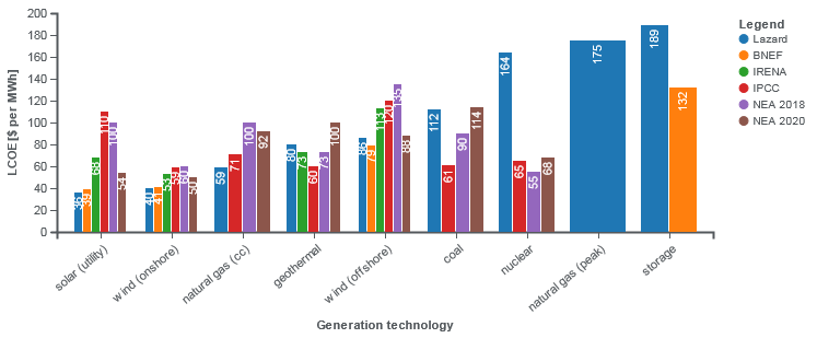

Yeah, but (all graphs shamelessly taken from wikipedia :) ):
LCOE may not be the best measure as so much depends on the assumptions built in. e.g. :-
Also, does LCOE include decommissioning costs for nuclear?
The problem with those cost charts is that they don't account for production over time. The simplest example of this is with solar. Solar only works when the sun shines. Most solar plants have capacity factors between 20 and 25%. That is they are only making electricity 20 to 25% of the time.

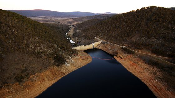

IIRC, Australia's BIG 'pumped storage' scheme is running several years behind schedule.
Covid, Covid, Covid, then TBM nosed into 'very bad ground', the foul fill of of a big, unsuspected sink-hole.
I do not have access to all their full articles, but these give some indication of their woes...
Speaking of sink-holes, I'm reminded that the final upgrade of Scottish A830 to Mallaig was beset by ghastly geology. The survey found that a huge, glacial scour-hole (*) lay across only practicable route through a pinch-point. Full of rot, peat, slime etc etc, it could neither be drained nor simply capped for fear of collapsing flank wall and foul contents into valley and river below. The usual 'braw' companies took one look at it, declined to tender... { = 'Fled, Screaming...' }
Finally, the budget was increased to cover a 'ground level bridge' that would safely span both the sink-hole and its 'dubious' rim...
*) I do not have reference but, IIRC, it was thought to have been generated by a glacial Moulin...
