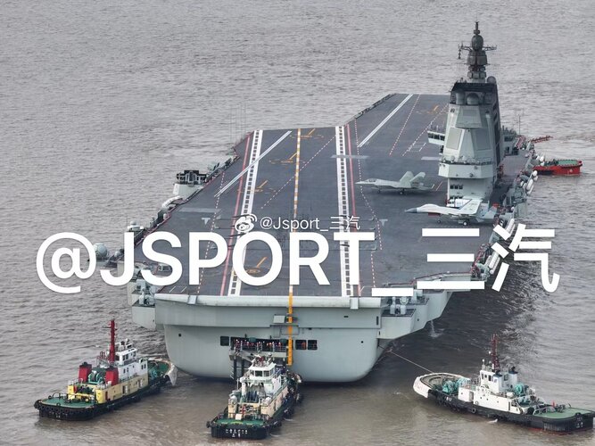

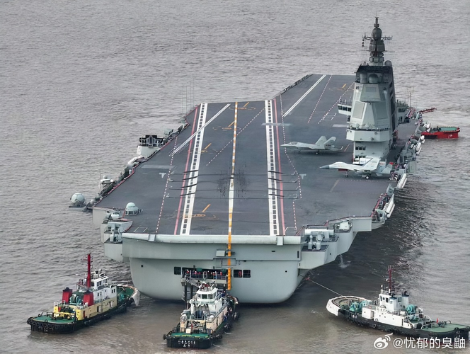

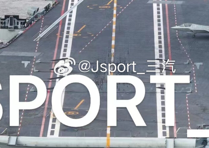

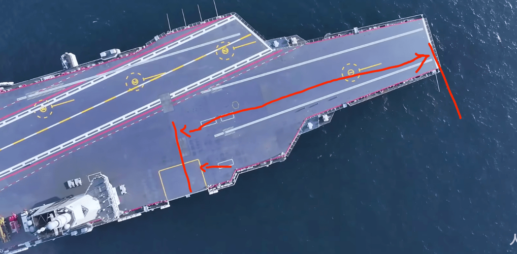

The Fujian has returned from her 6th season trial and now with the first clearer image of the Fujian‘s deck being released I would say this clearly looks like landing - at least touch & go - markings on deck!
(Image via @Jsport_三汽 from Weibo)

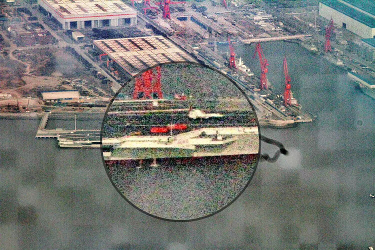

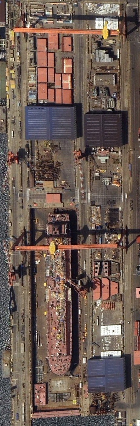

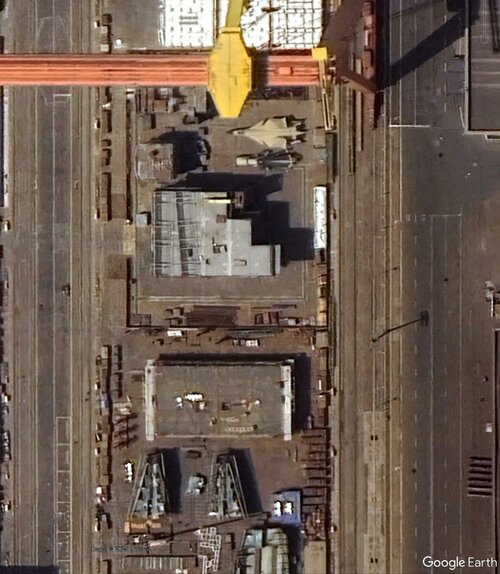

Maybe a first hint, that the 004 aircraft carrier is in preparations or already under construction at Dalian, but given this is already a deck segment I think it is more likely this is just a test module and not yet the actual aircraft carrier:

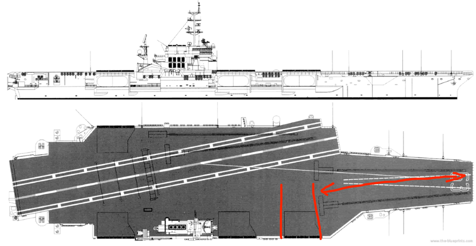

I bet that the next new aircraft carrier is definitely not a CVN, if you observe carefully, there are a lot of irrational designs on the current 003 class aircraft carrier, one of which can prove one thing, this ship was originally intended to be designed as a steam catapult aircraft carrier, you will see that the length of the catapult at the bow is significantly closer to the elevator, if it is a steam catapult, the length is just right, if I remember correctly, this aircraft carrier was even suspended for a year, at that time it was verifying which is more suitable, electromagnetic catapult or steam catapult.
So I have reason to think that the next aircraft carrier will be a sister ship of the Fujian, and not a CVN
