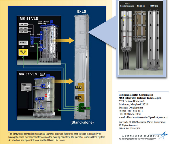

I'm not sure what their sourcing is. If they are relying on the latest infographic, it's clearly old and does not reflect the change from CAMM to RAM. That's where the 6 cells comes from, I believe. There is a 6-cell configuration of the Mk41 Single-Cell Launcher, but it looks quite different from the ExLS shown in the old illustrations. It would be noticable on renders.
