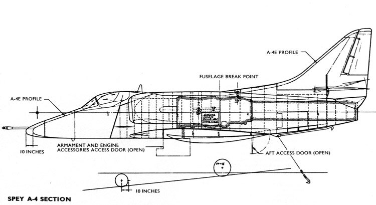

There was a historic Speyed Skyhawk proposal (the J65 of the A-4A/B/C was almost identical in size to the Spey, so all that would have been needed was to use the old fuselage with the improved A-4E wing [among other improvements it had 5 weapons stations instead of 3]).
  • THE SPEY SKYHAWK.doc
That would have been impressive! Mark
Just looking at the proposed Spey powered A-4E, if that had gone ahead it may have been attractive to NZ rather than the J57 powered A-4K & TA-4K that we got in 1972. Also it may have allowed for the installation of twin 30mm cannon which would have been far better than the 20mm we had. The Israelis, Brazilians, and Singaporeans did that later. So a Spey powered A-4E/G/K with twin 30mm cannon would've been a mean beasty, especially the K after they went through Kahu in 1987 - 90.
