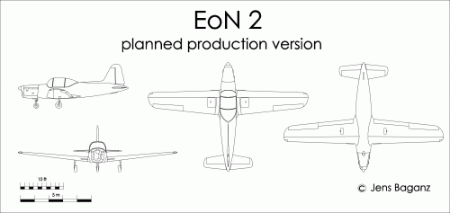

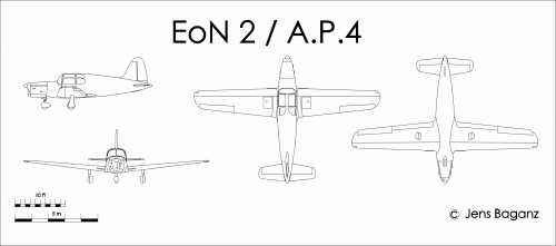

For the Elliotts (EoN) entry, I think it was the EoN 2, AFAIK the only trip of this
company, much better known for their sailplanes, into the world of powered
aircraft. It was described some years ago in an issue of "Wingspan". One
prototype flew for several years, I think, but the production version, with
cut-down fuselage and "bubble canopy" never left the drawing board, IIRC.
Will look for this magazine tomorrow, it's on the attic, and it's too cold now !

Hi Fabulousfour,
the aircraft was built as EoN 1,one only,and after that redesigned as
EoN 2,with new engine,De Havilland Gipsy Major of 145 hp and
lengthened nose-wheel leg,so may be it was EoN 2.

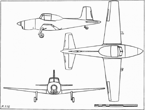

here is the Boulton Paul P.116 Project.

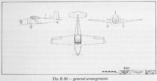

here is the Blackburn B-80 proposal.

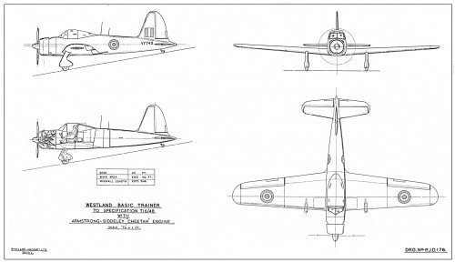

Westland's project

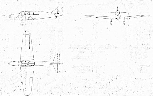

This, from 'British Sailplanes and Gliders', N.H.Ellison, 1970, page 116:-
"A two-seat side-by-side seating training aircraft, designed by Elliotts of Newbury and Aviation & Engineering Products Ltd., to the above specification in competition to the Percival P56, Handley Page H.P.R. 2 and the Auster A.9
projects. All metal light alloy stressed skin construction.
Wing span: 12.34 m., 40' 6". Length: 9'25m., 30’ 4”.
Wing area: 22.3 sq.m., 240 sq.ft. Aspect ratio: 6.83."
cheers,
Robin.

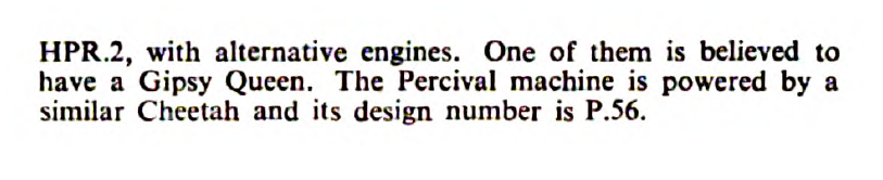

From Air Pictorial 1949,
they talked about Handley Page HPR.1 & 3,as a project variants of HPR.2,
and my question,if they were wrong,OK,but if theywere right,could they
later re-allocated to another designs ?!.
The H.P.R.1 Marathon preceded the H.P.R.2 basic trainer.
