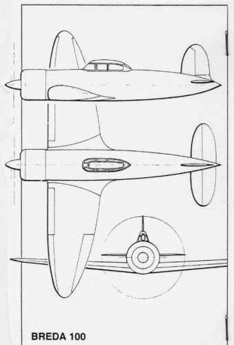

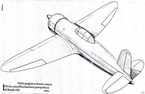

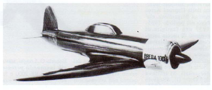

in this thread there is a drawing of three views Breda ba.100
http://www.secretprojects.co.uk/forum/index.php/topic,2559.msg78773.html#msg78773
Ciao Mantus.
