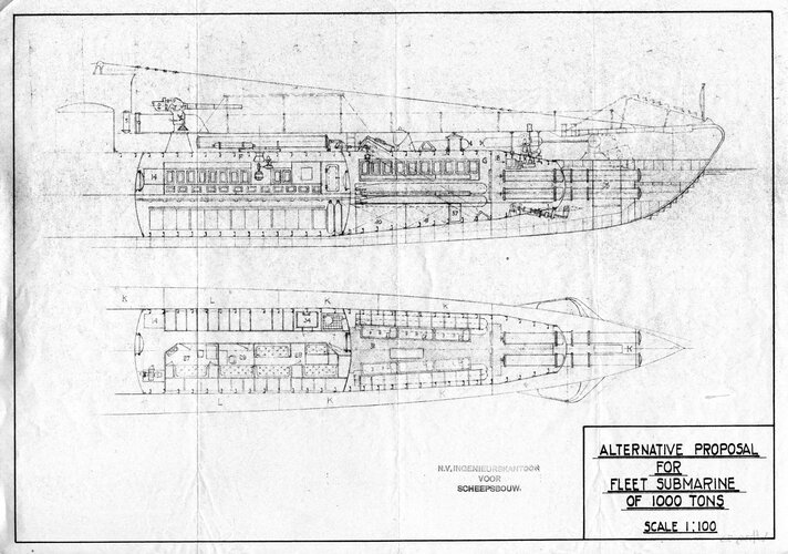

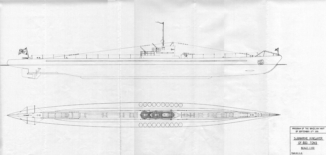

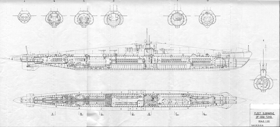

There were plans to built a minelayer submarine from the Brazilian navy around 1934. For instance the Kon.Mij. De Schelde, Vlissingen, Netherlands was interested. I have seen a blueprint and some details year ago. Should be somewhere between my notes
Some drawings of the Brazilian submarine. The Kon. Mij. De Schelde offered her own design. I'm searching in my notes for more details, but can't find them at the moment
  • inkavosbraziliaanseonderzeebootmijnenlegger.pdf
There were plans in the 1930's to buy a mix of attack and minelaying submarines, the number of which I don't recall right now(I think it was 10 and 5 respectively, but might be mistaken). Brazil ended up buying 3 Adua-class submarines in the late 30's, which were named Tupy, Tamoyo and Timbira, names that had been previously used for 3 torpedo cruisers bought in the 1890's.

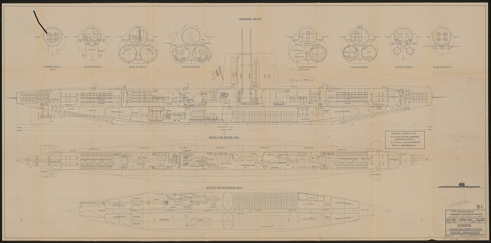

In the archive of the Kon.Mij. De Schelde, Vlissingen, Netherlands are a number of drawings preserved dealing with the famous Dutch 3-cylinder class submarines. In the Netherlands is since the 1930s the design office N.V. Nederlandsche Vereenigde Scheepsbouw Bureaux (Nevesbu) active, originally established by the major Dutch shipyards and which office designed since then warships and merchant ships. Her active is not open for the public. Lucky enough some drawings are available in the first mentioned archive and more important also digitized, The design 2086 dates from 2 September 1952 of a submarine with a standard displacement of 1.000 tons and apparently a proposal fort he Brazilian navy but never realized. The drawing can be downloaded on:
https://hdl.handle.net/21.12113/3C5C082EA5084B4DBAAE04FCCB6A7443
For other designs see this thread: https://www.secretprojects.co.uk/th...s-unbuilt-3-and-4-pressure-hull-designs.1857/

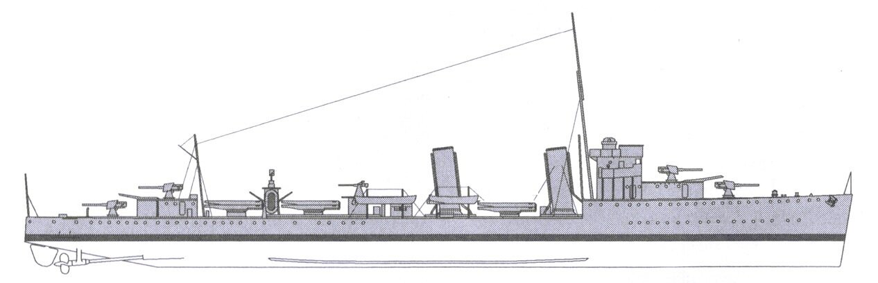

In the Brazilian Naval Program of 1932, the purchase of 9 Destroyers with the following characteristics was determined:
  • 1,600t.
  • 4 tubes of 120mm.
  • 9 torpedo tubes.
My first idea about it: Bra 4x120 9x533.jpg
Details can be found at: "Arquivo Souza Costa, CPDOC-FGV, pasta indexada como SC1934.03.15" in the Brazilian Archives.
I think from this naval programme came the Javary / Havant class destroyers which has quite similar characteristics:
1350/1860tons, 4x1 4,7" guns, 2x4 21" TT
Yes, it is an alternative.
Being the year 1932 I assumed that the Brazilians were based on the Argentine Cervantes and Mendoza classes (and why not Chilean Serrano), all with triple launchers.
Years later, the American option (finally translated into the M class, similar to the Mahan) and the German option (externally manufactured destroyers in a quantity of 3 and local in a quantity of 3) gained strength, with the British option being latent (supposedly enhanced by the Argentine and Chilean boycott of the export of American destroyers in Latin America, especially Brazil)

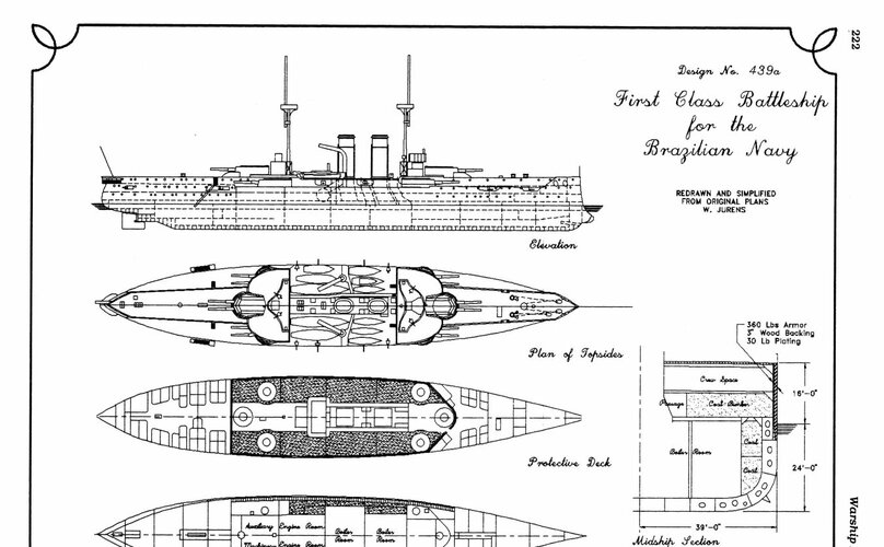

Originally, these plans of 439a were found by myself, in Brazilian navy archives, and was firstly published , after redraw by Jurens, as an addenda letter to the magnificent article written by David Topliss about Brazilian Dreadnoughts.that was published in WARSHIP INTERNATIONAL - I.N.R.O. Number 1994- 03.
