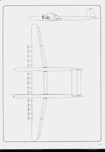

Breguet Br. 851
192 m wingspan and 1.000 tons
How practical would a 15-engine aircraft be? With so many separate components, I'd expect multiple engine failures per flight, just as a matter of statistics. So the remaining engines would have to be powerful enough to maintain altitude with X number of props feathered and the consequent extra dead
weight and drag. Thoughts?

It was to be powered by 120 Hispano-Suiza 12Z motors, placed in fifteen octuple mounts along the wing. A nightmare!

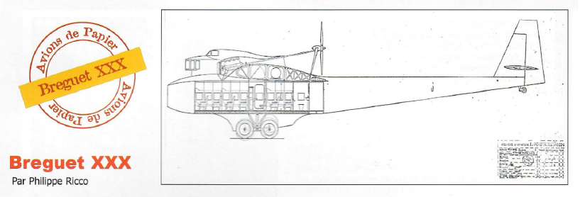

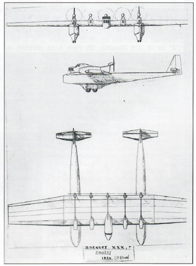

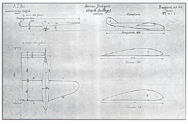

From AFM09 magazine,
the Breguet XXX or Br.30.
Breguet Br. 851
Whaaaaaat ? If that's not a joke, then... THE HORROR.
...for the record, the 12Z never worked properly. Just ONE engine, on ONE ground bench or ONE D-520 modified airframe.
Not only did the 12Z never worked in a ruined 1946 France, but it wasn't working either in 1939 France - it was deeply flawed (like pretty much everything in 1939 France from politics to AdA procurement to the QGQ to the very senile and complacent Generals, but that's another story).
120 * 12Z... better not to think about it. Dope was good, at Breguet !

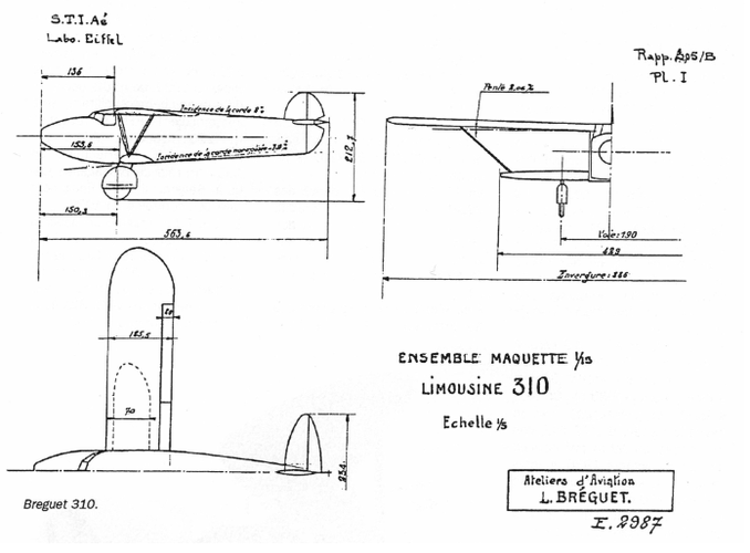

From TU 172,
the Breguet Br.310 Project,a limousine version of Br.270.

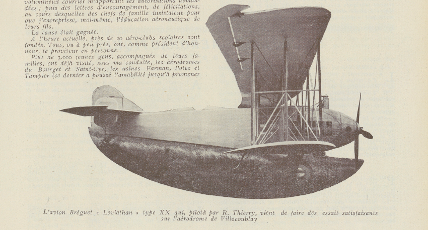

Here is Gaumont Graphic Newsreel footage (posted by British Pathé) of the Breguet XX ( Breguet 20) Leviathan under construction.
YouTube - British Pathe: "New French aerobus" (1920)
