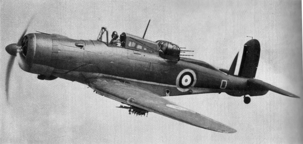

…. The Defiant also had virtually no room for improvement. You certainly couldn't cram a turret with say 4 x .50 machineguns on it, let alone say 2 x 20mm. The wing really wasn't designed or stressed to take a battery of forward firing guns either. Turning it into a single-seat fighter would result in an inferior aircraft.
If anything, the Defiant is the product of bureaucrats that would never have to fly it.
