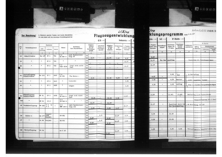

The He 177 and Ju 85 were the two finalists (see attached). The original competitors, presented with the specification at the first Fernbomber (later to become known as 'Bomber A') meeting on June 3, 1936, were Junkers, Hamburger Flugzeugbau (Blohm & Voss), BFW (Messerschmitt), Henschel and EHF (Heinkel).
We know how the He 177 and Ju 85 eventually turned out (although the indications are that both designs looked radically different when first pitched and went through numerous different iterations before their eventual forms were fixed upon) but we don't know for certain what the Henschel and BFW designs were. Henschel is pretty much a complete unknown. It could be argued that the Me 261 was BFW's design but I'm not so sure. I would guess that whatever was pitched for Fernbomber bore only a passing resemblance at best to what became the 261.
That leaves the HFB design. The Blohm & Voss project list makes interesting reading on this point. P 29 seems to have been an airliner project but with some experimentation concerning the use of four engines to drive just two propellers (a key feature of the Fernbomber spec). Nine different variants of P 29 were drawn up before an unnumbered project appears between P 29 and P 30 described as 'Bomber', powered by '2 Doppeltriebwerke 4 Jumo 207'. P 30, P 31 and P 32 are blank, then we get P 33 which is specifically described as 'Fernbomber' with '2 Jumo 206'. So perhaps the HFB 'Bomber A' design was the unnumbered design following on from P 29-9 and/or P 33.

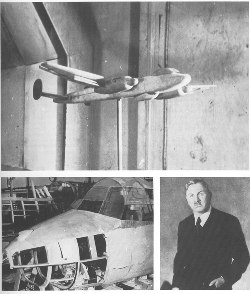

In an earlier post on this topic, I referenced the document that Dan has posted above, identifying the Ju 85 as a "Bomber A". There are a number of Ju 85 cockpit mockup photos on the NASM microfilms and these were apparently made from the originals when they were at Wright Field and those should now be in Germany (There was one lone Leitz Binder from JFM leftover at Wright-Patterson that I saw many years ago, the rest may be at BAMA?). BUT, I have never seen what appears to be drawings of JFM origin for the Ju 85. Perhaps Dan has had better success. Thus, my feeling is we really have little knowledge of how the "Bomber A" version might have been configured as there were versions of the design that differed in many respects. If the information still exists, it is probably not in the US archives,. For an aircraft to have had an "8" Nummer assigned, there surely would have been a considerable amount of documentation prepared, including correspondence, calculations, drawings and a Baubeschreibung. There is a good chance these would have survived the war as I do not believe the JFM archives were affected by bombing and a large amount of the material came to the USA. However, my guess is only a fraction of that material was cataloged and microfilmed, based on many years of working with those indexes and films. I have a little evidence that most of that is at BAMA. The other distinct possibility is much of the JFM documentation still remained at Dessau when that area was given over to the USSR and the fate of that is problematical. There was a JFM memory group active a while back, perhaps knowlege of this subject was known to some of it's members.

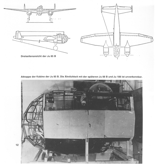

There appears to be no firm basis for the idea that the Ju 88 and Ju 85 were largely the same aircraft. However, we really have too little evidence to be certain. We can be reasonably sure that something called the Ju 85 was a contender for Bomber A against the He 177. And as Artie Bob says, photos exist showing several different He 177-like heavily glazed crew cabins for the 85 (I have all these photos btw).
But perhaps there was an earlier Ju 85 which was simply a variant of the Ju 88? Projects were usually numbered sequentially, so you would expect the Ju 85 to have been designed earlier than the 86, 87 and 88, rather than after them all. It is at least possible that the Ju 85 was a form of Ju 88 which, when abandoned, gave its number to the new Bomber A design. Junkers did move the number of the original Ju 287 ground-attack aircraft from 1943 on to the jet bomber of 1944.

From, [Motorbuch Verlag] Die Ju 88 und ihre Folgemuster,
Junkers Ju-85A & Ju-85B.
