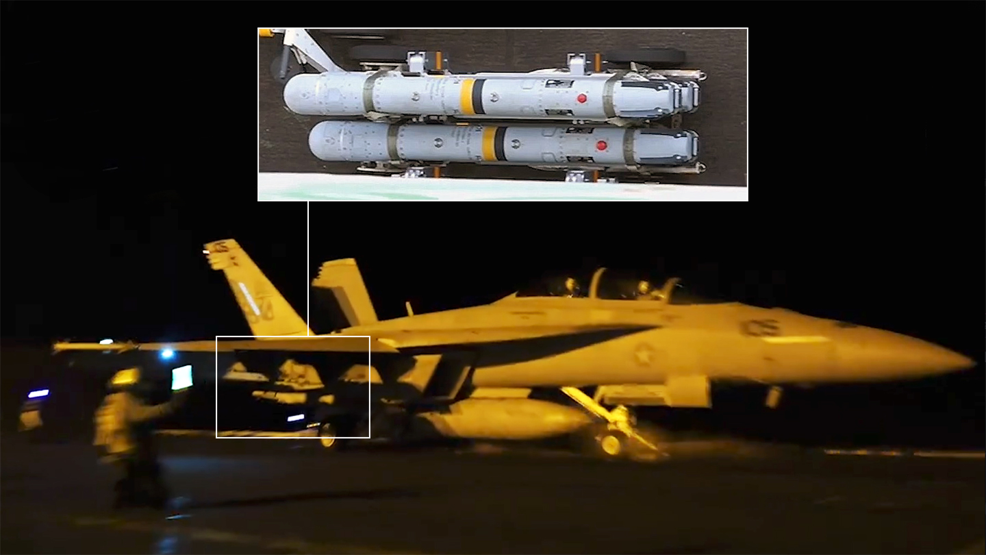

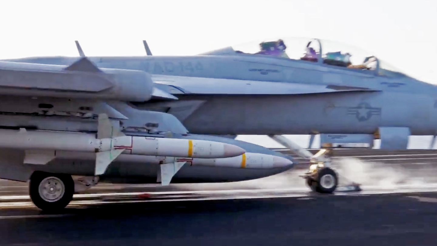

Huh. Usually you'd expect to see a pair of ARMs or JSOWs, not a quartet.
SEAD mission, not DECM escort with the capability to knock off 1 radar site if needed.
Back in Desert Storm there were strike missions flown with A-6Es and with EA-6B escort jamming - some of the A-6Es carried a HARM in addition to their main ordnance load, while there was also an A-6E or two carrying 4 HARMs.
The all-HARM A-6Es were tasked solely with radar site destruction, while the "bomber" A-6Es used their HARMs on SAM radars near their strike target.
See Angles of Attack: An A-6 Intruder Pilot's War by Peter Hunt for the above actions.
He was piloting one of the strike A-6Es that carried a HARM "for self-defense" - because in the pre-strike briefing he had noticed a SA-2 site near his planned flight path to his target that had not been allocated to one of the SEAD aircraft. He requested, and received, permission to adjust his ordnance to accommodate the missile.
When the SA-2 site launched missiles then "went active" to guide them, he fired the first HARM ever launched from an A-6E in combat - the radar went dead, and never came back on the entire air campaign. ;)
Which then suggests that a (currently-hypothetical) EW CCA needs space for 4x AARGM-ERs internally for SEAD/DEAD missions. Which makes for a very large airframe, basically the same size as FAXX itself. And that's not likely to be very attritable due to cost. Definitely not attritable if the CCA has the jammers built in.
