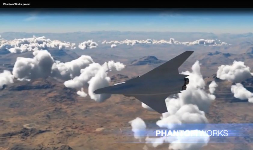

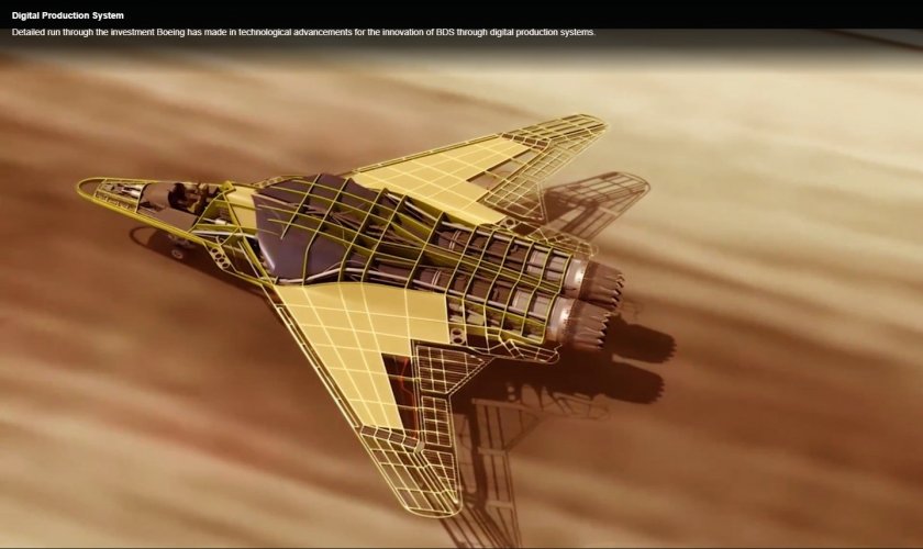

Imho, the 'Voodoo II" demonstrator is the one in the pics attached below (screenshots from a Boeing Phantom Works promo video, iirc similar screenshots and/or the video itself have also been posted by others many moons ago in the old NGAD-thread).
'Voodoo II' name chosen because of the wing being similar in shape to the F-101 'Voodoo'.
I know, that would mean (at least one) NGAD demonstrator has been 'hiding in plain sight'.
The GCAP/Tempest design used a similar wing shape and then switched to a huge delta rather recently.
