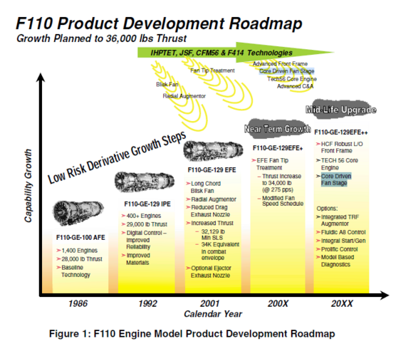

F/A-XX will be using an F110 derivative with variable-cycle features.
The AETP/NGAP 3-stream idea was eliminated a while ago -- cost was reason #2. Can't say what #1 is.
Why not a F-135/B-21 engine variant?

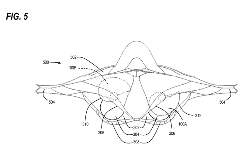

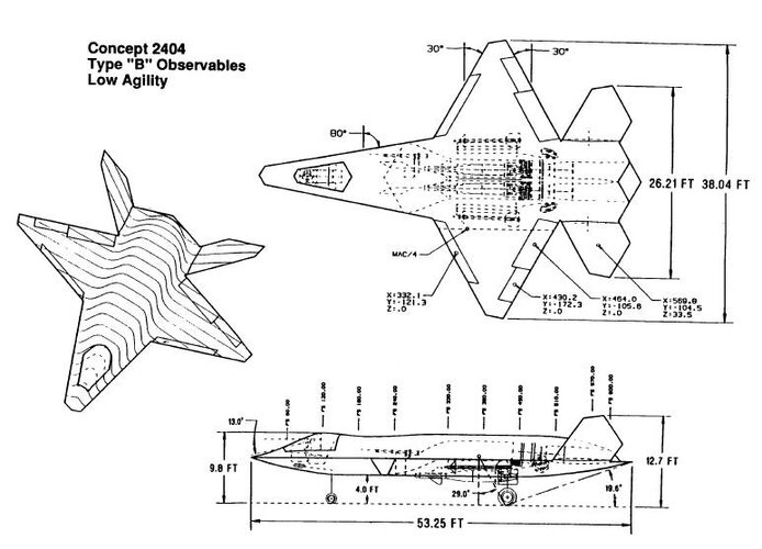

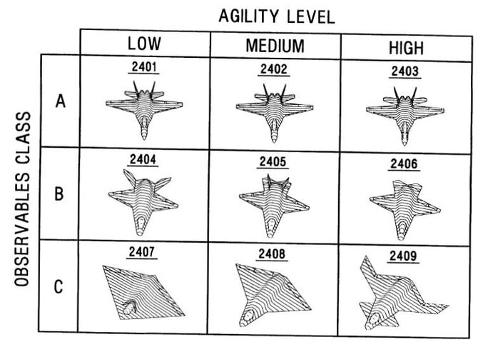

I won't be surprised if this is what the intakes look like, but furthermore, the design characteristics are cognizant of these from earlier studies

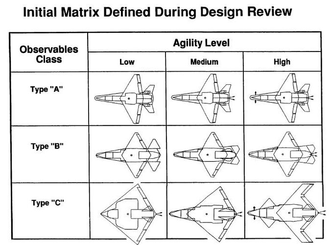

However, the variable cycle version of the F110 engine is also a new engine, and the YF120 and F136 are certainly important sources of technology. Because ccording to the article "F110-GE-129 EFE – ENHANCED POWER THROUGH LOW RISK DERIVATIVE TECHNOLOGY", the F110-GE-129EFE++ will have a core driven fan stage, and the core driven fan stage is one of the unique structures of the YF120.
Inappropriate size and/or power.
ETA: the PW9000 or whatever it is must be too physically large with too much bypass for a military fighter, let alone supercruise, and F135 is too heavy for anything wearing two engines and a 80,000 lb MTOW.
So why not consider the existing variable cycle engine, such as YF120, F136?
Don't know.
My guess is, beginning in the 2014 timeframe, GE (along with P&W, and maybe Allison/Rolls?) routinely provided various engine options to inform the Navy's initial analysis-of-alternatives (AoA) and other early studies. The GE options would have likely included everything from clean-sheet designs based on AETP and ADVENT activities, to resurrected versions of the YF120 and F136, to technologically refreshed versions of the F110 and F414. The Navy would have considered engine size compatiblity as well as other key technical characteristics as compared to top-down operational requirements derived for the air platform.
Also see: https://www.secretprojects.co.uk/th...-asfs-news-analysis.3536/page-235#post-750274
In my personal opinion, Pratt&Whitney's poor performance in TF30-P-412/414 and F401-PW-400 has left a very negative impression on the Navy. Secondly, variable cycle engines have better fuel efficiency than traditional engines, which is beneficial for extending the range. GE has more experience in variable cycle technology than Pratt&Whitney.
One thing I find most interesting is that F-47 does not seem to be the battlestar that sacrifices agility for range which some of us (including me) were expecting…this seems like a more fighter sized aircraft with potentially a high degree of maneuverability. Ironically “J-36” seems much more like I envisioned NGAD, outside the triple engine arrangement.
Either NGAD range or payload requirements must be a lot lower than I anticipated, or a combination of both. I’m leaning towards payload being 6-8 AIM-120 sized weapons rather than any oversized weapon carriage, which probably changes the fuel fraction a lot. But it is still hard to imagine much more than a thousand mile combat radius.

I think they are, it shows the engine face.
Honestly, even with that carrot/cone "gizmo" deployed you can still a slight portion of the bottom of the engine blades with that gap. I'm not opposed to straight intakes as long as they produce the desired results, but this is really strange. No signs of an IRST or EOTS, but canards, straight intakes, & if the underside is like this, below, I mean, do these guys know what they're doing?
I'm certain all of this was accounted for ahead of time, only time will tell as details come out
