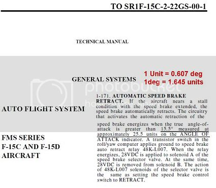

Prior to each (D)ACBT engagement or intercept. In addition, a check for proper operation of all
transfer tanks (wing tanks/CFTs balanced and tank 1 feeding) will be performed prior to and between
engagements or planned maneuvering above 30 units AOA.
Google "F-15 + AoA + Limit"
If that's the only thing - that might've been misunderstanding. "Unit" is not degree, it's measure on AoA indicator, smaller than actual degree quite substantially.
So yeah, F-15 being capable of 35 degrees AoA is... Let's stay a hefty overstatement. Same goes to it being easily better than all mentioned platforms.

And this is the case with instantaneous AoA in which plane crashed?.. How is that an indicator of useful performance?
If the plane hasn't stalled at 39deg of attack, it's a useful performance (note the mentioned attitude of 65 nose up). Stall is angle of attack dependent (not speed, nor attitude) ;)

It's clearly not a sustainable performance, the fact is he did stall upon reaching that AoA, and it's not an instantaneous process, so the stall may well have become inevitable at a significantly lower AoA. If you're actively pitching up the nose as the stall initiates the nose drop first has to overcome the increase in AoA before it actually starts to drop, which probably puts you deeper into the stall before you realise what's happening. KIAS is interesting, he was very low energy to try that sort of extreme pitch-up - makes me wonder if he was trying to match the F-22 in low speed manoeuvring and forgot it has thrust vectoring and an F-15 doesn't.
It says that he used a full rudder while on negative alpha while being slow, so it looks like he set the airplane for an inverted spin. There are videos of f-15Es pulling high alpha but it is mostly instantaneous, not sustained, apparently, the f-15 starts to lose stability if you keep pulling alpha so it is not like a hornet. The new EX might have a flight control system that makes the airplane carefree and helps prevent stuff like the accident mentioned above while extracting more performance of the aircraft. I don't think it is wrong to purchase them, the Russians have su-35s, Chinese have the flanker clones. I think that the EX might end up having a better radar than stealth aircraft and could act as a missile platform.
