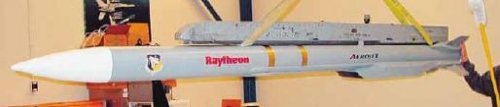

AIM-152 AAAM was cancelled in 1992.
Image of the Hughes-Raytheon design.
http://www.designation-systems.net/dusrm/m-152.html
Raytheon could dust off FRAAM (Future Medium Range Air to Air Missile), a modified ramjet powered version of the Hughes (now Raytheon) AIM-120 AMRAAM.
True, but that GD/Westinghouse design was even more compact. With a lofting trajectory, and multiple pulse motors I wouldn't be surprised if it out could out distance Meteor.
The GD version was the version I thought would hold the most promise.
Put a 1/2 sized booster on the 1st stage and 2-3 could fit in the place of each F-22 Sidewinder and 6-8 full size ones could fit in each F-22 internal bay.
UAVs, IFR, & ISR assets could carry carry just the 1st stage as a self-defense measure.
