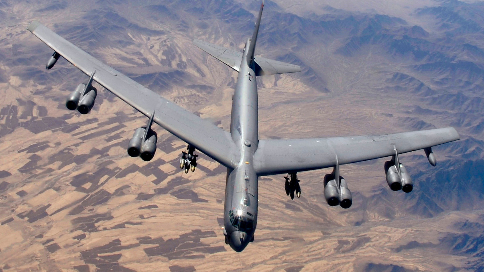

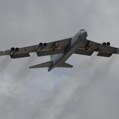

Right. I heard that story too. But the DSB reviewed the USAF study and found that they had done the assessment based on commercial gas prices. Tanker gas costs a little more...LO,Re. the discussion as to whether the eight-engine solution was or was not chosen because of the engine-out case - I believe that it certainly was a factor. But a lot of people overlook another issue: there are three candidate engines for an eight-engine layout, but since the last time re-engining was studied, the two engines that would work for a four-engine B-52 (RB211-535 and PW2000) have ceased production.
Back in 2005 we discussed this often amongst the crew dogs. The original proposal was for 4 RB211-535's, engine out had them looking at other options like CFM-56's on the outboard pods, but two engine types on the same airframe doesn't help the cost argument. Ultimately, the final nail in the coffin for the 4 engine proposals was low oil prices in the late 90's early 2000's and all of the spare TF-33's taken from C-141's and KC-135E's. They could mod the tail and rudder to address the engine out, but that also cut against the cost savings argument. Your points for today's proposal are spot on, the other thing I suspect is they've finally worked their way through the inventory of C-141/KC-135E spares.

Right, tanker gas is just a multiple of commercial gas, I've sat on both ends of the boom. Big reductions, of the need of commercial gas greatly reduce the need for tanker gas as well and the multiple works in your favor. Also, when tanker gas is a must, cost is less of a concern, in other words, if the mission is that important, cost is a secondary concern.Right. I heard that story too. But the DSB reviewed the USAF study and found that they had done the assessment based on commercial gas prices. Tanker gas costs a little more...LO,Re. the discussion as to whether the eight-engine solution was or was not chosen because of the engine-out case - I believe that it certainly was a factor. But a lot of people overlook another issue: there are three candidate engines for an eight-engine layout, but since the last time re-engining was studied, the two engines that would work for a four-engine B-52 (RB211-535 and PW2000) have ceased production.

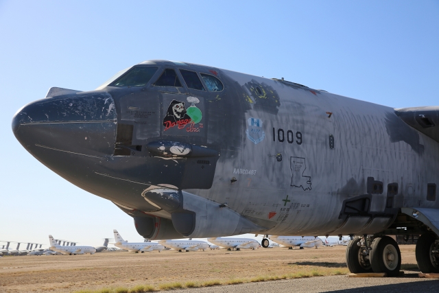

Air Force Life Cycle Management Center’s Bombers Directorate stated that this is a great initiative to repurpose a retired B-52H into a tool to advance the fleet’s modernisation and sustainment efforts for decades to come. Upon arrival in Oklahoma City, the left wing and fuselage will be reattached and used to test how new technology or modifications will integrate with B-52 aircraft.
The integration model or mock-up will support a number of current and future modification initiatives, to include the Commercial Engine Replacement Programme and Radar Modernisation Programme. Also, as new weapons are developed and come on hand, the B-52H integration model will show how the weapons attach, what needs to change, and if they fit on the aircraft. This is an asset that will help integrate different items and weapons onto USAF's Stratofortresses quicker.

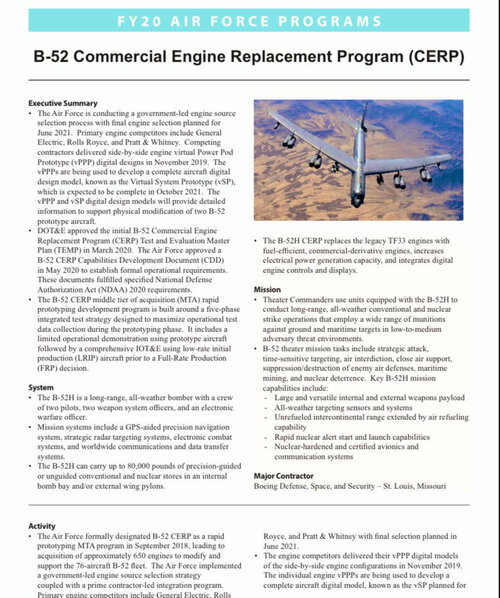

B-52 Engine Replacement Could Keep Bomber Flying Through Its 100th Birthday
Other improvements have the Air Force contemplating smaller air crews.www.defenseone.com

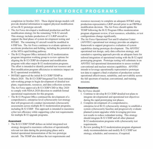

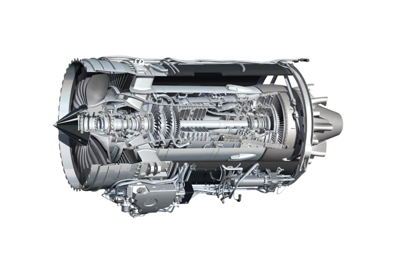

One unstated benefit of the PW800 is that it’s in the “sweet spot of its life cycle,” Moeller said. The Air Force will want an engine that is sustained by commercial market volume today and decades into the future. The Service doesn’t want an engine that is nearing its commercial sunset and is unsustainable in the future because the commercial market disappeared. The “sweet spot” is that period when a product is in its growth phase with an active commercial market for decades to come. This ensures spare parts availability with a pool of experienced maintainers working with a global sustainment support structure for the life of the program.
The PW800 will stay on wing for decades longer than the RFP requires, Johnson said, and will meet or exceed every capability requirement. While the engine is almost the same dimensional size as the legacy TF33, the combined weight savings over eight engines is 5,000 pounds. That means less wing stress, improved fuel efficiency, and increased capacity for under-wing payloads.
No other option delivers so much weight savings, Johnson said. “The nearest competitor is over 3,000 pounds heavier than the PW800 [for all eight engines],” Johnson said. The other competitors are as much as 6,000 pounds heavier.
Rolls Royce have won the B-52 re-engining contract with their F130 (a derivative of the BR725).
View: https://twitter.com/TheDEWLine/status/1441512556041019393?ref_src=twsrc%5Egoogle%7Ctwcamp%5Eserp%7Ctwgr%5Etweet
So the BUFF will keep its familiar 8*turbofan layout, except with a modern engine in massive service across airliner fleets.
I wonder what range / payload will be.
Makes a lot of sense.
...except that 75*8 is 600, not 608 - that would be 76 airframes.
But I suppose the eight engines are *spares*

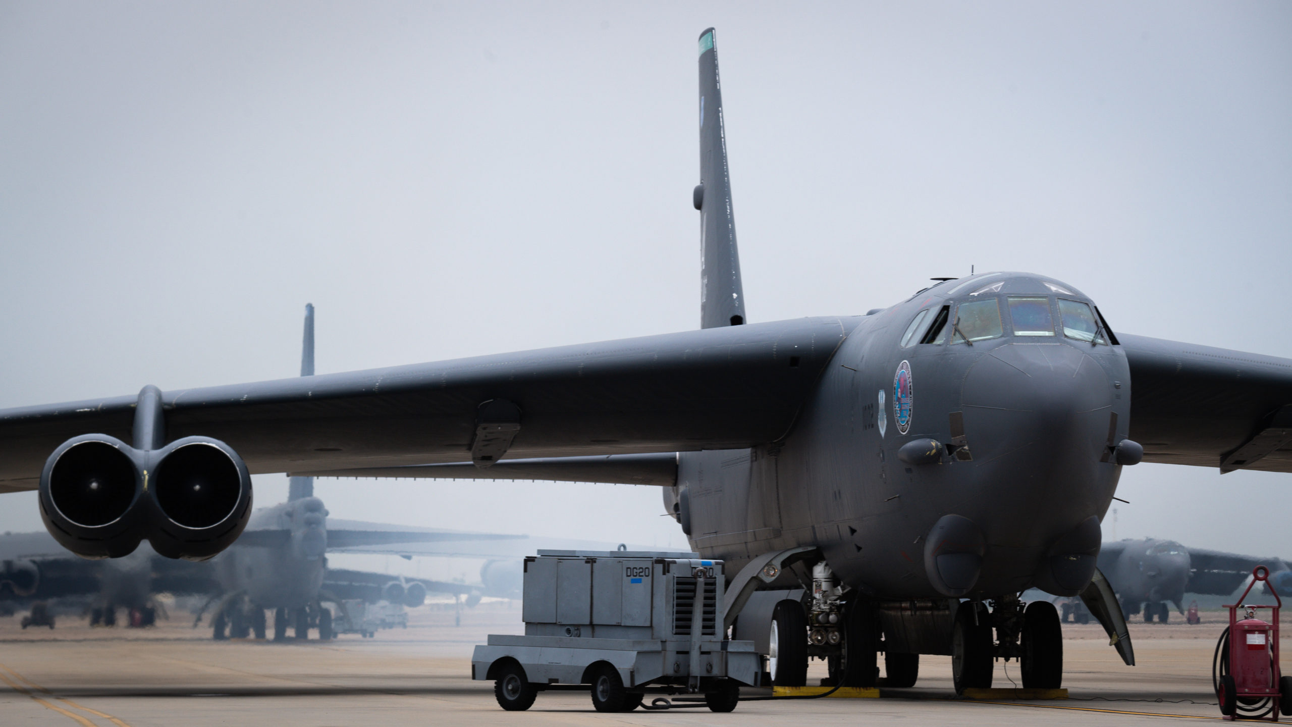

Boeing, the original builder of the B-52, will integrate the engines, radar, and other new systems onto the bomber but did not play a role in selecting the winner of the CERP competition. A Boeing official said the company provided data to the Air Force on the relative ease or difficulty of integrating each of the competing powerplants but did not make a recommendation on which one should be selected. Boeing will decide whether and how to mount the engines in twin-engine pods or nacelles, as the TF33s are now arranged, and will do the necessary aerodynamic calculations as to the placement of the engines for optimum performance and least interference with the aerodynamic structure. A Boeing official said the B-52’s disused nose-mounted infrared pods will likely be removed to improve airflow at the front of the bomber.
Looking forward to seeing a "clean shaven" B-52 again; I've been wondering on those sensor's relevancy...Interesting aspect discussed at the end of this report:
Not much really. since very few BUFF's fly low level anymore. The Nav's will miss it since I don't think can use the T-pod in the pattern. The upside of the clean nose is that the max Mach may return to .92.Looking forward to seeing a "clean shaven" B-52 again; I've been wondering on those sensor's relevancy...
So, will it be singles or twins on H's engine pylons ?? Or both, so twin inners and single outers ?
