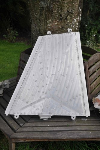

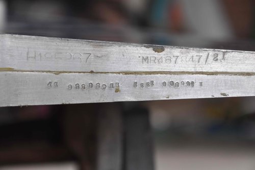

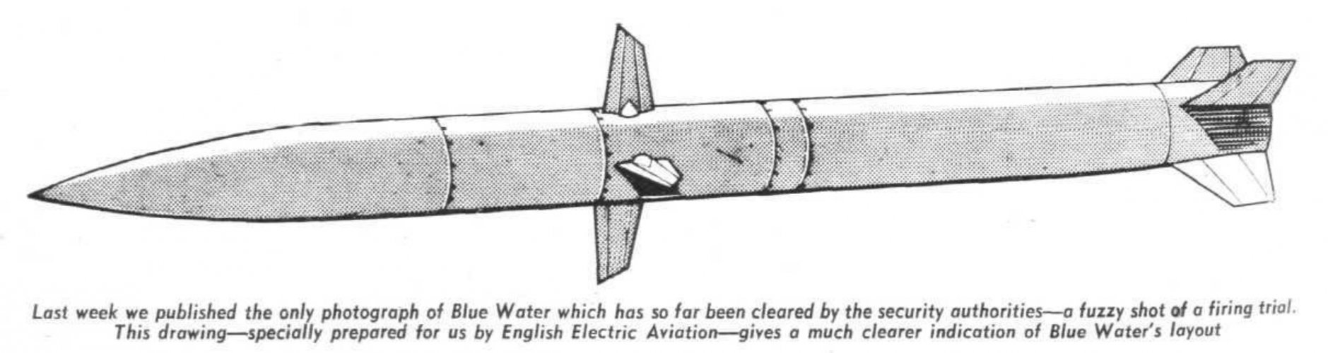

I don't know if this is of interest but there were questions as to whether any Blue Water missiles survived and dimensions. I bought this unfinished tail fin ten years ago and got around to cleaning it yesterday when I found several part numbers and an English Electric Guided Weapons inspectors stamp.
It still has four milling holders attached as well as milling lines. it is a two part fin that is riveted together.
Looking at the EE weapons it would appear to be a Blue Water tail fin. From one of the earlier links I pulled a close up of the tail fin. it is the same shape, angles and construction as the one in the link.
So I assume it was unfinished when the project was cancelled and left lying around for 50 years.
It is 76 cm tall and 76 cm wide at the base so ca. 36 inches/2.5 feet.
Of course it could be from another EE development project but square joining attachment is similar to the Blue Water as is the angle matching tail cone.

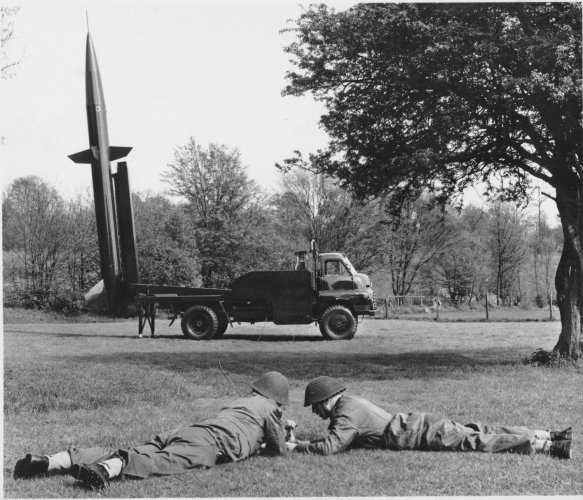

Does anyone have information on the "Blue Water" tactical nuclear missile that was developed for the British Army in the 60's?
IIRC it was an English Electric design.
Starviking
I was in the 27th regiment royal artillery in the 1960s the regiment had corporal missiles
We ( 27th regiment) were filmed " operating " the missile
