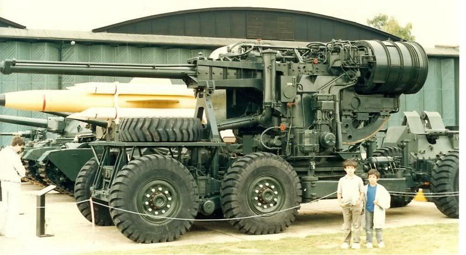

Hello all. I don’t know for sure, but maybe the car behind Green Mace is one of the variants for a mobile Bloodhound. Does anyone know something about that? I see that Centurion chassis was used there
Bit of perspective bother there.
It's a Thunderbird parked alongside a Centurion which are parked alongside the Green Mace. Not sure what's beyond that.
This photo must have been taken at Duxford many years ago. Interesting picture all the same. Thanks for posting it.

Hmm... Maybe you are right. I have another picture. There is British artillery on Centurion chassis, but also we have strange machine with rocket on the left. What it could be?

Looks like a Cent, an Action X turret Cent and a Saladin.
