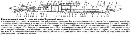

Russian project of underwater cruiser - 1915-1916, 2800/? ton, lenght 113 m, beam 10.6 m, descending turret with two 120 mm gun, and one 75 mm AA gun, 14 533 mm torpedo tubes (for new Russian torpedoes), + mines, full speed - more 20 knots.
Also, projected other submarine, 1998/2725 ton, two 130 mm guns and one 77 mm AA gun (maybe, 75 or 76.2 mm gun), 14 533 mm torpedo tubes.

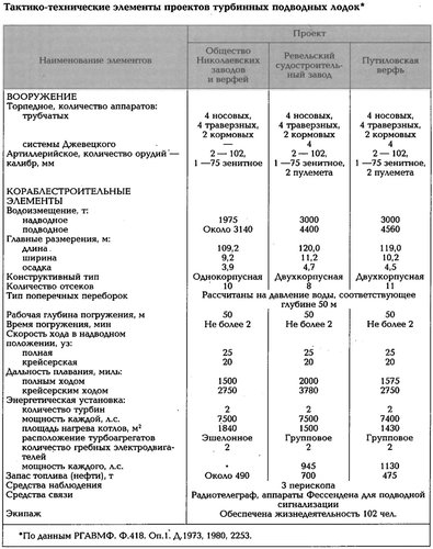

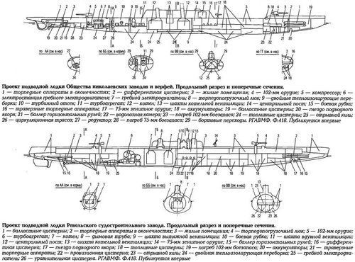

Projects of big submarines with steam turbines, 1917:
All three types - with two 102 mm and one 75 mm guns. Diceplacement - from 1975/3140 to 3000/4560 ton, lenght 109-120 m, full range from 2750 to 3780 miles, depth to 50 metres, full speed to 25 knots.

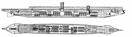

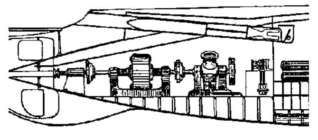

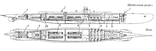

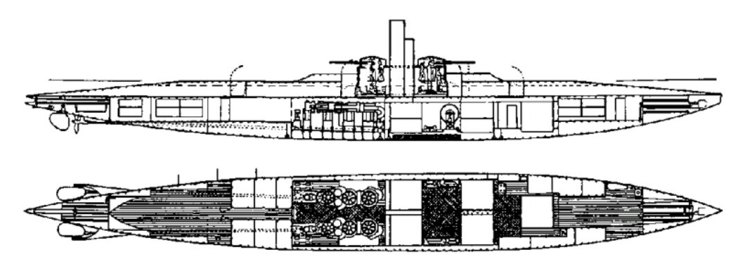

Project of engineer Zhuravlev, 1910-1911, huge underwater cruiser, in 4500/5435 ton. Lenght 128 m, beam 10.4 m, depth - standart 116 m, extreme 174 m. Weapons - five 120 mm guns in descending turrets, 1000 rounds, 30 450 mm torpedo tubes, 60 torpedoes, 120 mines. 153 crews. Armour - belt 51 mm, deck 37 mm, walls of descending deckhouse 102 mm, roof 51 mm. Speed 25/14 knots. Two variants of engines:
Type A, steam turbines, range - 15 500 miles with 11 knots or 730 miles with 25 knots, underwater range - 275 miles with 6 knots or 21 miles with 14 knots:

Type B, diesel, range - 18 500 miles with 11 knots or 2350 miles with 25 knots, underwater range - analogical of Type A, but, possible increase of batteries on 13%, to 310.75 miles with 6 knots or 23.73 miles with 14 knots:

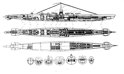

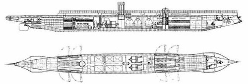

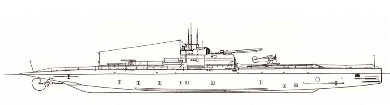

Soviet underwater cruiser, 1921, 4570/6700(or 7300) ton, 10 torpedo tubes, five 130 mm and four 100 mm AA guns, 25/10 knots, full range 25000 miles with 8 knots:
Also, projected cruiser in 5750 ton.

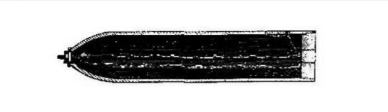

Lodner D. Phillips, 1862 submarine (Confederate states), number 4 is pneumatic cannon:
Lenght 40 ft, diameter 4.5 ft

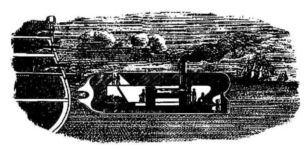

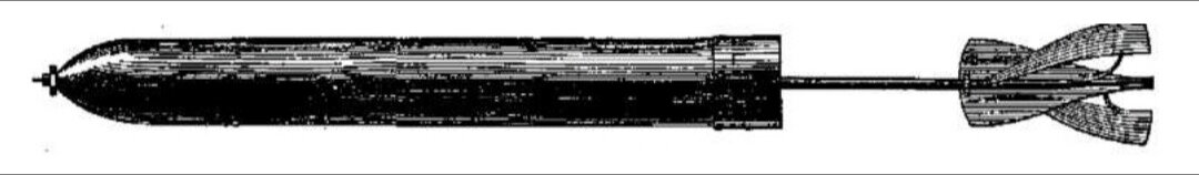

James Nasmyth, "underwater mortar", 1854-1855, point-blank shot large-caliber gun:

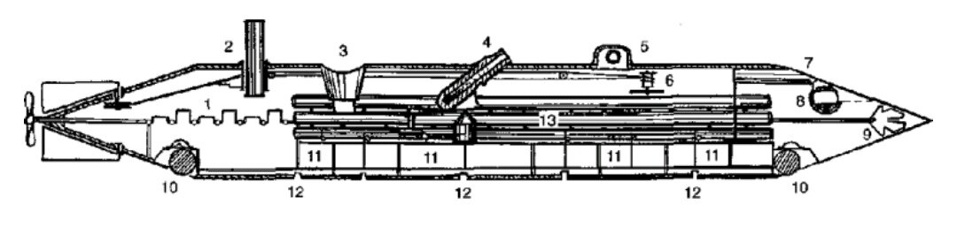

Holland-5, 1888:
Lenght 85 ft, diameter 12 ft, 140/168 t, depth - 25 m, maximum 45 m, 4" armour, 2x625 hp steam machines, + 1x300 hp machine, 2x100 hp electric engines, full speed - 15 knots, "positional" speed - 14 knots, two Zalinsky guns, two small-caliber guns, Whitehead torpedoes

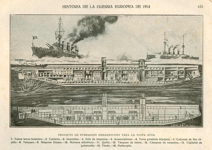

I found this image in a spanish language collection fascicles what heve the follow title: "Historia de la Guerra Europea de 1914" from Vicente Blasco Ibañez. Edited by Editorial Prometeo, Spain, 1920. I have a few fascicles that I get in a street book seller in 1989. No more information about this big gun imperial russian navy never built submarine.
That's just one step removed from the Great Lakes' whalebacks-- Or USS Monitor !!
It seems to have been a true submarine rather than a semi-submersible design though.
