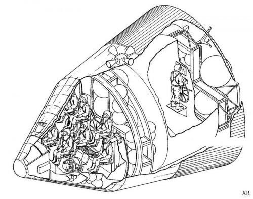

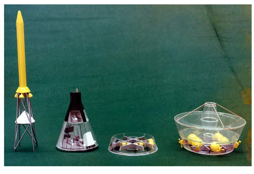

i found this picture on Flickr
sadly the person who uploaded it, not answer my question on Source of this picture
on first look it like Big Apollo capsule
but second look you notice the Gemini Doors and Life-support system of Gemini capsule.
can this be variation on Big G ?

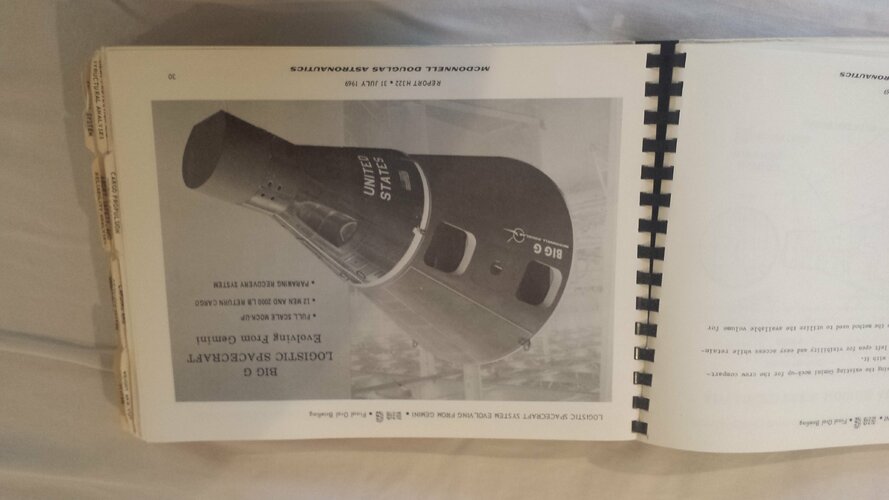

I've posted this to another forum, but the entire multi-volume Big-G contract proposal is in a publicly accessible archive in Houston and it is in very good condition. It would require some work to go there and copy and scan it, but it's a really good, thick document.
Orionblamblam, we need your skills !!! I think a lot of people (including my little self) would be willing to pay for that thing. There is a good business case there.
It'd be strange to go all the way to Houston when I have copies of all volumes sitting on a shelf. the only real problem is, IIRC, that they're marked "Gov't employees and contractors only." If it can be shown to be publicly available somewhere, then that's different...

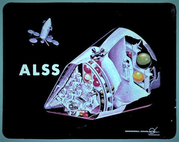

Possibly - the manufacturer is McDonnell Douglas, and McDonnell was the Gemini manufacturer.
