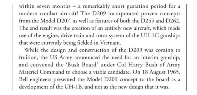

From, US Army AH-1 Cobra Units in Vietnam,
he author speaks about D207 and D209,I think he means Models rather than D series ?.

... author speaks about D207 and D209,I think he means Models rather than D series ?.
But they were, originally, referred to as Models D207 and D209.
Maybe that designation transition was a matter of project maturation? I don't recall the also-mentioned D255 and D262 'Iroquois Warrior' projects ever being referred to simply as 'Model 255' or 'Model 262'.
It's a fact that some "D" designations become plain models, why others don't, and often without apparent logic...
