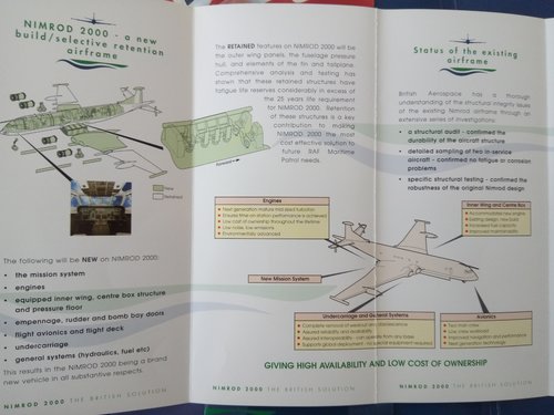

From the library. Undated, but pre-bid (1996).

CJG #109 - FRAL involvement.
FR had long provided oddjob mod. service to MoS/MoA - see Meteor/Sea Vixen drone conversions - and had established some original structural (re-)design competence. Precursors of BAe. had long accepted the Kwik-Fit logic of Heavy Maintenance and short-order mod.-jobs - that no sane User gives dirty carve-up work to the original manufacturer, who will repair by replacement. So Boulton Paul/Seighford, MCE/Cambridge, Shorts all did Canberra oddballs, which would simply clutter and disrupt a new-build production site.
During 1996, as BAe. accepted that Ministers meant what they were saying, that an all-in fixed price was required to defeat new P-7 or retread P-3s, BAe. went voluntarily to FRAL, who were doing good relevant work on Canberra PR9 and since 1992 jointly with SERCO had manned the Kinloss Nimrod Major Servicing line as touch labour sub-contractor to BAe. The contract awarded 12/96 had FRAL on sub-contract for the "overhaul" of incoming MR2 fuselages at a (partial) fixed price.
During 1999 BAe. grasped where the pain was to fall for overrun on the overall Programme £2.2Bn. price (2000 Annual Report Provided for Programme Loss of £300Mn.). Even though taking the FRAL workshare in-house would (presumably) cost more, they chose 11/99 to compensate FRAL for Termination at (BAe.'s) Convenience, with £32Mn. (I think discharged as the new hangar, plus other run-of-the-mill oddjobs, not solely as folding stuff). They preferred to retain the revenue and centralise as one Project (residual GEC-Marconi work too was integrated 30/11/99 as BAES).
